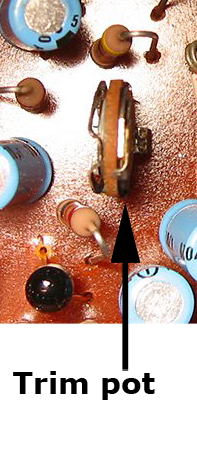

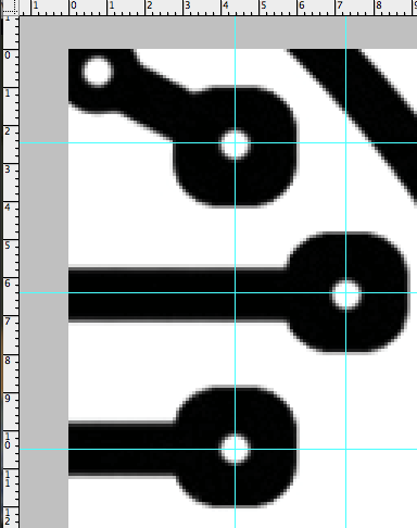

Im Working on covering a scanned image of a pcb to a vector file, but the only component that I can use to scale is a Trimpot.
Right now I'm getting the following measurements
4mm pin spacing, and 3mm deep. (An not knowing the range of trimpot pitches I dont know how right that is)
But due to the nature of this type of scaling up, knowing the published board size is often a few mm different to the actual board size!
So what pitch should I be scaling to?  smiley
I have a few of these type pots and the dimension that you specify as 4mm seems to be more like 4.5mm on mine.

Some designs of these miniature open pots also have flat tab connectors rather than round pins.  The circuit board holes for these are actually small slots.

Looking at the photo I would guess that this is a standard vertical trimmer with a pin spacing of 0.2"x 0.1". Take a look around the RS or Farnell website, there are plenty of datasheets available for these items.
