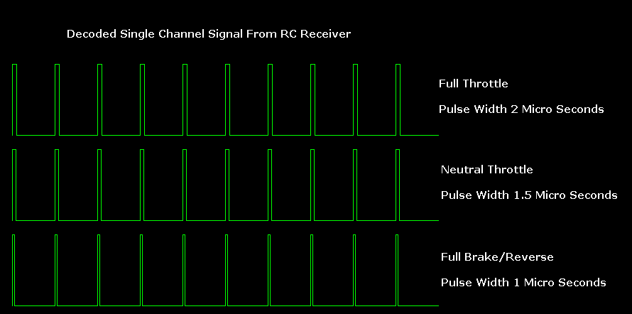

   The servo needs this type of a signal which is easily generated by the servo library -
If you generate this on a pin with an ir transmitter connected, you can send it directly. I am not sure where you see the difficulty ?

As the previous poster has suggested, then detector you are using requires a 38khz signal. there are libraries that will generate this signal, but they are generally intended for sending infra red remote codes for home entertainment systems such as tvs etc. These libraries will not give you a signal for proportional control of a servo.
One quick experiment to try it to use a 555 timer to generate the 38khz signal for the ir emitter and then use the servo library to drive an arduino pin connected to the reset pin of the 555.
This will generate the correct frequency for your detector, but pulsed in the correct way to provide proportional control of a servo.
The 555 and 556 timer chips are great little devices that can be used for all sorts of projects, so if nothing else you will increase your options for future projects by experimenting with the 555 and 556
EDIT: Alternatively you can search for code examples for generating a 38Khz signal directly from an Ardiuno PIN, there are lots. If you find one that does not use timer 1, you can use an AND gate to combine an Arduino generate servo signal with the Arduino generated 38Khz IR signal to get a proportional 38Khz Servo signal out of the AND gate. I will have a go at putting together an example this evening.
