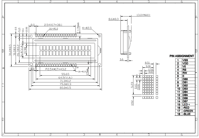

You can get 3 LCDs to run on an uno if you want (its easier on a mega though) if you have some fun with shift registers. There's a LCD from shiftreg library on the arduino playground thats pretty easy to work with, heres the link.
https://bitbucket.org/fmalpartida/new-liquidcrystal/downloads
However that library I've only made work with the sparkfun/adafruit 2x16 character, and 4x20 character displays. Haven't tried anything with any other screens yet.
However after reading the info about the screen it says you need 3-5 output pins to drive it (something about whether or not you want to run the chip select and reset pins) so if you could set it up right you could probably get by with the 3 screens straight into the uno, but you'd be tight on space for other stuff.
