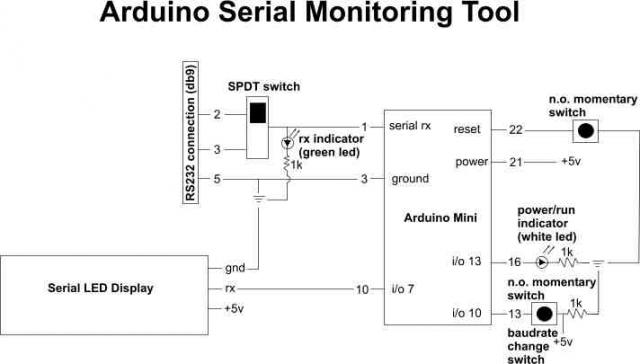

I spent a few hours this morning trying to make a device that would make my real life job easier- a serial port message reporting device.  However, in order to use the SparkFun led display I needed a second serial port.  I had a bunch of really complicated ideas, but then saw the tutorial on software serial communications.  Since all I need to talk to the LED (with a serial backpack) is one 9600 baud tx, I hooked it up, adjusted the defined delay slightly, and it worked like a champ.
Added a switch to cycle through baud rates on the receiving end, and cut out everything above 28800 because it didn't seem to work at all.  I didn't troubleshoot this, as most of the communications I want to listen to are at 9600 baud...  I also block any characters that either don't have an associated graphic on my led or are one of the reserved command bytes and replace them with character 174, which looks like a little E on my led.
here's the code:

Here is the hardware, but don't hook this up directly to a serial port; I'll be revising the drawing after I play with the hardware tomorrow.  The serial connector and circuit are probably going to look a lot like the rs232 connection on the original Arduino schematic...

I was checking that out and thinking about using it, but had already started with Heather's code and it was working fine...
I got to work this morning and found a SparkFun rs232 Shifter in my desk, which made assembly all that much easier!  I also used a basic 7805 circuit to power the device from a 9 volt battery (dropped down to 5 volts and a power switch on the battery).  An hour of soldering and I have my serial monitoring tool.  Works great, all it needs now is some kind of box with mounting so I can throw it in my toolbag.
One funny thing that happened; when I passed the serial wire from the mini to the serial led too close to my 7805 and it's capacitors, the output on the serial led went to all pixels lit; moved that wire away from them and everything went back to normal.  Just something to be wary of if anyone else is making one of these; keep your communication cables away from your power regulator!
