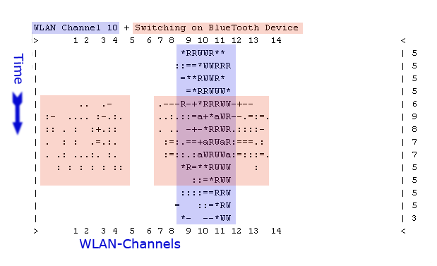

This little weekend project is a 2.4 GHz Scanner which can be used to
display interference signals in WLAN applications. It only requires
an Arduino, a common nRF24L01p-breakout board and software.
RF-activity is piped through the Arduino's serial interface and displayed
in a kind of waterfall display on any terminal application. The amplitude
in the different channels are displayed with the help of a simple
ASCII-greyscale mapping. Here's an example of what can be expected.
The picture shows the output of the scanner, displaying the interference
of a switched on BlueTooth-Device with a Channel-10 WLAN device, on the
Arduino-Terminal (colors were added just for clarity).
The scanner also shows interference from microwave ovens or wireless
surveilance cameras.

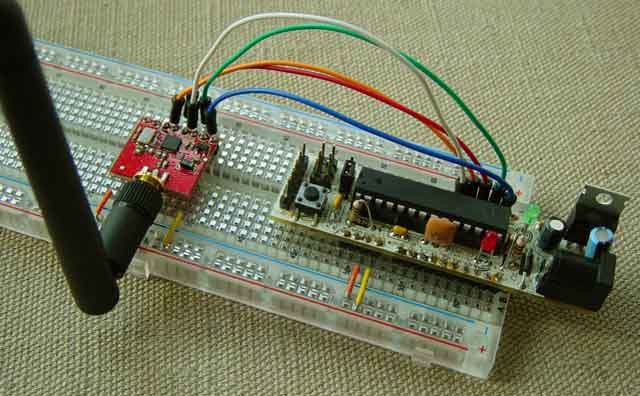

Basically, the setup is very simple. The nRF24L01p is a SPI-device, and you
have to run cables from the Arduino-specific pins to the nRF24L01p-breakout
board. Specifically, the connections are
SS       : Arduino Pin 10   -> Breakout Board CSN
MOSI     : Arduino Pin 11   -> Breakout Board MOSI
MISO     : Arduino Pin 12   -> Breakout Board MISO
SCK      : Arduino Pin 13    -> Breakout Board SCK
Furthermore, do not forget to connect the CE line which is required to drive
the nRF24L01 to RX and also triggers the RF power reading. It is defined in
the program as Arduino Pin 9:
CE       : Arduino Pin 9      -> Breakout Board CE
Here's an image of my actual setup, using a Boarduino instead of an orginal
Arduino.

NICE! Got it working in 5 mins with some jumpers..
Having my Nokia N78 scan for and run on my nearby WiFi network gave me a lot of activity.
With the phone 5 cm from the transceiver antenna I saw lots of wideband low-intensity dots.

This works great.  (wondering the first thing I was going to build with these things.)
I made sure that all WiFi, Bluetooth, and (anything  around 2.4Ghz) was off.
(I only got a few minor blips from some random device.)
Then I turned on the microwave.
On all chanels, I got very heavy interfierence.
So you can also put this as a microwave detector.
Awesome project.[/shadow]
