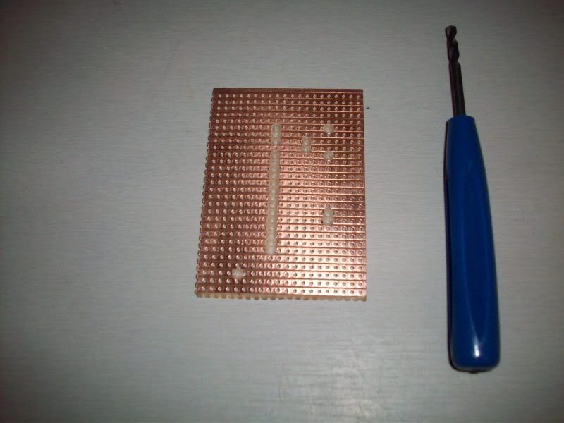

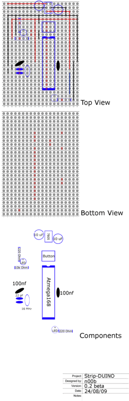

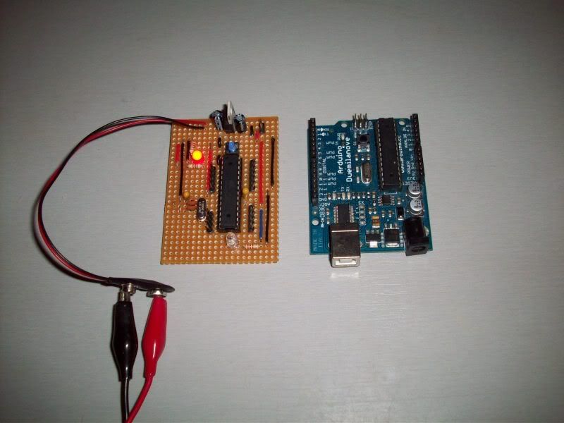

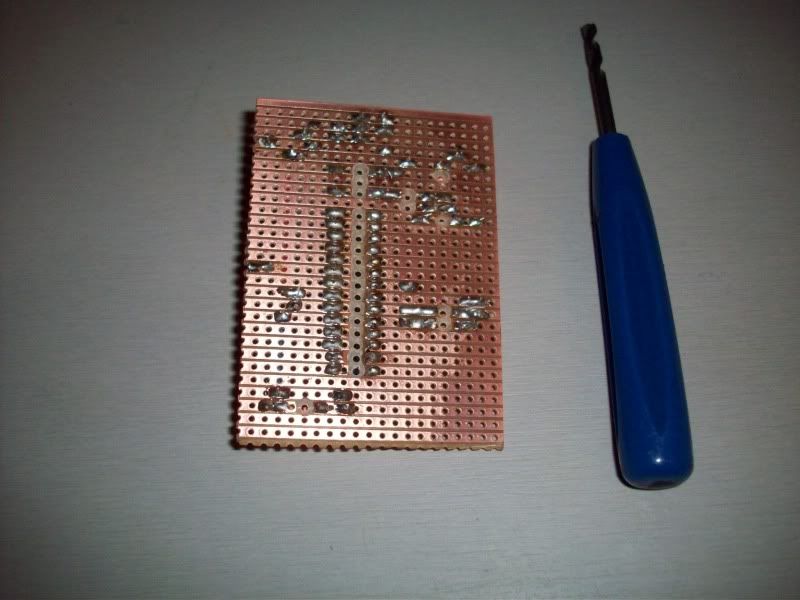

Thought i would submit this ultra low cost, stripped down strip-board Arduino Iv been playing about with tonight.

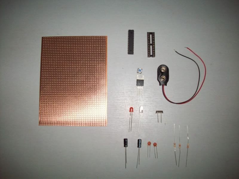

Here are the Part list and plans:
# 7805 Voltage regulator
# 2x LEDs
# 2x 220 Ohm resistors
# 1 10k Ohm resistor
# 2x 10 uF capacitors
# 16 MHz clock crystal
# 2x 22 pF capacitors
# 2x .1 mfd capacitors
# small momentary button
# small amount of wire for jumpers
And a Video of it running "Blink"
http://www.youtube.com/watch?v=GT0a4ed01mE

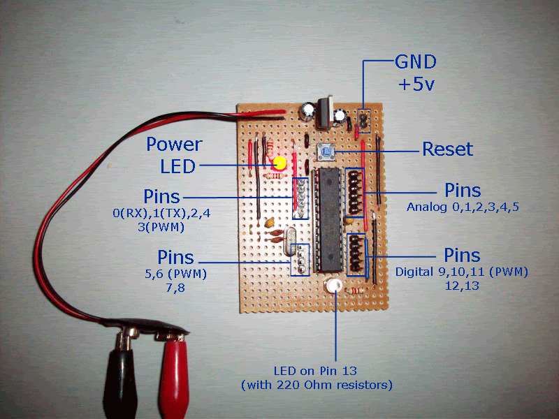

This was only started tonight, so would love to hear how other's would go about improving it, Im just working out a few options for ICSP and cutting up some strips of pins to make it a little more practical then having to solder your I/Os to the board.
If you want to make this make sure you refer to the Arduino Pin Map when hooking up your connections:

Nice job and great pictures.
There is one mistake on that schematic you worked from and an omission. The AREF pin should be left unconnected.
The omissions are lack of .1 mfd bypass capacitors to ground on the AVCC and VCC pins, that gives better noise filtering for the chip.

Thanks Lefty, will disconnect the AREF pin, and add a couple of .1 mfd capacitors to ground on AVCC and VCC  (and update all the photos and schematics) :)
**.1 mfd capacitors added to above schismatics, and AREF pin disconnect **
