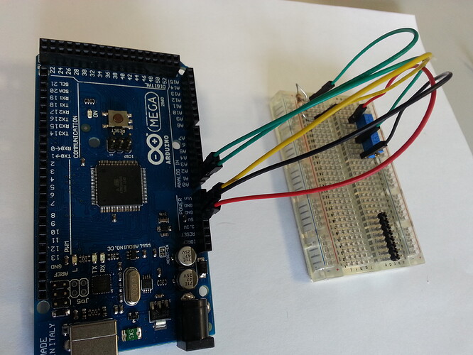

Hi there,
I noticed that, reading the analog ports from the serial monitor the value is very different depending the port (A0 or Ai). If I don't connect anything to the analog ports the A0 stays very stable on 1023, while the others are not so stable are around 850.
(By Mult+/- I understand + or - of a digital multimeter. Ai all other analog ports but A0)
I measured these values:
| Mult+ | | Mult- | | Value |
| 5V pin| | GND pin| | 4.9V |
| A0 pin| | GND pin| | 4.9V |
| Ai pin | | GND pin| | 0.02..0.03V |
After running this code:

Dear marco_c and others.
The circuit is very simple, I really don't think I make something wrong with it. The connections are as suggested in http://arduino.cc/en/Tutorial/AnalogInOutSerial. The difference is that I don't use the LED feedback part. I tested it with a 50k and 200Ohm potentiometer as well (evidently not at 50k, but at the midle). I measured with the multimeter the midle pin's resistance in respect to the outside pins (at the 50k pot the outer was the midle, at hte 200ohm pot the midle was the midle). So everithing is fine. I unpluged everthing and pluged one several times, to be sure that I didn't connect anything in a wrong way.
In the second "experiment" I use the A0 and A1 (with or without the described setup). I connect a 1k res to the A1. The program is:
  // read the input on analog pin 0:
  int sensorValue[10];
  int delayTime = 100;
  sensorValue[0] = analogRead(A0); delay(delayTime);
  sensorValue[1] = analogRead(A1); delay(delayTime);
  // print out the value you read:
  for(int i=0; i<=1; i++){
    Serial.print(sensorValue[i]);
    Serial.print(" ");
  Serial.println();
Serial monitor shows:
1015 0
Than I change the two "cables" between the A0 and Ai. The same program.
1021 863
Why is not equal 1015 to 863 and a 1021 to 0? Why is it enaugh 200Ohm to pull down the A1 and not to A0? Both of the values (1015 and 863) are changing if I change the pot value.
Thanks for reading.

Are you trying to connect anything to the external voltage reference pin on the CPU?
No. You can look at the attached image.
What do you connect the other end of the resistor to, ground or +5V? If ground then ok on A1.
One end of the resistor is connected to GND, and the other at the pin. Everithing is logic regarding the Ai ports, exception is the A0.
Are you writing a 1 to A0 pin while it is in input mode? That's how pullups are enabled on the digital pins.
That is the whole program that I use. Is simple as that. When I received the arduino board, the first day I worked with it at midnight, so I really don't remember what I did. It is really possible that I was writing 1 at A0 as well, but not after that.
That doesn't seem like the problem, since the resistor should have pulled it down anyway.
Yes. I think as well. But it is not happening that at A0.
Unless it's in the rest of your code somewhere, the A0 pin looks like it is not working.
As you can see from my simple code. The A0 should work as A1, but it is not. Because when I change the A1 in put cable with the A0 input cable, they don't give the same result.

@emoke
I have just run that code with the addition of a startup function that just contains a serial begin. The result is that I get exactly the same number on A0 and A1 when I swap over the pot's wiper from A0 to A1. The analogue input not connected shows a floating input. I am using a Uno.
Therefore, if this is not what you are getting, your system then it is either broken in some way or you are not doing what you think.
@Grumpy_Mike
Thanks. And probably all the ports when are in floating "position" are unstable and the neighbours of a pin present similar values. What you presented is the logical, normal way of going (it should be like that). However I hope that is not hardware issue (even if from the first moment it seemed to be), while it is sensitive to resistivity variation, but he tries to remain at high. This is I don't understand why.
There are lots of things in the electronics that could go wrong. At a pure guess I would say it is likely that the FET controlling the connection of the pull up resistor is faulty giving it a pull high. This would not stop an external voltage over riding it but would stop it reading the same as the others because the pulling high and the impedance of the voltage source are acting as a voltage divider to give some what more than the input voltage.
As I say only a guess. Is it better with the 200R pot than the 50K pot?
