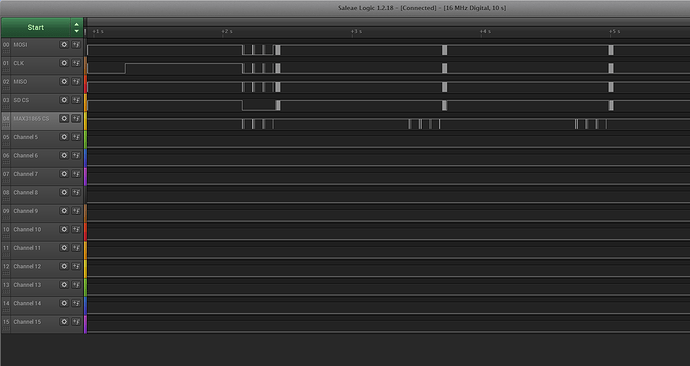

Hello, Im simply trying to get the MAX31865 RTD to digital converter to log temperature to an SD card. However, im struggling to get the SPI connections to work simultaneously. From browsing several other forum posts and other forums there seems to be a common trouble of the SD card taking the SPI line and not giving it back after its used, none of the solutions have worked for me.
So, im wondering how to fix my issue. ive got them both connected to SPI on an Arduino Mega 2560. with my MAX chipselect being 34 and the SD chip select being 38. im using the very basic SD Card holder from spark fun (no circuitry, essentially just the holder), and the sparkfun Logic Level Converter (https://www.sparkfun.com/products/12009).

When i run this code the RTD read correctly for the first pass of the code:
RTD value: 8300
Ratio = 0.25329589
Resistance = 1089.17236328
Temperature = 22.89
22.86
SD online
Recorded
but when it loops back through, the RTD reads out 0 for everything:
RTD value: 0
Ratio = 0.00000000
Resistance = 0.00000000
Temperature = -242.02
-242.02
SD online
Recorded
I tried using a logic analyzer to see what was going on (attached image).Tthe first pass of the code where the RTD is reading correctly is the first set of data and the other code loops are what follows.
Sorry for writing a book but i wanted to thoroughly cover what was going on.
TL;DR: How can i get SD and MAX31865 to work correctly together over SPI simultaneously
I'd make sure your code is working for the RTD first.
Then worry about both together.
Yes, ive gotten both working separately. On my serial monitor, the first instance of the loop prints correctly, im assuming this is because the RTD is read first then the SD card is initialized but after the SD is initialized the RTD stops working.
