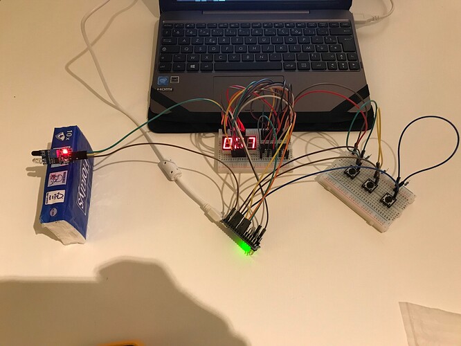

I'm proud to announced that the project seems to work pretty good ! See picture attached.
I corrected some pieces of code (still not changed it with the boolean variables).
I have 1 mini-issue : when i start the arduino, the variable FC51 always goes to 1 by itself, so the counter starts at 1. When i press reset, it goes to 0 and everything becomes normal.
Do you know why the FC51 reacts like that ? Is there a workaround that it doesn't, or at least that the counter really starts at 0 and not 1 ? Maybe something to change in the code ?
Below the current code :

I now need to build the real protoype, and see if 1 IR sensor works with the plastic bags, or if need to put more, or change to the piezoelectric one.
Thanks again for your help,
