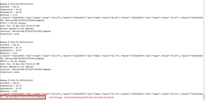

I am using mkrGSM1400 for a remote sensing project.
The board is using GPRS to send periodically data to my server.
I am sending data with a PUT request incorporating a simple JSON
It is working fine BUT : randomly, the data stops being sent. This occurs after a few tens to a few thousand request.
The console debug shows that the freeze occurs in the beginning or at the middle of the PUT request. (See attache picture)
Does anybody face the same problem ?
Note : I am using a soracom IOT simcard. This simcard connects to the best carrier available at a given point and time

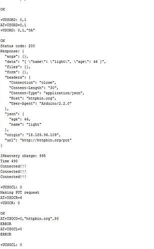

Hi to all, @heligone i have tested the sketch of @Marcussacapuces91, and and reproduced the issue, now i take some modifications like introducing a timeout and impose a client.close() and a client.flush() after the put request, the code that i use is the following:

In my test it run for 3 hours and put around 1000 of request, could you try and let me now if works?, while i proceed to test it more and more, another things could you share the log of the debug mode?

This known issue may be relevant:
Basically there is an issue that allows the MKRGSM library to get out of sync and lock up waiting dor a reply to a command.

Unfortunately, none of the solutions tried is working :
  • use of tinyGSM resulted in 5 freeze during a 2 mont test in a remote location
  • Riccardo_Rizzo : I have tried your code but it still freeze if I emulate a network glitch by removing and then putting pack the antenna (see attached pic)
  • I have tried code from SORACOM team
    GitHub - alexissusset/soracom-mkrgsm1400: Soracom Air and Harvest services with Arduino MKR GSM 1400 project example
    --> freeze after few iteration
  • I have tried code form francmunoz
    GitHub - FrancMunoz/MKRGSM
    who forked mkrgsm library to patch delay issue with SARA and programmed an asynchronous connection exemple. The board does not freeze anymore , BUT sometimes gsm.begin() gets stuck and the board is unable to reconnect to GSM (even though other functionnalities in the loop are still running)
It is unfortunate that an arduino board necessitates advanced low level programming skill to establish a simple GPRS connection without a glitch ...

Hi @heligone, i have modified the sketch proposed before:
  • Now it is able to retry the connection when the antenna disconnect or loose signal; consider that my code actually (in the sketch) don't have timeout or counter for count the number of re-connection, it try to reconnect forever until when the modem return registered status, you could manage this simply adding in the loop() a counter and choose to do nothing or what you need;
  • When you disconnect the antenna it try to open a new socket, if not possible it return on the sketch, the time required for this action seems long but each time that i have tried to disconnect the antenna, it always was able to:
  1. follow to run and restart to communicate with the server if i reconnect the antenna;
  2. goes in the else condition of if (gsm.isAccessAlive()) in the main loop;
In the sketch that i propose following i have added some comments, if you look in the loop all the action is subordinated to if (gsm.isAccessAlive()) this check the CREG value and if it is different from a value that represent the registered status to the network it return false, in this way if +CREG=0 case happen when you are in the main loop it allow you to impose your condition in the main sketch, consider that the modem manage automatically the value of CREG, then could you try the code from your side and let me know if work?

    unsigned long looptime = millis();
      changing the condition here the sketch don't freeze when the connection is lost and the antenna is detached

      here you can implement all the actions that could be done if the connection is lost
    Serial.println("not connected, loop:sketch ");
in my actual test, it run from 4 days, i have disconnected random the antenna and each time that i have reconnected, it was able to establish again the connection with the server, all the problem was managed from sketch, be sure to have the last library version, the only condition that i have change is that in the MKRGSM library in file Modem.cpp in the last line i change the baudrate to 115200 in my test, soon i'll report the results of a long run test with the highest speed possible.
