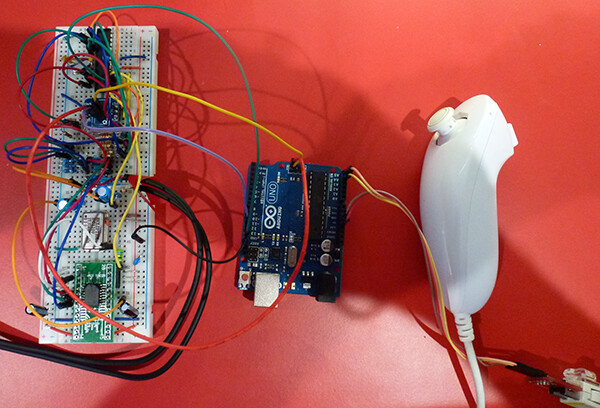

Right, I made a NES controller emulator using a Wii nunchuk. The protocol was a tiny bit obscure (one latch pulse and seven clock pulses) but I got there. For timing reasons I made a tight loop where it waited for latch, and then clocked out the 8 values. Then in the 1/60th of a second I should have available I read the nunchuk ready for next time.

With the assistance of that I was able to play the game. Now I'll take a look at how the code works. :slight_smile:
