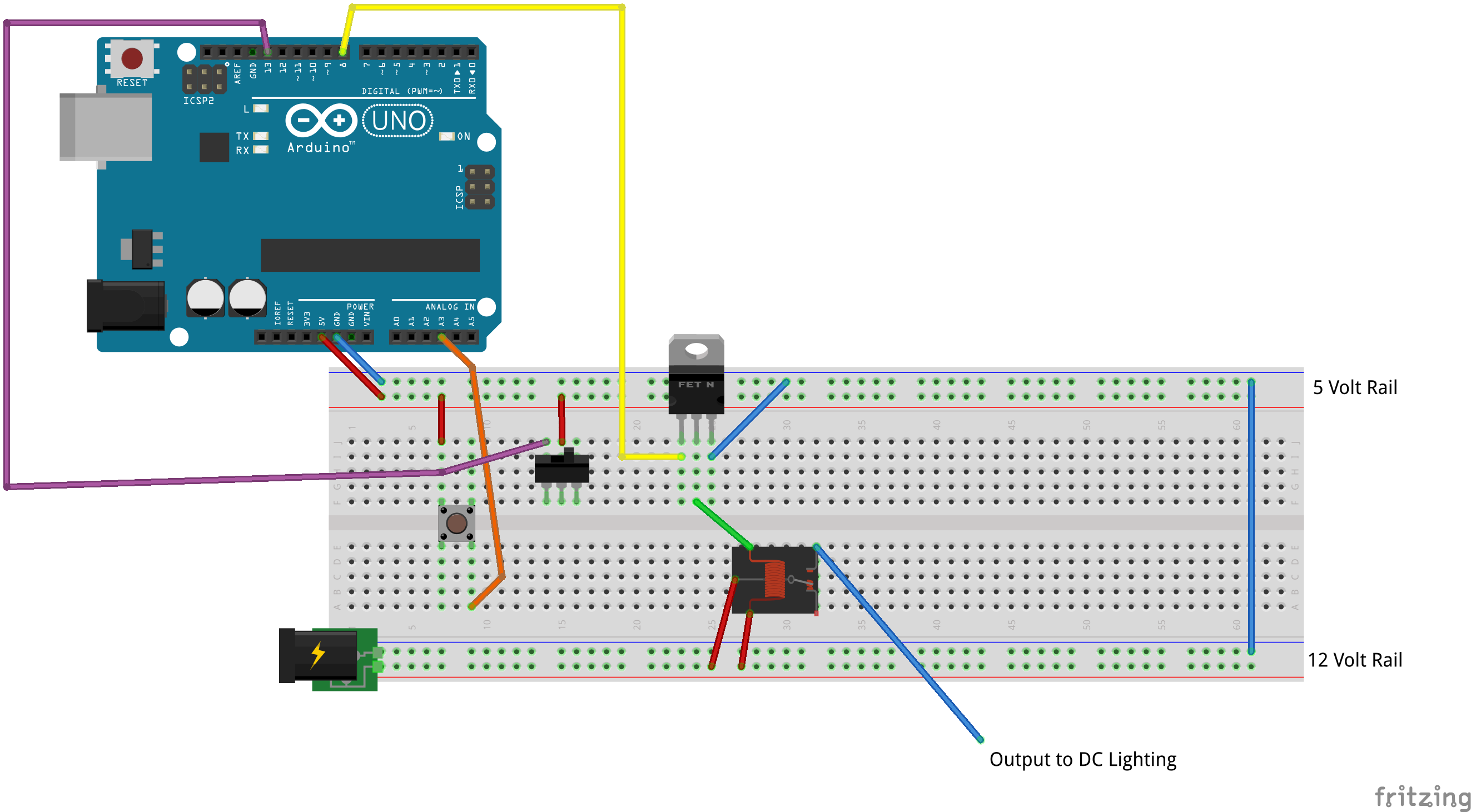

Confused on how to get Millis to pause in between LED fading
Hi all -- I've been studying Arduino for the better part of a year, and am becoming more comfortable using things like the Millis function. I've come across a post where the sketch writer used Millis to fade an LED up and down (see below). But I'm trying to fade the LED up, stop for 5 or so seconds, and then fade down. I've searched the topic all day but since everyone's code is different, its a bit harder to follow exactly what they're doing.
Im thinking along the lines of -- after the led fades up, you add something like
if (currentMillis >= previousFadeMillis+5000) {
// if currentMillis is greater than what it was before, by 5000 milliseconds
fadeValue = maxPWM - fadeIncrement
I think my train of logic is on the right path, but I guess I'm not sure exactly how to code it. If anyone can give me a boost I'd appreciate it!! Thanks!

Read and follow the links in this URL.
https://forum.arduino.cc/index.php?topic=503368.0
I actually went through that earlier, but I'll take another stab at it and try to create an original code. The only reason I tried to add onto the existing code is because it does everything I need except the hold. I'll report back!
Time to stop copying other peoples code and start writing your own.
No matter how hard you look, you will not find all the features you need.
Looking at other code should be for learning techniques.
The above line does not represent the correct way to use BWD style coding.
The title of this Thread suggests a false understanding of millis()
millis() is never paused, just as you never stop the clock on your kitchen wall.
If you want an interval between things then save the value of miils() at the start of the interval and use the usual
if (millis() - intervalStartMillis >=interval) {
to determine the end of the interval.
Think about how you would use your kitchen clock to wait 20 minutes between the end of cleaning the oven and the start of doing the ironing.
...R

So I sat down for a few hours and came up with this --
I also added in a PIR sensor to trigger the led turning on. The only issue I'm having now is that because the PIR has the 5sec "delay" built into it, my input (and LED) stays high for a minimum of 5seconds. I was thinking that for
if (ledStatus == HIGH) {                                  // IF the LED status is HIGH
      if (currentMillis - startMillis > ledOnTime) {          // AND if a period longer than the "set LED ON" time has expired
        digitalWrite (ledPin, LOW);                           // Turn the LED off
Could I write something like   if (currentMillis - startMillis > ledOnTime - 5000)
where the -5000 would act as a way to work around the PIR delay keeping everything on? But I also feel like if I don't use the ledStatus as my "off trigger" then I may be able to work around it as well.
Any suggestions? Thanks for the motivation!

Negative time makes no sense. How can you know that the input is going to start 5 seconds in the future?
Instead of turning the LED on and starting the timer when the PIR is HIGH, detect the change in the PIR. That means you should record what it was on the previous loop and compare against that.
It makes sense as far as the negative time if it did the calculation during the loop and read if the time passed is greater than ~300ms~ (for example) but I also understand what you mean. is there a way to tell it directly that if its greater than 5000ms or 9000ms what to do? Like if I made time a variable? something like:
ledOnTime = 5000

That will turn it off ledOnTime milliseconds after it went on. If the PIR is still detecting movement OR still within its 5-second period, it will turn on again a millisecond later. Is this what you want?
Point taken! Ill rewrite it tomorrow as a state machine and see where we get :wink: thanks for the help so far!
Well, I'm closer. I got the led to come on via the PIR and I got it to only stay on for as long as I set my ledOnTime for -- but the only issue I have now is that its not recording the previousPIR state as the current state, because once the loop restarts, it read the new PIR state as the current...and since the PIR stays latched for 5seconds, it will start the whole process again.... basically making my LED come on twice in one motion sense (atleast I think thats what the issue is).
Is there a way to work around this?
