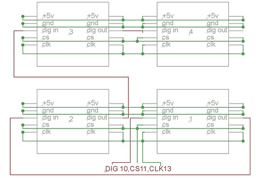

Hi
I'm using this code to control 4 8x8 led matrix(Max7219) and the idea is to use two potentiometers to control left,right,up and down of the cursor and two buttons for on and off of the selected led.
This works fine but I have the same display repeated on all 4 matrices rather than one big matrix.
Any help or advice greatly appreciated
Rich
Don't they need each their own CS line?
In the examples I've seen cs and clk are wired in parrallel and the dig in series but I'll give it a try
Ah, I see. Got confused by the typical SPI pin names, but it's not SPI.
Please post schematic of how you have your project wired.
Here's how I have the matrices arranged and wired
I guess that if you are doing something like this:
char x_translate = map(LR, 0, 1023, 15, 0) ;
char y_translate = map(UD, 0, 1023, 0, 15) ;
Which is delivering values in the range 0 to 15, you then have to address the relevant display 0 to 3 based on a range , something like:
if ( x_translate < 8 && y_translate < 8 ) lc.setLed( 0 , x_translate , y_translate , . . . ) ;
if ( x_translate >= 8 && y_translate < 8 ) lc.setLed( 1 , x_translate - 8 , y_translate , . . . ) ;
if ( x_translate < 8 && y_translate >= 8 ) lc.setLed( 2, x_translate , y_translate - 8 , . . . ) ;
if ( x_translate >= 8 && y_translate >= 8 ) lc.setLed( 3, x_translate - 8 , y_translate - 8, . . . ) ;
As it is, you appear to be treating all 4 displays in parallel.

Great! Thanks for that help.I've incorporated that code into the sketch and it is identifying the 4 matrices like this
3...1
2...0
So i have up down and left right :slight_smile:
When I was using a single matrix I could press one of the buttons to select or cancel the led in it's current position.Two things are happening now.
  1. If I store a led on matrix 0 it is also stored on matrix 1,2 and 3
  2. When I move the potentiometers into a position on matrix 1,2 and 3 each led in that position gets automatically stored until it hits the same postition on matrix 0 when it gets cancelled.
For example if i turn the potentiometer for right to left it scrolls the leds on matrix 0 but they all light up on that row on matrix 2
So it seems I have a problem with the button state corresponding to the matrices 1,2 and 3
Am I on the right track here?

Here's my amended code.Yes the first matrix is working perfectly.Just the others won't save a pixel or if I hit the same pixel on the other matrices they copy the saved pixel from the first matrix.

Fantastic.That works perfectly.I've learned quite a lot looking at how you've altered the original code so thanks again
OK. Good. I'm pleased that about that. Now it works, you can explain what it is. Is it a game or what ?
It's going to be the display of an audio switching matrix where the leds will indicate which switch is closed.I'm using the adg1414 octal switch.It seems pretty easy to control via spi.The hard part for me now is linking the status of a stored led to a closed switch on the adg1414
Something like this
Oh great. I'm glad it has a practical application and the display does look good.
