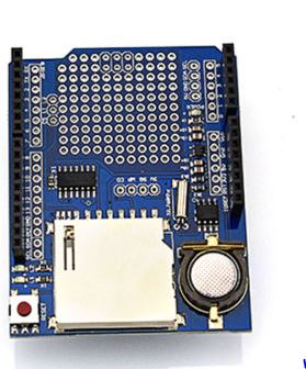

SD card logger shield, can read card ok - but I can't delete or write file ?
I am using Deek Robot Data logging shield v1.0
I am confused because I can read the directory from the SD card without any problems, but I can not write or delete a file which for sure exists on the SD card.
Below is image of the actual card
I attach my sketch code below.
Many Thanks
Les

Hi, Not sure if the image of the data logger is yours or one from the internet.
If it is yours and you are still having problems note the battery is in the wrong way around.
Normally it should not affect the card but, a lack of voltage on one of its pins maybe the cause of you not being able to write to the card.
Hope it helps. D
