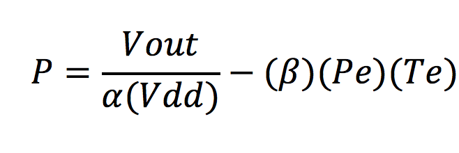

Thank you for the reply - Yes I've found the formula in the datasheet. However the subject of the formula is not what I want... I've tried re-arranging it and it doesn't work out.... I've attached an image of the formula calculated for Vout= but obviously I want P(pressure)=
Nothing attached ... :confused:
Sorry! Try again..
Ok so I've rearranged the formula successfully!!! YAY! But now I need to enter that into my code... Can anyone help me?
I don't know what to do with that formula.
What is alpha ? What is beta ? what is Pe ? what is Te ?
Could you tell which sensor you have.

float pressure = ( Vout / ( alpha * Vdd ) ) - ( beta * Pe * Te );
Alpha = 0.036
Beta= 0.04
Pe (Pressure Error)= 0.375
Te (temperature error)= 0.1
I Have the AP20 025KG pressure code

That is the Fujikura AP20 25K.
I have been reading about it, and it is a analog pressure sensor for 5V and 25kPa (which is very sensitive).
It is sold in the us by Servoflo.
Info : AP2 & AG2 Series Calibrated Low Cost Pressure Sensor - Pressure Sensors - Mass Flow Sensors - Humidity Sensors - Micropumps
Manufacturer introduction page : http://www.fujikura.co.jp/eng/f-news/2038611_4207.html
According to the info at Servoflo, the sensor is linear, has a span of 4.5V, and a offset of 0.2V.
That means that the 25kPa is linear equal to the 4.5V (with the offset of 0.2V).
With that info, I have a totally different calculation. You can try them both :stuck_out_tongue: Perhaps they have the same outcome.
int rawADC = analogRead(A0);   // 0...1023 for 0...5V
float Vout = (float) rawADC / 1024.0 * 5.0;  // 1024 steps for 0 up to 5V.
float pressure = ( Vout - 0.2 ) / 4.5 * 25.0;   // pressure in kPa, substract offset, 4.5V is 25kPa.
