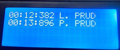

Hello there, I want timer stopwatch for Arduino Uno and LCD I2C display.
Code now working that: MINUTEMINUTE:SECONDSSECONDS:DIGIT i want MINUTEMINUTE:SECONDSSECONDS:DIGITDIGITDIGIT Is it possible with millis or must i use micros? Can someone make a example code for that?
Code for try it at you: I want 00:00:000 instead of 00:00:0.

Sorry for bad english. I want it for stopwatch for firesport. Thanks a lot! I dont have experiences with time.
Photo of actual project:

should be
void tickClock() {
  if (millis() - timer > 0)
    timer += 1 ;
    tick();
And then you need to call "tenth" "thousandth", and print all 3 of its digits:
  lcd.print (thousandth/100) ;
  lcd.print (thousandth/10%10) ;
  lcd.print (thousandth%10) ;

I think that this approach might well be doomed to fail.
You are attempting to write to the display 1000 times per second, using probably a rather inefficient library, no less. My guess is that this would cause the clock would fall far behind.
Probably better to stick to displaying tenths of a second when the clock is running, and only show thousandths when paused or stopped.
No, working bad. :frowning: Can you try to fill whole code with that? There is function, where there are increment of each variable..
I fixed it
working like charm
Please, can you post the full finished code ?
