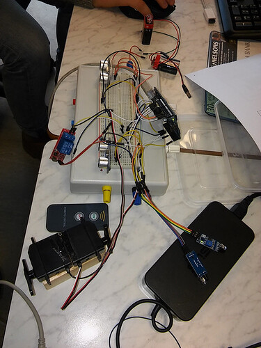

Hello All,
Thank you so much for such a great forums, hope this is the right place to post it.
I am in need of some help and advice to improve my project.
It should be basically a robot with wheels which uses ultra sonic sensor HC-SR04, on Arduino UNO, using 2 motors SM-S4303R, it should rotate, find the abstract and then move forward to it as fast as possible.
The main concept which I am going to follow is similar to the attached photo. basic code to start is here too and will be updated.
Any feedback is welcome about the code, how to make the code better and how to build the physical parts more efficient too .
Thanks.

I suspect that your robot will be faster if you rotate it 180 degrees about any axis.
Your robot shows two servo motors. Your code only deals with one.
Your code for measuring distance from a ping sensor, that does not appear in your picture, is in loop(). You really should learn to write functions, and put the code in a function. Validate that the function works, and then you can just call getDistance(), and KNOW that the code works. You can then concentrate on why your robot runs into things, instead of steering around them, without worry about whether getDistance() is the problem.
What do you think?
I think that you should post your code as described in the "how to use the forum" stickies so people don't have to download it.
Does the code do what you want? If not, what does it do and how is that different from what you want?

Thanks a lot for your reply, I am now using the right method for codes now.
Regarding the circuit we do not have it now. But I will keep this post updated for each step we took.
Basic code is there.

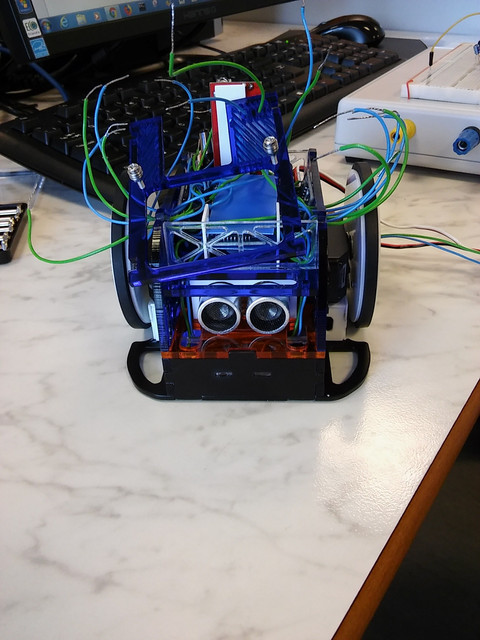

Basically it is a sumo robot which shall stay in the field and those black-white detectors sensors are there to detect the doyo color and the ultra sound sensors measure the distance of the opposite robot, I hope that ot looks clear for now, soon I will add a simple concept too.
Here is the equipment we have so far.
Concept coming soon.
Thanks for your attention.

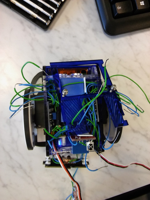

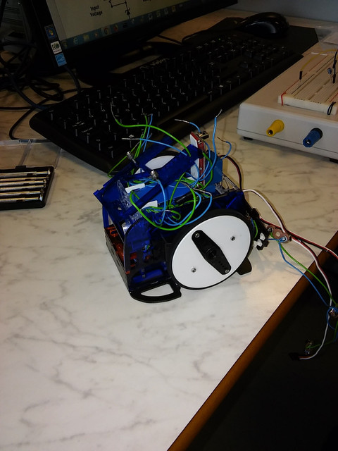

Hello All
@vinceherman : yes you were right! we used 2 but they failed again.
Here is the code and a pic of the setup which we are trying to make the robot based on.
Which battery you suggest?
What do you think about the code?
How to improve it all in your professional opinion?

Some questions about your hardware.
You show 2 servos. It looks like you will be using them as wheels. Did you purchase continuous rotation servos? Or modify your standard servos to be continuous rotation?
For the rest of the post, I will assume your servos are continuous rotation, and that the black rings in your pic are the wheels that will be attached to the servos.
I often see people use power banks for portable supplies.
Looking at your code, I see you setting one servo to 0 and the other to 180, then using a delay for 5 seconds.
Why 5 seconds? That seams to be a long time to go without reading any sensors.
And you really don't need to use else with every if. E.g.
  if[(analogRead(A0) < 900)
    myservoR.write(180);
    myservoL.write(0);
    delay(5000);
  else   // just take these lines out
  {       // they aren't
  }       // doing anything
Other than that can you explain what actually happens when you write(0) or write(180) to one of the servos? Some comments might perhaps help. There are many places where you only write to one of the servos and that seems odd.
Are the results from all your Serial.prints showing what you expect?
And of course the big question. What does it actually do now? And what do you want it to do that's different?
Steve

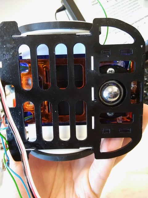

Thanks, AWOL, I checked with our guys and tutor, they said we have enough free memory and really no need to change that at this stage, but I personally agree with you want to know how it can be changed?
Dear Tom, I discussed it with my teammates now, the sensors are opposite direction, we still have a bit of that, not too much, we are going to test the robot, I will keep you posted about what happened in reality.
I also attached some pics of the progress, we used Fusion 360 to see and measure the parts and laser printed chassis etc... before building it.
The code is still the same, the very first post contains the code, as well as one of the posts which included it. after testing the physical robot, we will see if the code worked well enough or not.
Thanks for all your support!
