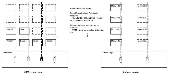

I have come across something weird that I can find no explanation for.
I am developing an application using Serial1 in a Mega to transmit a string of characters to a slave device. The slave accepts 2400 baud, 2 stop bit, no parity, and replies over the same line using a strange semi PWM format - pulse high for < 400 us = LOW; high > 400 us = HIGH. The message string is prescribed as 6 bytes, the first is always 0xFF, there are 4 following bytes, and a checksum/address combination - 6 bytes in all. Each bit is a total 1.1 ms, and there is a start bit of around 1.5 ms. In some cases, there will be no slave response so the system has to accommodate this.
My concept is to use interrupts as much as possible so the Arduino can do processing while the communications is happening. On the completion of the transmission, I want to start a timeout check using one of the 16-bit timers. Initially I set this up for 15 ms, but found that the timer was not correctly synchronised to the end of the transmission.
Code is as follows:

I'm using a switch statement to handle the various phases. The area of concern is case 4, where I am detecting the sending of the last bit in the transmitted message and then starting Timer 5.
With the timer set to give a 15 ms delay, it was starting after the 4th bit of the 6-bit message instead of waiting till the complete message has been sent. By experimenting, I found that adding an extra 0x00 byte to the end of the message, it was sent and the timer started at the end of the stream as expected. I also altered the timer preset to give a 12 ms timeout, and again it worked as expected.
In the attached photos, the top trace is the traffic on the communications port, and the bottom shows the operation of the timer - HIGH when the timer is running.
I have absolutely no idea what is causing this, and any input from the group will be welcome!

I'm not sure where the problem lies - that is the issue. The objective is to complete a transmission using Serial1 TX pin using standard serial format (2400 baud, 2 stop bit, no parity) then turn the pin around to receive the special PWM-like format. As some of the replies may not have any incoming data I'm using Timer5 to generate an interrupt that will halt the receive routine. I am starting the timer using TXC1 which should indicate that the last bit of the last byte of the transmission stream has gone out.
What is actually happening is that, with a 15 ms delay (Timer5 preset 0x8ACF0), the timer is starting at the end of the 4th byte of the transmission, with 2 more bytes being sent after TXC1 has apparently been triggered. If I change the timer preset to 12 ms (preset 0xA23A) it operates as expected. The change to the timer setting is the only change made between the two sets of images.
The relevant code is on cases 3, 4, and 5 of the switch function - case 3 detects TXC1 and sets the indication on pin 17 (bottom trace). Case 4 stops the transmission and starts the timer, while case 5 is a loop until the timer times out. The transmission of a byte is done in case 3, which should not be entered after TXC1 has been triggered until the next transmission is started.

Further testing ...
I changed the value of the timer preset to see if that had any effect - the program fails for values of the preset between 0x8A6F and 0x8D9F. I have not tested much outside this range. I have also tried changing to Timer 3 with no effect on the problem.
As the program is working with a delay of 12 ms - preset of 0xA23A - I'm moving on with other areas. The complete code, with diagnostic Serial.prints stripped out, is:

I can't definitively produce a diagram showing how the various parts connect as I am trying to find out what potential the Meccano modules have for use with Arduino systems, and that is still a work in progress. The diagram shows the official connections to the MAX system, and what I hope to be able to do with the Arduino. As shown in the protocol document, each channel on the Meccabrain can handle up to 4 modules in positions 1 to 4, daisy-chained so that 1 is the module connected directly to the Meccabrain, 2 is connected to 1, etc. The Meccabrain unit described in the Protocol Description is an older unit with 8 channels whereas the one I am dealing with has only 4, as shown in the diagram.
Each channel uses the signal formats specified in Sections VI and VII as shown in the diagram - commands from the Meccabrain to the modules use the standard serial protocol described in Section VI while the responses from the modules to the Meccabrain use the "PWM" format described in Section VII. The Meccabrain also provides power to the modules and this places a limit on the number of modules that can be connected to each channel. Since the modules reply one at a time in turn, the existing format is very inefficient - commands are issued about every 45 ms, but each module replies once in 180 ms. If no module is connected, the others in that channel still have to wait for the full cycle.
I intend to replicate this structure, but in a more flexible way, so that any unconnected modules can be skipped, and that the full channel capacity can be used if possible.
I honestly don't know what other information I can give you - since this is an exploratory exercise intended to find out the capabilities of the system, I can't say definitely that I want to achieve a specific objective. Thanks for your time and assistance.
Your diagram is a big help - it seems like you do want the Mega to take the place of the Meccabrain - which was my question in Reply #13
However the 2 sides of your drawing are not equivalent. On the Meccabrain side there are familiar things (servo, motor. LED, sensor) all of which are regularly used with Arduinos but on the Arduno side you have Modules. I don't understand why the two sides are different.
