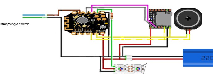

Hello - I am working on a project where once a button is pressed, a sound file will play and LED lights will come on. Ideally, I'd like to have the led lights turn off once the sound file is complete/played once. The next time the button is pressed, a different sound file (in sequence) would play and the same LED lights would turn on again for the duration of the sound file. This would repeat until the 11th press when the system would loop back to the beginning and restart.
I'm relatively new at all of this but have scoured the forums to put together a schematic and program that I thought would work. However, when I finally had it set up, nothing happened. No LED lights or sounds.
Below is the code I attempted to use. Any information, tips, or suggestions you may have would be much appreciated. I am sure that I made this a lot harder than it needed to be, but have been unable to figure out how to simplify.

This, and similar statements, does nothing.
I think what you are trying to do actually needs a switch statement. Look it up. Give it a try.

More issues:
Jordan_elder:
  reading = digitalRead(inPin);
  buttonPresses++;                  // increment buttonPresses count
  delay(250);                      // debounce switch
  if (reading == HIGH && previous == LOW && millis() - time > debounce) {
buttonPresses++ is at the wrong place: this should only be incremented when you have a button press recorded (so after the if statement).
Then you're doing debouncing twice. That's not needed. Drop the delay(250) and your code will be much more responsive as well.
Remember to somewhere make sure previous is set back to HIGH (not sure if that's the case for you - do an autoformat and all the blocks line up nicely making it a lot more readable). You also don't seem to update the value of the variable time, so that part of the debounce won't work. That's not good a name, as there's a library called like that: you probably see the name being highlighted, that's a warning sign. Pick another (preferably more descriptive) name, buttonPressTime or so.
