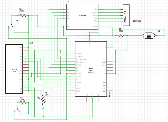

We need to see how you have connected your components.
Please not a Fritzy picture.......
Oh yes I am giving the limit switch declaration, which is correct

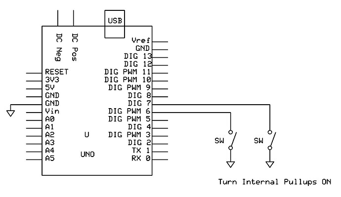

To sketch and draw the circuit please look under tom :slight_smile:
Thanks for the diagrams, your limit switches need to wired differently to what you have.
Your wiring should be like this, with pullups turned ON in your code.

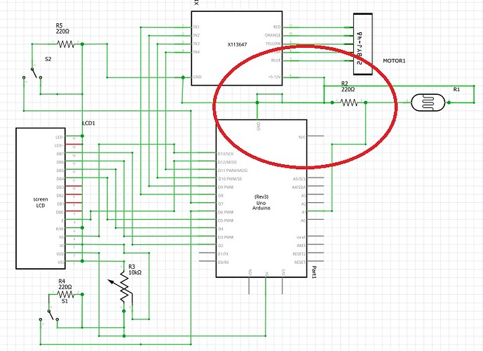

I think you might be better to draw your circuit with pen and paper.
Circled area looks very wrong.
Tom... :slight_smile:
Okay thanks, but in the scheme it is the result of that color image, i am also confused kok vcc line connect to ground, but i understand if it is wrong, but in my practice tool is correct maybe my schematic is wrong draw it.
