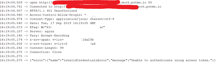

When i run this code with HTTP/1.0 i have this error
16:19:04.509 -> open http://a************************5f.mock.pstmn.io 80
16:19:04.741 -> Connected to http://******************5f.mock.pstmn.io
16:19:04.907 -> HTTP/1.1 401 Unauthorized
16:19:04.940 ->
Access-Control-Allow-Origin: *
16:19:04.974 ->
Content-Type: application/json; charset=utf-8
16:19:05.040 ->
Date: Tue, 17 Sep 2019 14:19:05 GMT
16:19:05.073 ->
ETag: W/"63-NBrQ********************mc"
16:19:05.107 ->
Server: nginx
16:19:05.140 ->
Vary: Accept-Encoding
16:19:05.174 ->
x-srv-span: v=1;s=f1********23b
16:19:05.208 ->
x-srv-trace: v=1;t=2af********6
16:19:05.242 ->
Content-Length: 99
16:19:05.275 ->
Connection: Close
16:19:05.275 ->
16:19:05.275 ->
{"error":{"name":"invalidCredentialsError","message":"Unable to authenticate using access token."}}

It seems unlikely that the code should have asterisks in so many places. What does your server expect?
The code has asterisks because i have censored my personal information liks wifi ssid, wifi password and the server links.
Either the URL of the site is incorrect or your credentials are wrong
Googling for "Unable to authenticate using access token" will show you that this error sometimes occured with Postman but the problem was fixed.
The library you are using seems to be sending raw HTTP requests. i.e the only thing you are providing the server is "GET /test HTTP/1.1". Some servers give you a "Bad Request" error when you do this.

These are called HTTP headers. Not all of them are essential tho. Try sending these lines one by one after sending your "GET" request:
Host: *******.mock.pstmn.io
User-Agent: Mozilla/5.0 (Windows NT 10.0; Win64; x64; rv:56.0) Gecko/20100101 Firefox/56.0
Accept: text/html,application/xhtml+xml,application/xml;q=0.9,*/*;q=0.8
Connection: close
Like this:
/* Send the request */
wifly.println("GET /test HTTP/1.1");
wifly.println("Host: *******.mock.pstmn.io");
wifly.println("User-Agent: Mozilla/5.0 (Windows NT 10.0; Win64; x64; rv:56.0) Gecko/20100101 Firefox/56.0");
wifly.println("Accept: text/html,application/xhtml+xml,application/xml;q=0.9,*/*;q=0.8");
wifly.println("Connection: close");
wifly.println();
If this didn't work either you have to open the URL in your browser and use the developer tools of your browser to see the actual HTTP headers that are being sent and by trial and error find out which ones stop the "Bad Request" error.
