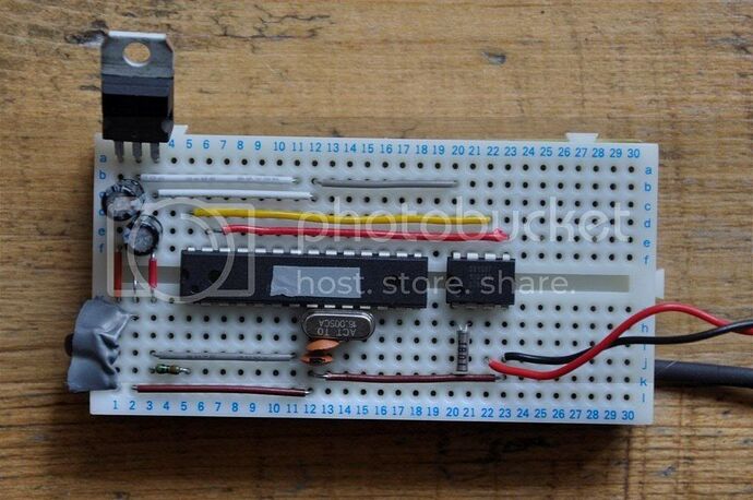

I'm having real difficulty with a clock project I've built, based on an Atmel 328. It's my first arduino project, so my inclination is to blame myself for any mistakes, but I am running out of ideas.
I'm using a DS1307 and the Wire library, and I'm able to set a time and read it back. The battery-backed standby function of the DS1307 is working fine, so it continues keeping time while the rest of the board is powered down.
In every way, the system is behaving as expected, except that, while the clock seems fairly stable, it is losing 3 seconds every minute!

  • checking the backup-battery voltage (3.3V measured vs 3V specified, but below the 3.6V limit listed on the datasheet)
  • soldering the components directly to each other (rather than using a breadboard) to avoid introducing capacitance
  • rewiring the circuit so that no other wires go near the crystal
The only remaining thing I can think is that the crystals are not putting out 32768 Hz. Losing 3 seconds per minute means the clock is running 5% slow, and 5% off of 32768 is about 30000.

Do you have pictures or schematic of your setup?
Yeah sorry, I should have posted this before. Wiring colour is just what I had to hand.
Grey-taped wires to the left are 7.5V input from old phone charger.
Red & black are 3.3V from a camera battery.
I should add that in the picture it looks like the atmel clock is touching the legs, in real life it does not but I've re-arranged the components now so that it is not adjoining.
Also forgot to mention that the output wiring is omitted, it connects some LEDs to the atmel output pins via resistors as usual when running as a clock.
The attached code is the debug version I run when the clock subcircuit is connected to the arduino - the real code has an additional method to light the leds, but the clock runs the same slow rate in both cases.

So ultimately it turned out to be the clock crystal.
SK Pang sent me 30kHz crystals (3 of them) instead of what I ordered, which was 32.3268 ones. Given all the head scratching it's caused, I'm not sure I'll use them again in a hurry. I might drop them a line and see what they say.
I got some replacements today from a different vendor, swapped one out, and now my project keeps perfect time.
It did seem the only logical explanation before, but I still find it incredible.
