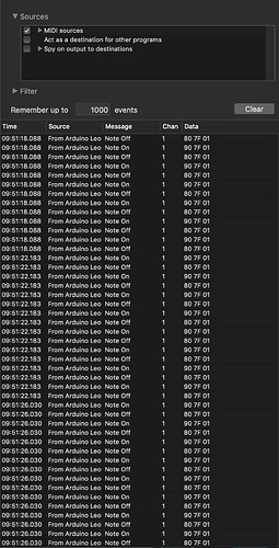

Hello all!
I am a fresh beginner on Arduino. No previous experience coding, but I know a thing or two about midi hex. Aside from the 20+ hours I've spent racking by brain trying to get this to work, I have no other experience. Arduino isn't supposed to be this frustrating, is it?
I need to use (12x) CD4021BE shiftIn registers to send button press information (from 96 buttons) to an Arduino Leonardo, then have the Arduino turn each buttonPress & buttonRelease event into midi noteOn & noteOff commands using the USBMIDI library. I don't want it to keep playing noteOn & noteOff commands at a set interval (like a loop), just only when a button state change happens.
I know you might want to suggest that I try to matrix them instead of daisy chain, but I'm just burnt at this point. I'm sorry, I understand CD4021 daisy chaining and that's about it haha.
So... for my masterpiece (in progress). I have set my circuit up exactly like it is set up here... except mine will have 12 CD4021's. Here is the code so far (mostly patched here and there from different sources, so I apologize for how scatterbrained it is). I'll explain the trouble I'm having after the code...

So... after you've had a good chuckle at the frankenstein code I've created, hopefully you know how easy (or hard) of a problem I have on my hands.
When I run the code on my Leonardo, I am able to send midi commands to my computer. The button sends the correct information for noteOn/noteOff, note, velocity, and channel. My problem, I believe, is with how the code handles the shift registers. I think it's the timing. I have to press a button 8 times (for 16 state changes) before the shift register releases the information into the Arduino and the Arduino sends the midi messages. The result is I get 16 midi messages all at once for all of the last 8 noteOn and 8 noteOff events.
So, given my circuit and my code, what do I need to do to make it so the moment a button is pressed, a noteOn (with proper note, channel, velocity) is played, and noteOff when that button is released?
If it'd be considerably (and I mean considerably) easier to re-configure my circuit given the parts I have (based on the schematic at the link above), let me know! Thank you so much in advance!
You're not flushing the MIDIUSB stream
Oh dear, their are no decoupling capacitors on that circuit. These are needed for reliable operation, they are not optional. You need a 0.1uF ceramic capacitor between the power and ground pin of each shift register.
http://www.thebox.myzen.co.uk/Tutorial/De-coupling.html
