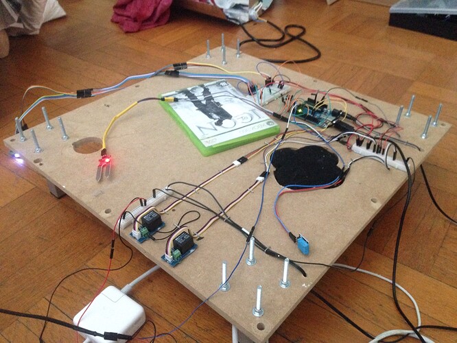

Hello, first of all thanks for reading this post. I'm completely stuck on a project. I am currently doing my first project with my first microcontroller.
I'm making a culture chamber with a CFL bulb, 2 relays, a DHT11 (a temperature sensor), a moisture sensor and so far everything was doing well. (i'll post the code for the entire project if needed, but it's a bit long)
However, if most of it worked i couldn't manage to set the Fan I used at the speed i wanted, with any code it would run full speed.

Hello again, yes the ground is connected both to the arduino and the adaptor.
And i tried the code you just posted dlloyd. It doesn't seem to have any effect, the fan just keep going full speed. And any code i write doesn't seem to do anything....
Is this possible that my fan is damaged, something else is going on ? With the program on my arduino, i can even unplug the PWM of my fan and absolutely nothing happens...
Update: Hello everyone and thank for you patience. Turns out that the code dlloyd wrote works perfectly and it seems that i made a wiring mistake. So if you have the same issue verify twice your wiring haha:
PS: this is the wiring of my first project, i'm sure you'll understand why i made a mistake in this mess !
Thank you everybody ! And special thanks dlloyd you made a code that will be very useful for me :slight_smile:
