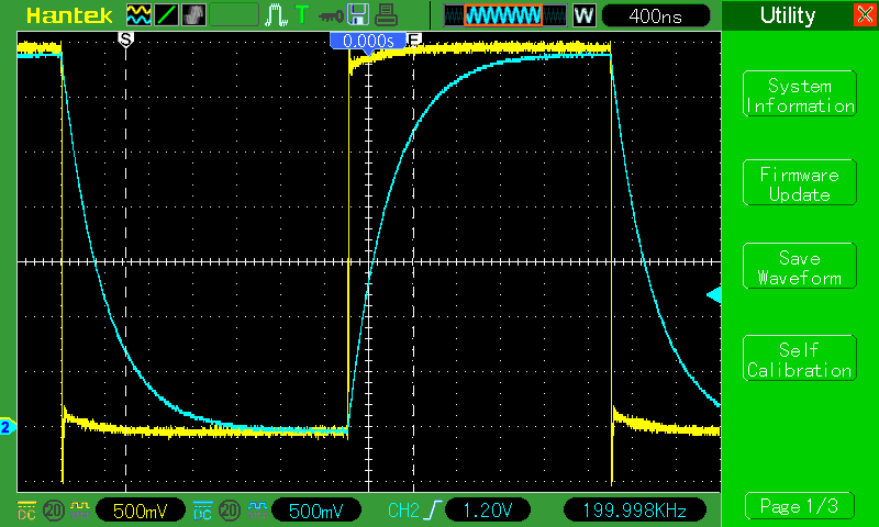

Hi guys,
I'm trying to achieve an ADC sampling triggered by then PWM. The circuit is very simple, I have an RC filter on the PWM (pin 34 and 35, PWM ch0), and i'm reading the voltage on the capacitor trough the ADC, on pin A7 (ADC ch0).
As you can see in the image I would like to read the value at half of the transitory, because it's the average voltage.
Reading in the Arduino due ARM chip datasheet at page 1318 you can see that the Arduino due is equipped with a PWM event line, created for this purpose.
I'm pretty good with the registers so I used this way to implement the code. The problem is that the trigger is not reaching the ADC converter, and i don't know why, it's two weeks that I'm trying to figure out why. Meanwhile i wrote a code that uses another PWM (ch4, pin 9),synchronized with the ch0, that is doing the same job wired to the hardware trigger on pin 18. But I need a better solution, an external wire it's not enough for my project. In this case it's working, but I need something better. I also tried to ask to the Atmel support, but the path to reach their engineers is long and nobody gave me the right hint.
On the page 995 of the datasheet you can find how the event line works, it shouldn't be hard to do but for some reason I'm not able to deliver it.
Here my code, the register ADC_MR it's available in three modes, FREERUN (Never wait for a trigger, it's working), External trigger (it's working if you wire the Pin 18 to PWM on pin 9) and event line, that it's not working.
I hope someone of you can help me to deliver this event line trigger.

In the code above, 2 handlers are triggered by :
PWM->PWM_IER1 = .... // PWM Interrupt enable 1
PWM->PWM_IER2 = ....
So if you expect these handlers to be triggered several times, you should read their status registers to clear some bits:
