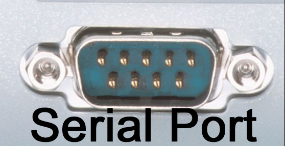

and does not use the MIDI cereal library
That made me laugh.
This is a cereal
This is a serial port
Good haha it’s a South Park joke from the man bear pig episode I did it on purpose
Well it's a good one. :slight_smile:
