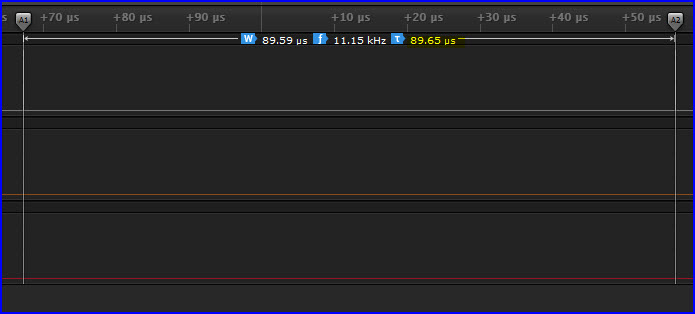

I measured a call to button.closed(); at ~90μS using the below code, after all I am retired :wink:
PINB = 0b00010000; //Toggle pin 12, takes 62.5nS
PINB = 0b00010000;
button.closed(); //Took ~90μS
PINB = 0b00010000;

Nice of you for taking the time to chrono button.close(). What I did was:
  unsigned long clock = millis();
for (unsigned long  i = 0 ; i < 1000000 ; i++) int j = digitalRead(3);
Serial.println(millis()-clock);
I got 3.210 seconds on average to digitalRead() 1,000,000 times. It translates to roughly to 51μs. In the french Tutorial, I mentioned around 60μs. in the english tutorial, I did'nt mention anything. Now that I have a real Chrono, I'll correct the french version and upgrade the english version with this new data.
Have a nice day.

With the attached code, the time it takes to call checkSwitches() is ~5uS.
i.e. every 50mS we take 5uS to check one switch.
The time it takes to toggle the LED is ~11uS every 1/4 second.

Here is the timing for checkSwitches:
I think you will agree the heartBeat toggling and the switch reading timings are negligible.
