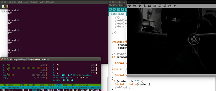

So I have been using opencv pretty sucessfully over the last week to do the grunt work or tracking motion but I have come upon a very wierd snag over the last two days. While trying to send multiple char's over the serial port something snags after a random amount of time normally over 15 seconds. Its is random and I have no idea whats causing it at first I thought mabye I wasn't resetting a table in the arduino and it's memory was running out and my program was just waiting for the serial to come back but then I looked at cpu usage on my laptop. It goes from 26-30% at .6gb to 100% when it snags. Another wierd thing about when it snags is both the TX and RX led's light up on the arduino so I am assuming they are sending and recieving serial? My laptop isn't reporting anything happening over serial though? That and if I press the reset button on the arduino the led's just stay on even after I kill the program on my laptop. I have to physically unplug the arduino before that stops. While it is doing the LED thing I can't re-upload the arduino either so I am assuming something is going on serially. I have been hunting around online and I think I am doing everything right but I am little confused. If someone could go over my code and help out it would be amazing. I am using python on an ubuntu 14.04 os.

Upon further reveiw of the serial monitor the Arduino sketch program has it appears the character n is being printed with twice the amount of n's as the time before so at 5600 times a second it umm gets very large very quickly and the processor is trying to catch up. I am not really sure how to fix this?

To summarize the weird issue's I am coming into contact with is that fact that the program freeze's and cpu usage goes to 100%. This is a serial issue because it doesn't have a issue with the serial lines just commented out. Also the Arduino is still sending data after I press the reset pin and doesn't appear to be following the delays I put in place on it.

My suspicion is that your code is continuously sending stuff and eventually overwhelms the PC input buffer - which would remain full even if you reset the Arduino.

So after looking around I found that adding the
flushInput()
flushOutput()
commands at the end of my loop works great. It doesn't lose any data because my arduino doesn't send any before my program ask for it and it helps it work fine
