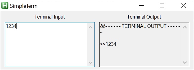

When the Autohotkey program is started, a header is sent from my PC to the Arduino .: - - - - - - TERMINAL OUTPUT - - - - - -
The Arduino send directly back to the PC .: ðð- - - - - - TERMINAL OUTPUT - - - - - -
(If the baud rate is higher than 9600) - 0xF0 0xF0 at the beginning of the desired string. I don't know where this characters is coming from. (as the attached example)
But these characters never come back, even if I press "BackSpace" and clear the text in the GUI-window and send the header again to the Arduino.
Is there anything unknown that needs to be cleared in Arduino serial buffer? (How to know?)
But, I think these characters (always the same characters) would also be created at 9600bps...

I initiate communication with Arduino and send the headline (as HEX) without delay.
Have tried adding delays of 1-2 seconds, after initializing the COM port.
But I have not seen any change in the result being sent back from Arduino.
At different baud rates, the results are different. With 115200 baud, two ðð are created before the heading, while a baud rate of 19600 only creates the following characters ý before the heading.

Example1 .:
I send "TERMINAL" LineFeed ">>" from the PC to the Arduino.
I got back to the PC .: ððTERMINAL LineFeed >> (as before)
On the LCD I got the result (as attached image) -
Can anyone explain why?
Is there a structural error?
What I send to Arduinon is, as I said, the text "TERMINAL" CHR(10) ">>"
But before this is sent through USB to the Arduino, the text is converted to HEX as in this example the result was .: 0x54,0x45,0x52,0x4D,0x49,0x4E,0x41,0x4C,0xA,0x3E,0x3E
Is this wrong?
Should it be without comma and only HEX? (like this 5445524D494E414C0A3E3E)
