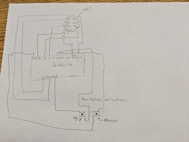

NRF24l01 LED Remote Modification not working
I'm creating a chicken coop door that will automatically open and close when it's night or day outside and alert me via the NF24l01 when the door is open or closed by lighting up an LED. I've successfully created a working prototype of that door opening part of the code. I am having some serious difficulty with the NF24l01! I have tried multiple examples from all corners of the internet. I have an Arduino UNO that will serve as the transmitter and another Arduino UNO that will serve as a receiver. I have 2 switches attached to the door. One that will switch on (go from 0 to 1) when the door is open and the other will switch on when the door is closed (also goes from 0 to 1). The Arduino would then send the door's state to the other Arduino. The other Arduino would then turn on an LED that is labeled as up when the door is up, and turn on another LED when the door is down. Unfortunately none of that works.
I've loaded the LED remote Example and that example doesn't send anything to the other Arduino. I tried the Getting Started example and that did work, I just don't understand how to modify it for my use.
Any help would be super appreciated!
I am using the
GitHub - nRF24/RF24: OSI Layer 2 driver for nRF24L01 on Arduino & Raspberry Pi/Linux Devices library.
Right now on the Arduino Uno attached to the door the pin layout is
CS-2
CE-4
MOS -11
MSC-12
SCK -13
For the switch it goes
Door up -8
Door down -9

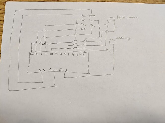

And on the LED Arduino it's
CS-2
CE-4
MOS -11
MSC-12
SCK -13

Have a look at this Simple nRF24L01+ Tutorial. The examples do work.
Wireless problems can be very difficult to debug so get the wireless part working on its own before you start adding any other features.
...R
Can you please post a picture of your project so we can see your component layout?
How are you powering the NRF modules?
Sorry for the poor quality schematic, I couldn't find a straight edge and I was a little short on time! For the sake of this project I took out all the code that had to do with opening/closing the coop door and just left the transmitting code. The code for the receiver is the same.

Attached is the transmitter schematic
The files were too big to attach? So I created a link for y'all.
https://photos.app.goo.gl/JVwB07urBuFWzMil2

To be perfectly honest I'm on a chrome book and I don't really know how to scale down the resolution. So it would be better to post the photos via a link.
if (downswitchReading == 1) {
    DATA == 100;
  if (downswitchReading == 0 || upswitchReading == 0) {
    DATA == 250;
  if (upswitchReading == 1) {
    DATA == 200;
  radio.write( &DATA, sizeof(DATA ) );
  Serial.print("DATA = ");
  Serial.println(DATA);
The DATA == statements are wrong. You are assigning a value, not comparing it, use =.
Ops diagrams
Tom.. :slight_smile:
Thanks for uploading the schematics! I have no idea how to do it on the Chromebook. I haven't been able to test the DATA = instead of DATA == yet.
I did the = sign instead and it worked, sort of. Now the transmitter only sends 200, even if I switch the switch on! I have no clue what's wrong!
What do your Serial prints statements say about the state of the switches? Is your logic correct for the INPUT_PULLUP on the switches, and what position is HIGH or LOW?
You may want to write a simple and separate sketch to test and confirm the switches and the logic.
The serial monitor says that they're 0.
Low = Open
High = Closed
I believe my logic is correct.
I wrote some new code to combat the errors i was getting using the old code
With this code I get 300 no matter the position of the switches
