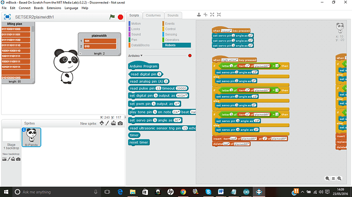

With my original sketch, I am already supplying to the serial monitor "by hand", copy/pasting from a text file. But I would like to replace that process with something quicker
"The four "set-up" numbers and the four pattern code strings would be sent to the Arduino via the serial link, and stored in variables for reference and re-reference for as long as you wanted the loom to weave that pattern" How can I implement this?
Question?
Do I need and event() to trigger sending the sequence to arduino (I need time to pass the weft and after when all servos go back to "0" I need time to comb or tuck the weft before the next sequence is executed, so will be ideal to communicate this to arduino through pressing a key (like I do now pressing sent in serial)
I have already programmed the sketch with a software called Mblock that interfaces with the arduino shield, but it is not working with more than 8 servos and I have 16 in my loom, please have a look at the sketch(picture), as you can see I can bring all the servos to "0" just pressing space key so that I save half of the sequences and the rotation of the servos is in my sketch not in the sequence
so my sequences will be reduced to "0" and "1" as you can see in plain width list, this will be easier to calibrate all servos on the sketch no on the input.
I have done quite challenging pieces of programming with this software and you can see how I generate the list for more complicated weaves at https://scratch.mit.edu/projects/110764955/
Thank you very much for your time and support

Hi Robin2
Thank you very much for your post, I have been looking at the serial Input Basics link,I have try the end markers and upload some samples, but it seems that in all 5 samples the values have to be input one by one in the serial monitor do you think I could convert one into my sketch?
I have open and upload your ArduinoPC.ino but I don't know how to input things in the serial monitor I have try with markers and other numbers but I do not see any info printed back into my serial monitor, I have not attached a led in pin 13
Have a look at the sketch that I want to achieve, is in the picture, I think I need communication with arduino through keys, now by pressing enter I input the value for rotation and if I press enter again and the serial is empty all my servos go to "0" I would like to be able to press space key for instance and go to next sequence in a list, or if I press a left arrow goes backward and right goes forward through the list
Thanks Robin2
Image from Reply #8 so we don't have to download it. See Image Guide
...R
I can't make sense of that image at all. It is nothing like a program I am familiar with. Where did it come from?
What I have in mind is that you make a text file on your PC with a separate line for each instruction and then use a modification of my Python program to read the text file and send the instructions line by line to the Arduino.
I don't understand what you mean by this
Did you also run the associated Python program on your PC? If you are using Windows or MAC you will need to change it a little to refer to the appropriate serial port.
...R
Robin2:
...R
It is a program called scratch for children to learn programming in an easy an intuitive way that can be interface with arduino and executes programmes, but it is not very robust It didn't work for me with more than 8 servos, no good for robots, but I have programmed complicated task with it like a weaving list generator you can see how I generate the list for more complicated weaves at https://scratch.mit.edu/projects/110764955/
Robin2:
...R
This sounds good I have already the text files, but I did open your file with notebook and uploaded into arduino without the Python associated program,
Could you think of an easier way to run text files on arduino, I feel like you with the above program I can't make sense of the arduino codes and I have never look into Python, would I have to download Python 3.6 or 3.5 ? and them open your file ComArduino2.py

I have already programmed the sketch with a software called Mblock that interfaces with the arduino shield, but it is not working with more than 8 servos and I have 16 in my loom.../quote]
Mblock MAY be a good starting point. Gives users the idea of what a program is, etc. Helps them by holding hand, making it hard to write something that just doesn't make sense.
But... as you pointed out... there will be limits.
The "raw" Arduino language IS a LITTLE strange at first... but I'd rather put my energies into something that, while strange, once mastered won't have limits. I will be able to do ANYTHING.
