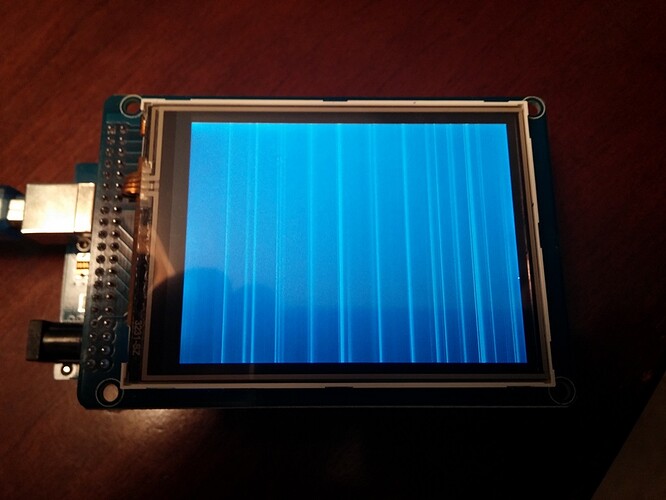

Touch Screen Not working on 3.2" TFT LCD & Mega 2560-r3
I am attempting to connect a 3.2 TFT LCD to a Mega 2560-r3 through itead ITDB02v1.1 shield.
The LCD and mega are both cheap Chinese models.
Board - http://www.gearbest.com/development-boards/pp_18651.html
Shield - http://imall.iteadstudio.com/prototyping/kits/im120717001.html
LCD - http://www.ebay.com/itm/3-2-inch-TFT-LCD-module-Display-with-touch-panel-SD-card-240x320-than-128x64-lcd-/200908823757?
I have been able to get the screen to display every sketch I try, but the display is not acknowledging any touch input.
I am trying to use the UTFT and UTouch libraries.
I am not able to draw in either the quick draw or quick paint sketches, nor am I able to calibrate or press any buttons in those sketches.
I contacted the seller to see if they had any code I could test, and the only answer I got was to try Googleing the problem...wow why didnt I think of that?!?! ::slight_smile:
I havent been able to find much for others with the similar problem with this setup. That along with >2000 of these screens being sold by the vendor makes me think I may have a non functioning unit.
Any help would be greatly appreciated.
Thanks
Ryan

It would appear the shield you are using is a general purpose prototyping shield, as such did you configure it to follow the commercial TFT shield scheme? As the Mega is a 5V device and most of the TFT displays operate at 3.3V, you have built in some sort of level translation ( resistors or IC )? A schematic of how you configured your shield would be helpful to at least determine if you stand any chance of getting this to work before you condemn the display.
Funnily enough, the touch functions do not need any form of level translation, so unless you can provide more information about how it is all connected, I wouldn't know where to begin to start to try to help you, there are just too many variables.
Regards,
Graham
My understanding of that shield was that it was designed to be the interface between the LCD and the arduino. There was no option for configuration when assembling the board. It is (in theory) plug and play.
Schematic - ftp://imall.iteadstudio.com/Kit/IM120717001_ITEADB02_Arduino_MEGA_Shield_v1.1/SCH_IM120717001_ITEADB02_Arduino_MEGA_Shield_v1.1.pdf
I did check the pinout on the LCD vs the shield and follow around through to the arduino. As far as I can tell everything is connected as it should be.
TouchP_CLK 6
TouchP _CS 5
TouchP _DIN 4
TouchP _BUSY NC
TouchP _OUT 3
TouchP _Penirq 2
Thanks
The tft lcd module uses SSD1289 touch panel controller. You may need to read the datasheet of SS1289.
Reading the SSD1289 data sheet, it seems like that is just the controller for the display and not for the touch functions.
I see on the descriptions for some other similar displays like this one a separate touch panel controller listed, though the vendor I purchased from does not list one.
Display-wise everything seems to be functioning well, only the touch is not working.

When I run this code
#include <UTFT.h>
#include <ITDB02_Touch.h>
UTFT myGLCD(ITDB32S,38,39,40,41);
ITDB02_Touch  myTouch(6,5,4,3,2);
  myGLCD.InitLCD(PORTRAIT);
  myGLCD.clrScr();
  myTouch.InitTouch(PORTRAIT);
  myTouch.setPrecision(PREC_MEDIUM);
    while (myTouch.dataAvailable() == true)
      myTouch.read();
      myGLCD.drawPixel (myTouch.getX(), myTouch.getY());
All I get is a lot of rapidly moving vertical white lines, seen in the other picture.
Sorry.I saw the LCD advertisement link ,and made the mistake.
The touch panel controller most likely should be XPT2046.
Correct...at least that is the model of the IC on the back of the display. Also the model number on the back of the screen is TFT_320QVT.
Would that controller be incompatible with the UTFT libraries?
I see other units that use the ADS7843 controller, which I think is supposed to be the same.

I too have a Sainsmart TFT_320QVT display with XPT2046 touch controller. It works FINE with Henning's libraries. There are issues with IDE 1.5x. Try IDE 1.0.6.
By the way, reference my previous post, apologies regarding my comments about your ITEAD shield, I didn't bother downloading the PDF or going into it too much, but I do have one comment. Your ITEAD shield appears to have resistors for level translation of the touch signals...... My shield does not.... try shorting out those 4 resistors if IDE 1.0.6 doesn't fix your problems.
Regards,
Graham
Incidentally, I just ran your sketch from your last post. Result from IDE 1.0.6 is :-

Attached is the pertinent parts of your documentation, and the complete CTE documentation for the MEGA TFT shield, as you see, NO level shifting on the touch signals on the CTE shield (widely considered the best :stuck_out_tongue: ... ). In fairness I can see the attraction of the shield you have, the fun of building it yourself, and the built in RTC, ( and the stress of figuring out why TOUCH is not working).
Best wishes,
Graham
MEGA_Shield_schematic.pdf (18.6 KB)
ghlawrence2000:
Regards,
Graham
Thanks for helping me out with this. I am fairly new to arduino, and this is my first display project. I wanted to be sure that shorting out those resistors will in no way have a possibility of damaging either component (since the screen will output 3.3 ,correct?, and the mega is good up to 5v?
And am I correct that since the display is putting out 3.3 then going through a 10K resistor, than the signal is likely not reading high?
Also, I am using 1.0.6 for this project.
I dont have a good way to short those out at home, so I will have to wait until tomorrow to use my good soldering iron at work, and just remove the resistors and solder in some wire to test with.
Thanks...I just saw your last post.
I did like the integrated RTC, but the main reason I got it was that I am following the Jarduino aquarium controller build.
https://code.google.com/p/jarduino-aquarium-controller/
:stuck_out_tongue: I am HEAVILY involved in a vivarium project at the moment, and the guy I am helping had more than his fair share of TOUCH related problems, ultimately resulting in taking my advice to get a CTE shield. I hope you can figure this out, but him and me spent HOURS with no successful outcome. :sob:
Good luck!
Graham
To reiterate, I just want to be sure that shorting out the 4 touch resistors will not harm the display.
I get that the data out of the display wont matter, but what about the Touch Input (arduino pin4) will that put 5v into the display?
Again, thanks.
Hold off on that for now, I will DOUBLE check.......
Will be tomorrow now before I get back to you.
Regards,
Graham
Looking at the updated version's spec sheet from IteadStudio
ftp://imall.iteadstudio.com/IM120417024_ITDB02_Arduino_MEGA_Shield/SCH_IM120417024_ITDB02ArduinoMEGAShield.pdf
I think the Touch CLK, CS and DIN are run into a 3.3V IC and the DOUT and IRQ are run to a 5V. Am I reading that right, and if so, then I should be ok removing the resistors from the DOUT and IRQ?
Problem: When trying the calibration test in the URTouch Calibration program I cannot get the touch screen to respond at the welcome screen (first screen). I can run other not touch programs without any issues.
My drivers and module selections are all okay. The (ILI6431_16, 38,39,40,41) and (6,5,4,3,2)
"I just cannot get the screen to input the stylus".
The TFT_LCD SCREEN: http://www.elecfreaks.com/estore/3-2-tft-lcd-screen-module-tft01-3-2.html
The Shield: http://www.elecfreaks.com/estore/lcd-tft01-arduino-mega-shield-v2-0-shd10.html
Using the Arduino Mega.
I have worked on this problem for about 72 hours, if not more. I have tried everything. Almost.
Has anybody experienced the same issue? IF so, was there a solution.
