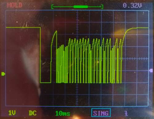

  const int LowOrHighPoint = 1050;            //Turnover time point of low/high     High =(1500 - 1700)   Low = (400 - 600)   So we are right at the middle
  const int TimeOut = 2000;                   //Maximum time in microseconds of normal bits (it's to much time to be called high)
  const unsigned int start_bit = 4000;        //Minimum time in microseconds of startbit
  const int BeginAt = 17;                     //Real data begins here (the first real bit)
  const int TheLength = 16 + BeginAt;         //The length of the data we need. If a to long delay (1s) between '<' and '>' try lowering TheLength. If '<E1<E1' or more retrieved, try higher TheLength.

Image of the data (default HIGH)
