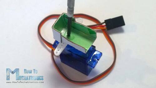

First I made a cardboard stand for connecting the Ultrasonic sensor to the Servo motor. I folded it like it’s shown on the picture below, glued it and secured to the servo motor using a screw like this.
Also I attached a pin header on which I soldered 4 jumper wires for connecting the sensor.
Finally I secured the servo motor to the Arduino Board using an elastic band.

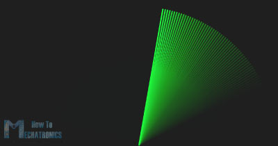

For drawing the line that is moving along the radar I made this function drawLine(). Its center of rotation is set with the translate() function and using the line() function in which the iAngle variable is used the line is redrawn for each degree.
void drawLine() {
pushMatrix();
strokeWeight(9);
stroke(30,250,60);
translate(960,1000); // moves the starting coordinats to new location
line(0,0,950cos(radians(iAngle)),-950sin(radians(iAngle))); // draws the line according to the angle
popMatrix();

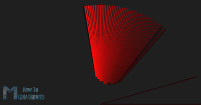

For drawing the detected objects I made this drawObject() function. It gets the distance from ultrasonic sensor, transforms it into pixels and in combination with the angle of the sensor draws the object on the radar.
void drawObject() {
pushMatrix();
strokeWeight(9);
stroke(255,10,10); // red color
pixsDistance = iDistance22.5; // covers the distance from the sensor from cm to pixels
// limiting the range to 40 cms
if(iDistance<40){
// draws the object according to the angle and the distance
line(pixsDistance
cos(radians(iAngle)),-pixsDistancesin(radians(iAngle)),950cos(radians(iAngle)),-950*sin(radians(iAngle)));
popMatrix();

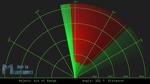

Here’s the final appearance of the radar:
