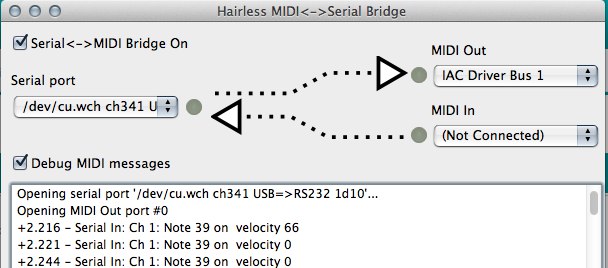

I changed my code according to this topic.
The problem is whenever I hit any piezo, it sends the 8th note (the last note from PadNote array) or sometimes any random note from the array. Is that because I don't use a ceramic capacitor?
Also attached the schematic. I highly apologize for this mess, but for now I don't have anything else.
More than likely.
Also are you using 1K resistors most circuits use 1M also you have no capacitor across your sensor like other circuits.

The diode is for shorting out the negitave transition from the piezos that can damage the Arduino or multiplex inputs. The capacitors are for holding the voltage that they produce to give the software time to get round to looking at that input.
For some reasons still doesn't work with a capacitor attached to positive and ground pins of 4051.
I receive 39 note triggered for most cases and rarely others (with no dependence on what note I want to trigger)
