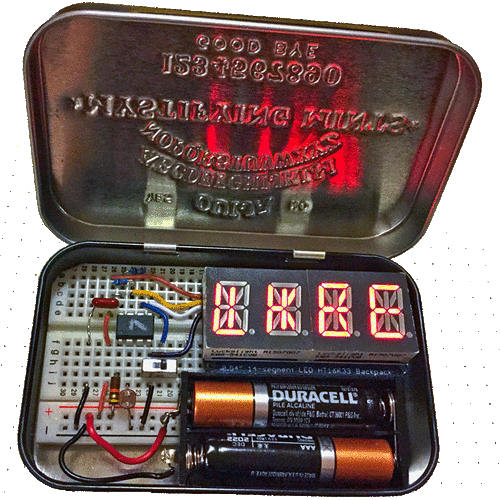

... the schematic:
... and of course, a picture of the actual device.
I would really appreciate any insight or comments any of you may have that I could use to 1) improve this device, and 2) expand and refine my abilities.
THANK YOU!
For appearance, I would find a piece of red plastic to cover the display so the inactive segments don't show.
paul
Great idea Paul! I have some deep red cellophane that should be perfect.
In person, the unlit segments are not as bright as they look here, I suspect they are retro reflecting the photo lighting. But the red filter will make the words snap.

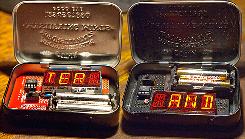

Update:
I made two of these, using slightly different software for each, but using the same general idea. The black version displays the I Ching, while the red version shows the magic 8 ball with an hourglass timer.
Thanks again everybody! I tried them all, and took some or your suggestions, but some did not pan out. Check the red gel over the LEDs - it really does improve the contrast substantially! I removed the reset resistor and I2C pullups, which seems to have improved the 'dark current' by a couple microamps. And I replaced the Duracells with other aaa batteries, which gives me the warm fuzzy of sticking it to the Man!
Oh, and I soldered them together, rather than using solderless breadboards:
