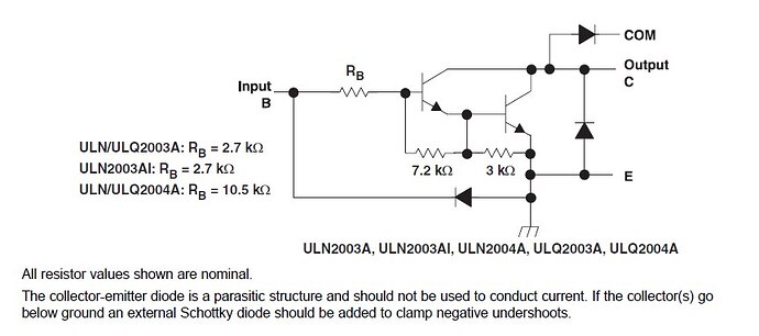

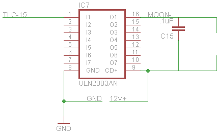

Because I am nervous of connecting 140V by accident to my Arduino (or across the USB somehow and breaking my iMac) I'd like to ask for a little advice on a simple test circuit to show the bar fully lit, and also another to allow me to control the "bar" on the IN-13 using my Uno.

Pancake - thank you for those diagrams. I'll have to try and source one of those transistors. I had a rummage and noticed that I do have a K155NA1 8910 chip that I think is an equivalent to the SN74141:
Is this of any use, or will I still need the transistor?

That IC is for turning on/off segments of Nixie tubes or VFDs.
Running the beam in the indicator tube is a different matter.
The transistor is required.
