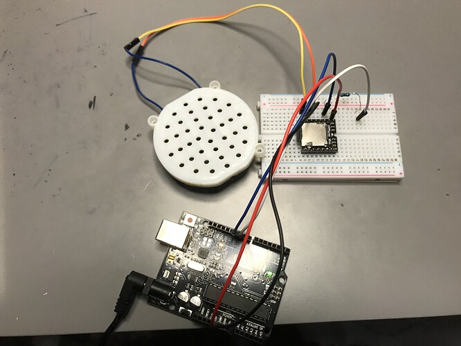

My dfplayer worked just a few weeks ago, but then I left it alone to work on another project and now it doesn't work. The dfplayer's led light does not come on at all. (It should come on, right?) I do get some static when I connect/disconnect the ground or power pins, but that's all.
So, I went back to the basics to test everything.
I am using a simple schematic (attached). White wire (RX) is pin 10 with 1k resistor. Blue wire (TX) is pin 11.
And the GetStarted code from DFRobotDFPlayerMini:

My multimeter says the arduino is putting out 3.8V.
The Serial Monitor says:
DFRobot DFPlayer Mini Demo
Initializing DFPlayer ... (May take 3~5 seconds)
Unable to begin:
1.Please recheck the connection!
2.Please insert the SD card!
I have 2 dfplayer modules and neither works. The micro SD has a mp3 folder with 1 file: 0001.mp3
This all worked perfectly just 2 weeks ago!! What am I missing?

I've tried 3 different breadboards, 3 different arduino UNO's (clones), 2 different dfplayers and I've even connected female pins directly to the dfplayer pins... no luck.
What's the easiest way to make sure the dfplayers aren't fried?
Aaaaarrrggghh!!! I figured it out... how stupid of me!
Never assume anything! There were 2 things wrong:
  • I was using the wrong sd card. (I could have sworn I had put the right one in.)
  • The RX and TX pins were backwards. Again, I could have sworn that the RX pin from dfplayer should be in the 10 slot, but nope. The TX should be in 10, RX in 11.

A TX pin can be an input or an output depending on how the equipment is classified. Same goes for the RX pin. But you must always connect an input to an output. So that means sometimes connecting a TX to an RX and sometimes connecting a TX to a TX.
Confuses the heck out of me even after 50 years.
