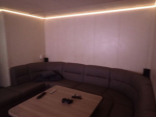

Hello everyone,
thank you in advance for taking the time to read and answer my question. Mainly I am a forum lurker, not a contributor. I have experience in electrics, less so in programming. But I can`t seem to find the correct solution to my problem, so I have decided to ask it here.
The project:
I have 14 meters of 24V led strip dimmable through arduino. The led strips are being fed halfway at both sides ( so at 7 meters) which is enough.
Led strip specs: 18W/m, 24V, CV.
Schematic:
note: the mosfet is capable of handling 5V TTL logic to switch. The led strips are CV, and have resistors built in. So the load on the mosfet isnt drawed correctly, it includes resistors.

First of all, this circuit works. It does what it should, it sends PWM to the led strip, I can dim it.
My problem is, that it flickers alot. Due to my overkill, I am dimming it alot, with very low duty cycles.
These are scope measurements on the gate and the output. Gate switches on 5V (channel B), output is 24V (channel A). The top measurement shows the led strips on minimum PWM, where they flicker alot.
Flickering is visible as 50-60Hz somewhere, although not sure of that. It becomes alot less visible with higher PWM, but is still present.
I realise there is a minimum duty cycle for the leds. This can be configured in the project when necessary, I am not talking about this ( the min PWM moment is shortly visible in the video).
video from the led lighting

I think this is a current problem. My voltage is a good PWM, but the current isnt constant and enough for the led strips.
Does anyone have any suggestions? I am thinking of remaking it with a constant voltage, but this has its inherent drawbacks as well...
