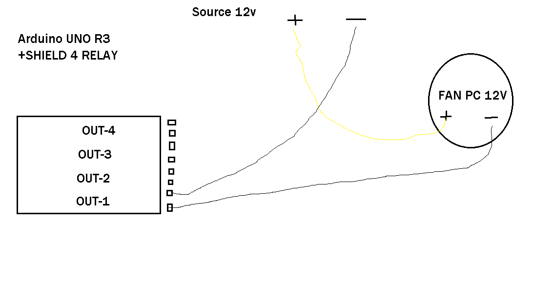

Hello I have an arduino uno, a shield 4 relays for controlling a motor in 2 directions by voice command, so I first wanted to try to run the relay without voice control with LED or a 12v fan pc, nothing works, I have the 12 volt external power required, one for the fan but nothing, I'm the click of the 4 relays with this code:

Read the how to use this forum sticky post. Then edit that first post to put the code in code tags.
Then post a schematic, not a Fritzing layout abortion, of your circuit. Pen and paper to draw it is fine.
Thank you for the answer, I tried to do what I could for the schematic ,for information to the shield 4 relay is mounted directly on Arduino and has a power supply unit 12 dc. Best regards
So where is it?
Sorry but that doesn't describe anything precise enough to be useful.
Grumpy_Mike:
So where is it?
the schematic is attached with the message
The shield is MR007-002.
Best regards
What is missing is the labelling on the relay output. The wires you should be using will be called common and N/O for normally open.
If the fan still will not go on when the relay clicks then it is not wired as your diagram.

Good evening, the shield 4 relay has 2 pins on each trip, I just program the relay 3 to 4 seconds of contact, and 2 seconds of opening, I mean well over except that the 2-pin OUT-3 I n 'have anything that comes out the multimeter, what to do?

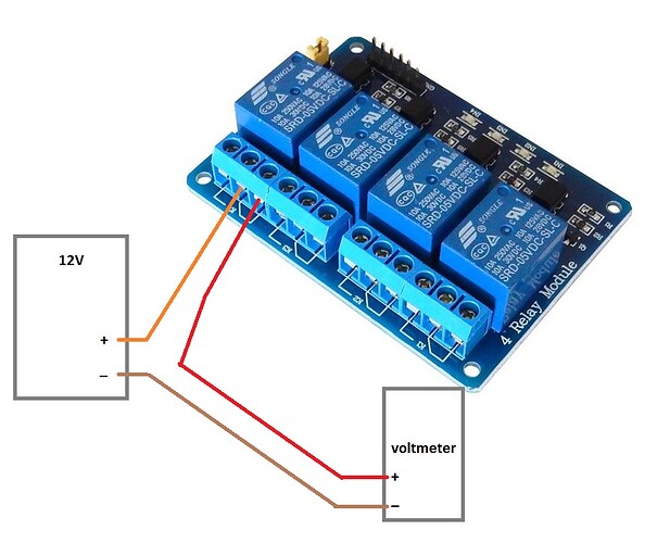

The attached drawing shows an example using Relay_4 of a 4-relay board.
Link to the MR007-002 shield.
Note there's a "Run/Prog" switch ... did you put it back in "Run" mode after programming?
Looks like there's only 2 terminals per relay ... probably NO and COM.
Just connect 12V to one terminal and the fan +12V wire to the other.
The relay board needs power, the Arduino needs power and the fan needs switched power ... show us a diagram/sketch of your connections.

Just like you showed on your origional diagram you posted. Make sure the connection are for the relay you are switching. Test this with the continuity setting of your meter.
Yeah, Just like you showed on your original diagram you posted.
HELLO in fact, it was the tension that was not 12v , now here is the code that works but I would put a timer to turn off the relay , thank you to answer me . Best regards
