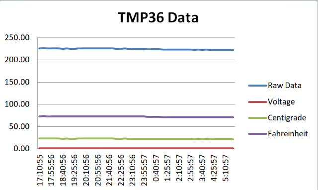

The code was adapted from this [adafruit tutorial](Using a Temp Sensor | TMP36 Temperature Sensor | Adafruit Learning System --) and originally used a voltage offset of 0.5 V. This gave the following overnight output
which shows, effectively, no temperature variation (and the temperature higher than it was,
When I checked the TMP36 Datasheet I found the Output Voltage listed as 0.75 V so I adjusted the code as shown above. Sadly, this gives the following output

This is Perth, Western Australia in high summer and I can assure you that it is not that cold :slight_smile:
How do I get an accurate output?

I am still trying to get as accurate a temperature reading as possible from the TMP36. The current configuration is
and the circuit is
and the code is

As you'll see in line 66 I am using EXTERNAL analog reference which is defined in line 21 as 3.27 V.
No, studying Fig 6 0n page 5 of the TMP36 Datasheet I noticed that the Vout (at 3 V Vin) for the TMP36 at 0 degrees Celsius is a little more that 0.5.
so I cast a TMP36 in ice and tweaked the offset to a value of 0.53 (line 27) which gave a temperature reading of zero degrees Celsius. Dipping the TMP36 in hot water less than a minute from boiling in the kettle gave me a reading of 98 degrees Celsius, so I decided the offset must be somewhere near right. What can possibly go wrong?
Running my program gives me a temperature of 25.9 C when my store-bought desktop thermometer (yesterday) tells me it's 27.9 C.
Who do I trust, and how do I adjust my program?
