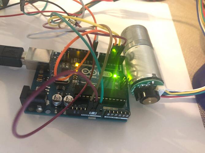

I am using a 12V DC motor with a quadrature encoder. I do not know the specs and neither do my colleagues. We have this project going on and we are using this old spare motor we have. What I am working on is designing this spool system that will be attached on the base of the robot, the spool itself should reel out a specific amount of wire controlled by either the revolution or the counts per revolution. I got a code, with PID as that's what we wanted, that reads the counts for continuous rotation in one direction depends on what I put in the code lines for that specific section. I am using a Pololu G2 High-Power Motor Driver 24v21 to drive the motor. Additionally I'd like to have something that'll be easy to turn it on and off and switch direction with i.e let's say press 5 on keyboard to start and 6 to stop when I read it from Python. So any help or ideas would be appreciated.
Keep in mind that I'd like to later on test it with Python as the robot runs on python, so I'll have to send data.

Sorry, this is my first time posting here. Thank you for the tips to improve my future posting.
So the sketch_full basically runs the motor continuously 360 degrees until I unplug the power supply and while it is running I am reading the encoder counts throughout the rotation. Nothing more than that. If I change the (dir,HIGH) to (dir,LOW) in the void loop and re-run it, it'll just read the counts and rotates the motor in the opposite direction.
The sketch_encoder_counts runs the motor from 0 up to the point where the pwm hits 255 and goes back down to 0. The counter works only for one rotation though, it cannot read the counts when the shaft changes directions.

Yes, the direction is depending on whether the dir pin is set on HIGH or LOW. That part of the code is actually not changing the direction, it keeps going. If I want to change the direction, I have to manually switch the HIGH to LOW.
My question should've been, sorry for not clarifying in the beginning - been a long week, now that I have this working I want to add in a few lines of code in this existing code that'll rotate the shaft 5-7 revolutions only and for me to be able to start/stop it and reverse with the press of a button on the keyboard.
I have been trying to find the pulses per revolution but I can't seem to get them with my codes. The codes I've used only reads the encoder counts as the shaft is rotating, I'd might have to mark it and time it manually as I have no specs of the motor except that it's 12V.
The final goal is to attach the motor to a spool so that I can reel in and out a line with a fixed # of revolutions.
Hope this clears it up a bit.
