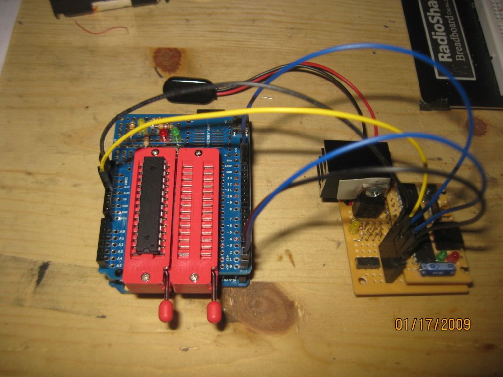

Here's my little programming deal hooked up:
In the pic the chip is in the Arduino but I have to remove it in order to program the bot.
I have 10 pins broken out and the way the bot is now I only need 5 so I can maybe add some functions in the future.
If all the electronics check out OK I'm going to redo the chassis and give him a shorter wheel base. I'm hoping that will help the tread throwing problems by (hopefully) reducing the side loading on the tracks when turning.
