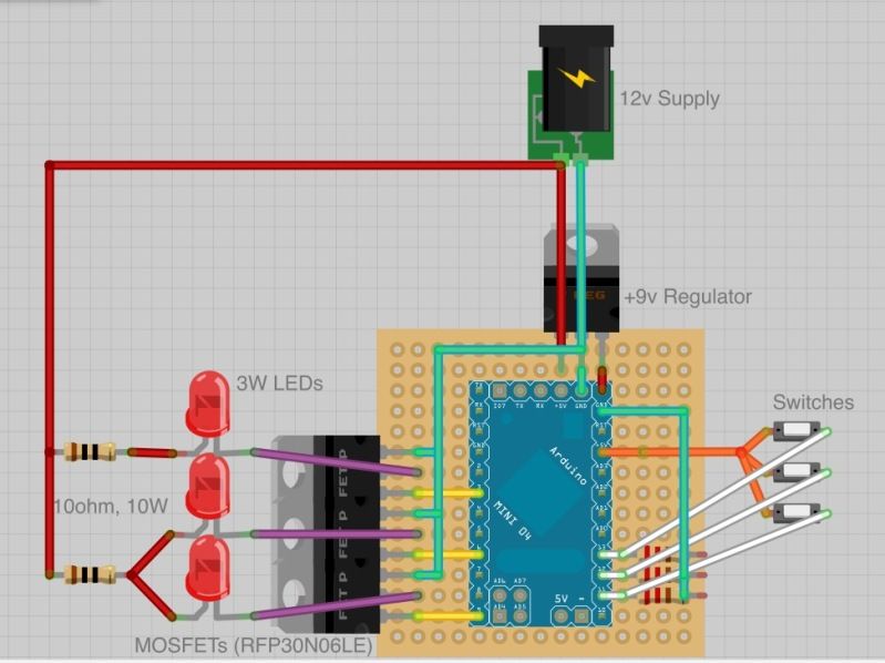

Here is my circuit:
Ideally, I will use this circuit to control the brake light and blinkers of my motorcycle (code I wrote seen here: http://arduino.cc/forum/index.php/topic,62948.0.html)
Arduino will monitor the switches, each of which triggers one of the three LEDs. The LEDs are controlled via PWM through MOSFETs. MOSFETs are needed because each LED is rated at 3W. The voltage regulators are used to step down the 12v from the battery to the 5v required by the LEDs.
My problem is that the regulators are using way too much power and getting way too hot: Each regulator/LED is drawing nearly 2A, and the regulator climbs to 130*F in about 20seconds. Also, the regulators start out producing 5v, but almost instantly jump to over 7v and slowly climb to above 9v* before I turn off power to keep the regulator from overheating. In this scenario, the regulator Input-Ground current is 0.002A @12v. These parameters are also replicated when the regulator/LED are wired up directly to the 12v source (independent of the the above illustrated circuit.)
What am I doing wrong? How can I fix this? Is there a better way to drop voltage from 12v to the required 5v? Thanks!
*Edit: I am a bonehead. I was measuring voltage across Input-Output instead of Output-Ground. The regulators work properly, they just get very hot and draw too much power. The solution was to use a resistor. Details below.

Here is my test circuit that is producing the same electrical characteristics as seen in the full circuit seen above.
Title: Re: Voltage Regulators wasting too much power, or "Ouch! Dang that's hot!"
Post by: CrossRoads on Feb 16, 2013, 04:52 am
Yep, still no current limiting there.

Roger that. I'll build this circuit then: http://www.instructables.com/id/Power-LED-s---simplest-light-with-constant-current/
Post by: loudboy on Feb 18, 2013, 09:01 pm
Alright, Fungus, I followed your advice and it worked! (as math should)
I replaced the voltage regulator with a 10ohm, 10W ceramic resistor (http://www.radioshack.com/product/index.jsp?productId=12566075), and it works beautifully! With a supply of 12v, the circuit now draws 0.8A, with about 4v across the LED. The LED is just as bright as ever. The resistor does get very hot though (165*F).
The new circuit:
The middle and bottom LED can share a resistor because only one can be on at a time (they are the blinkers, and there is no "Hazard" dual flash setting)
Also, I realized that I was having a major bonehead moment when measuring the voltage across my regulators as stated in my first post: I was measuring Output to Input, instead of Output to Ground (d'oh!)
Thanks for the help! As usual, I should remember to K.I.S.S.!
