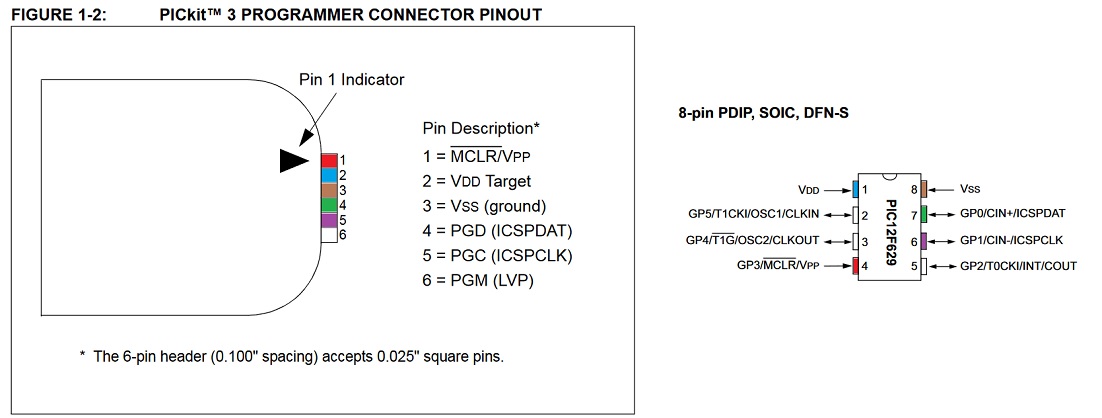

Some notes on the CIC stuff.
The most compatible version of the lock seems to be the snesCIC.  I've been getting the best results using the snescic-lock-resync version.  Get the ASM & HEX here:  https://github.com/mrehkopf/sd2snes/blob/develop/cic/
Code: [Select]
;   snesCIC LOCK 12F629
;   pin configuration: (cartridge slot pin) [original 18-pin SMD lock CIC pin]
;                       ,---_---.
;      +5V (27,58) [18] |1     8| GND (5,36) [9]
;      CIC clk (56) [7] |2     7| CIC data i/o 0 (55) [1]
;   host reset out [10] |3     6| CIC data i/o 1 (24) [2]
; CIC lock reset in [8] |4     5| CIC slave reset out (25) [11]
You wire up the snesCIC to the Cart Pins 24, 25, 55, 56.  Connect CIC Pin 2 and Cart Pin 56 both to the clock generator outputting 3.072MHz.  I also connected Host Reset (CIC Pin 3) and CIC Lock Reset (CIC Pin 4) to available pins on the Mega 2560.
The snesCIC has specific timing built into the code for the CIC LOCK-KEY to work.  We need to set up our code to make sure the LOCK-KEY works right.  Since the snesCIC has the correct timing, we need to trigger the code at the right time using the CIC Lock Reset.  When CIC Lock Reset is HIGH then it is in reset, when LOW it is running the CIC code.
In our Arduino setup(), we immediately set CIC Lock Reset HIGH otherwise the LOCK-KEY communication may fail.  Pulling CIC Lock Reset HIGH gives us time to get everything else that is connected to the Arduino up and running before trying the CIC handshake.  We let most everything initialize in setup() then we set CIC Lock Reset LOW to start the CIC code and hopefully get a valid connection to the cart.
After making the changes to setup(), the SA-1 carts get recognized most of the time now.  For when the cart is not recognized, I added a soft_Reset() "jmp 0" to reset the reader and start over.  I've dumped all of my SA-1 carts except for one problem cart, PGA European Tour.  I don't know what is different about the cart but it only spits out 0x17s right now.
EDIT:  I managed to get the problematic PGA European Tour to dump. I put the cart in the SNES and let it run for a little bit then moved it over to the reader and dumped it.  I'm still not sure what makes this cart fail.  I'll have to look at the SA-1 registers to see what is there.

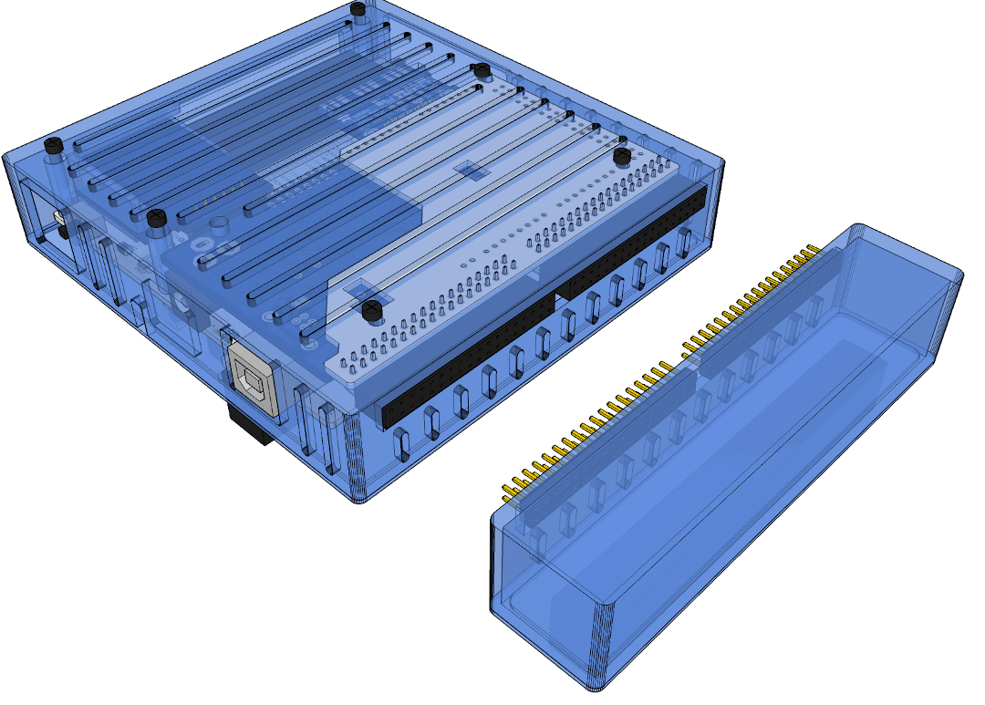

Just seen this, looks amazing  :)
http://64drive.retroactive.be/ultrasave.php (http://64drive.retroactive.be/ultrasave.php)
A little case like that for our Arduino cartreader would be cool.

I've been playing around with a new pcb design that integrates the N64 adapter into the main pcb.
Makes everything look a little bit nicer. Featurewise it's the same as before and also uses the same parts.
It does need a bottom plate though since the N64 part of the pcb overhangs the Arduino quite a bit.

Post by: Pickle136 on Jul 14, 2016, 01:29 pm
is snescic-lock-resync.hex the correct file to flash to the PIC12629?
Title: Re: ROM-Reader for Super Nintendo / Super Famicom Game Cartridges
Post by: sanni on Jul 14, 2016, 03:51 pm
Yes the snescic-lock-resync.hex on my github page under extras is the exact file I'm always flashing to the PIC12629.

Have you seen this post by Pickle136 already:
I have 9 extra pcb boards for the original layout. If anyone needs one I am selling them for $2 + shipping apiece.
It's the earlier variant of the pcb, the one with the smaller SNES cart reader shield and the additional N64 adapter compared to my new version that has both SNES + N64 combined on a larger cart reader shield.
But the only difference between the two hardware designs is that the second design looks nicer. Functionally they are the same.
I'll also make some more kits of the second hardware version soonish if you want to wait.

Post by: sanni on Jan 18, 2017, 04:46 pm
Tried out a 3d printed backplate:

The Retrode is 16x8x4cm=512cm³ and my current cart reader design is 10x10x4cm=400cm³.
Therefore I'd argue it already is smaller by volume. :smiley-small:  :D
Ofc the Retrode can do a lot more things like you can plug SNES controllers in it, so it needs to be bigger :smiley-cool:
Now if the question is "What is the cheapest way possible to build this Cart Reader?", then the answer to that would be the following item list:
- Arduino Mega2560 (http://www.ebay.it/itm/152505189714) 8€
- Prototype PCB (http://www.ebay.it/itm/201205316404) 5€
- SNES slot from a broken Action Replay or import adapter (http://www.ebay.it/itm/292060882817) 6€
- SD module (http://www.ebay.it/itm/141976857662) 1€
You don't need the OLED screen because you can just use the Arduino Serial Monitor to display all the information.
That's about 20€ in total.
Then just hand wire everything according to this pinout (https://github.com/sanni/cartreader/blob/master/pinout.xls?raw=true).
For the N64 or Gameboy adapter you can just use the pcbs of some cheap SNES game and wire the appropriate cartridge slot to it, again using the pinout from the Excel file.
Just be aware that hand wiring everything can lead to wiring errors really easy.
I don't have any pictures of my earlier hand wired prototypes anymore but here is a fun picture I once made that shows different stages of the cart reader:

My newest iteration combines the SNES, Megadrive, N64 and GBA/GBC slots into one unit ... but don't plug them in all at the same time  :smiley-lol:
There is now only one USB port, the one from the Arduino Mega. The barrel plug serves no purpose anymore.
To achieve 3.3V for N64 and GBA a little pcb, pictured in the top right corner, gets soldered to the Arduino Mega that can convert it to 3.3V following the Adafruit tutorial (https://learn.adafruit.com/arduino-tips-tricks-and-techniques/3-3v-conversion).
