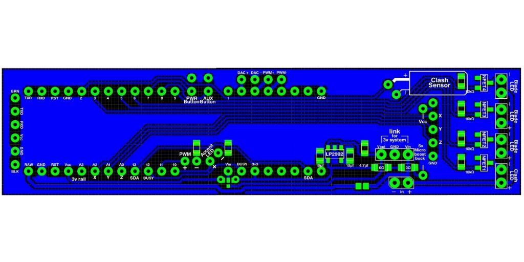

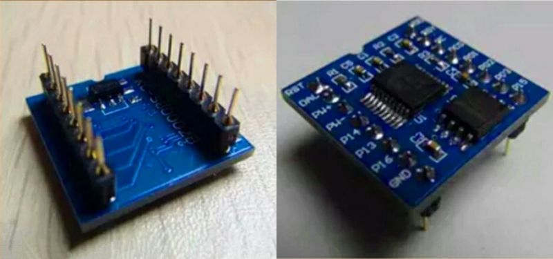

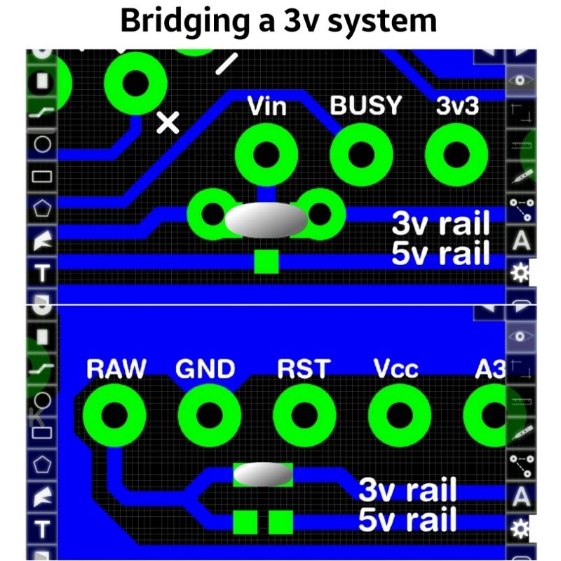

Hi, all. I used an Arduino Pro Mini 3.3V and a WT588d to create a custom sound board and LED controller for my lightsaber. I love this little board. Special thanks to SugarBombs for sharing his working code for the WT588d module! WT588D-16P Sound Module Working Code - Audio - Arduino Forum That really saved me some trouble.
Here are video and pics.

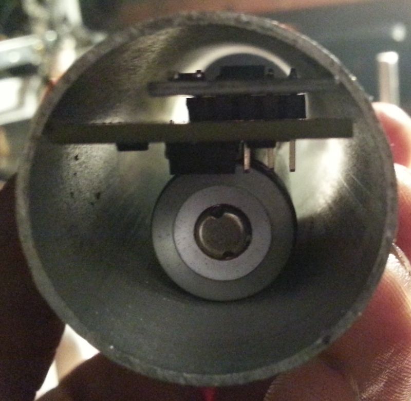

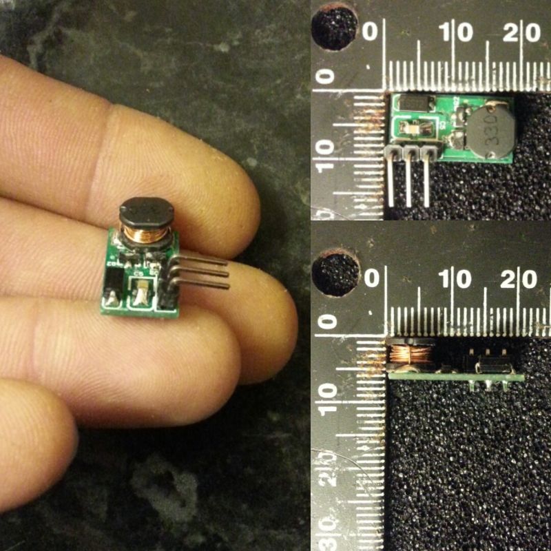

Core IC components: Arduino Pro Mini 3.3V, WT588d sound module, some small MOSFETs, and a 5V regulator.
Components mounted on some perf-board and inside the hilt.

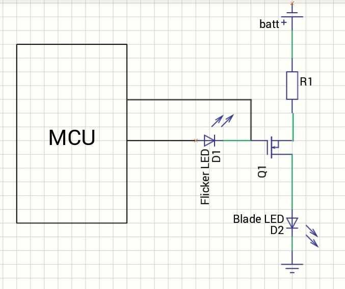

Thanks! I am willing to share the design, but I don't have anything that is easy to share digitally; only hand-done drawings in a paper notebook. Give me some time to put something together.
Usually we don't have schematic capture software and most of us hate Fritzing because it is not a schematic so what we do is just take photos of the hand drawn stuff and post the photos. My cell phone camera is 8 Mega pixels so it is more than clear enough. I mean let's be realistic here. The guy just cares about how to build it, not how pretty the schematics are. If all the information is there I would say just put it out there as photos, and leave at that.

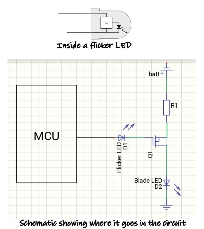

I made an attempt to transfer the most useful drawing from my notebook. I don't have a good program at home for drawing schematics, so please excuse the crudeness of it.
Not shown are the bits where the N-channel MOSFETs are used to switch the main LEDs. That part is pretty straight forward, though. I hope this helps. If you build it, post up here; I'd love to see what somebody else does with it.

Depending on the color, max current on these kinds of LEDs can range from 700mA to 1500mA. You shouldn't have a problem finding FETs to handle that. Mine are rated for something like 18 amps!
Also, I am noticing I made an error on the diagram. The negative for the WT588d should be on the far left pin at the top, not the right. I'll try to get a fix up for that tonight when I get some time.

I corrected the schematic in a previous post.
Roger that.
Schematic in Reply#6 corrected.

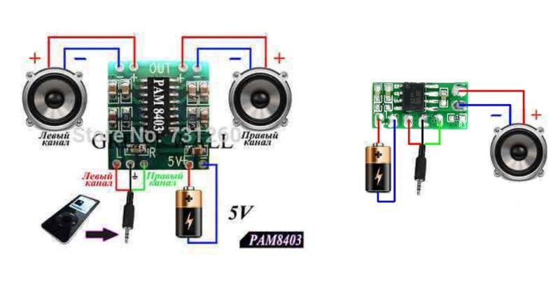

What speakers did you use? (8ohm 0.5watt?)
How many db did you get? (It seems as loud as a smartphone on full volume)
On your schematic you didn't use any amplifier, right?
