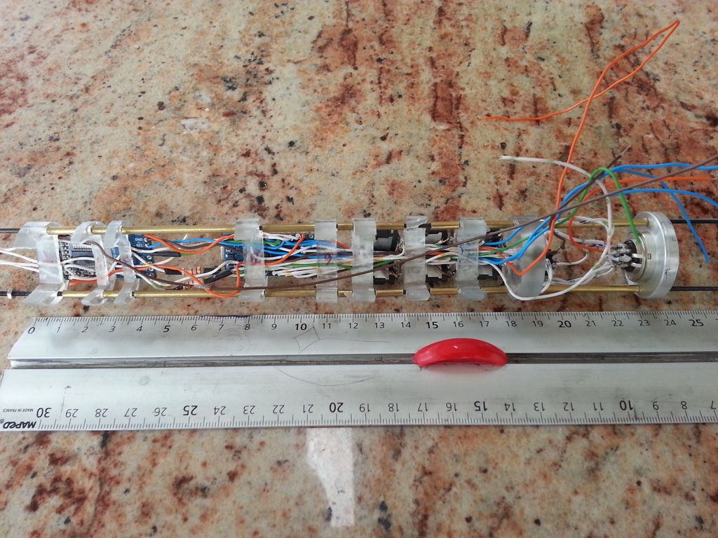

Hi fellow Arduino developers!
After nearly a year of planning, designing, coding and a lot of research in different Arduino related forums I finally finished the first fully working prototype of an Arduino saber for LED string blades.
First of all I would like to thank this great community here for the invaluable support and help in all facets of the development from hardware design through benchmarking to software coding, greatly appreciated! Without the insight you provided this project could not have happened! But it did!
Special thanks to JakeSoft who developed the first Arduino saber for his motivation and hints throughout the development process.
Some words to LED string sabers: if you remember the Star Wars films, you might recall how lightsabers extend when activated and retract when switched off. To better simulate this effect, blades can be build with multiple segments of LED strings, which can be individually controlled by the circuitry. Such lightsaber replicas differ from the so called high power LED implementation, in which the blade is lighted up from below by a single or multiple high power LED dies situated in the hilt of the lightsaber replica.
I started this project after a couple of years gearing up, modifying and building together prop lightsabers. From the beginning I felt attracted to LED string sabers, and looking at the available electronics on the market, I concluded that in certain respects I can do it better. I also set an ambitious goal: implement all features available to high-end lightsaber circuits, with some improvements in the finetuning of the LED segment drives.
The harware can be seen on the following pic (I will create a schemtics and a better description later on):
(http://s1035.photobucket.com/user/Kunci1/media/kicsi00008_zpsjuflnrs0.jpg.html)

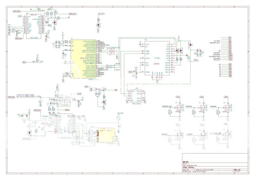

Post by: Protonerd on Nov 25, 2015, 04:01 pm
Thanks Crossroads for the suggestion, I downloaded ExpressPCB and made the circuit diagram (not polished yet, but shows everything what is important):
(http://s1035.photobucket.com/user/Kunci1/media/AS2_LEDstringSaberArduino_zpsxitdxh9o.png.html)
I will add a more detailed description to the modules and why I choose them tomorrow once I got some sleep :)

Post by: chivotenkai on Nov 26, 2015, 09:42 am
A spectacular job.
I'm also making a lightsaber with Arduino ( 80x 5mm green leds, WT5001M02-28P U-disk audio, ultrafire 3,7v 6000mAh x2 batteries)
I have seen the circuit and have a question:
The LEDs are separated by segments which are activated with Arduino through a mosfet transistor...
But... when a part of string is activated.. it's  reciving 7,4V?
Is not necessary to use a regulator or resistance to prevent damage?
Title: Re: Arduino Lightsaber for/with LED string blade
Post by: Protonerd on Nov 26, 2015, 01:32 pm
Hi chivotenkai,
Good luck for your project, it's a worthy one!
As to your question: for that there is a technique to serially connect LED's. That means: I have currently 2 LED string blades, one red and one blue. The blue LED's have 3.4V typ threshold, if you connect 2 in series, you can have 6.8V across them. Actually what I did was to put 2 sets of 5 parallel connected LEDs in series. Advantage: no need for resistances to bring down your voltage, nor for a voltage regulator. The small difference of 0.6V can be managed by the LED's, but you can also adjust the MOS transistor drive to remove the surplus voltage from the LEDs. With the red blade it's even a 3x5 so called serial III. class setup. Big advantage is also that your current consumption will be halved -> longer active time of the saber.
Regarding the WT5001, I also tried that (I will write about it later, that took the longest time to evaluate 3 different mp3 moduls), but I never managed to have a gapless playback, which is essential for realistic saber sounds. The 3rd module I tried was the same used by Jakesoft (WT588D), well I also did not have any luck with that, but he did, so at least it's proven to be able to do that.
I can only suggest to keep the DFPlayer in mind for later...
May I know which batteries you found? 6000mAh capa is tremendous! I also want them...provided they are not too big. In my Arduino saber, or more specifically in the hilt I put in the module I found only enough room for 2x10440, which have only a meagre 350mAh.

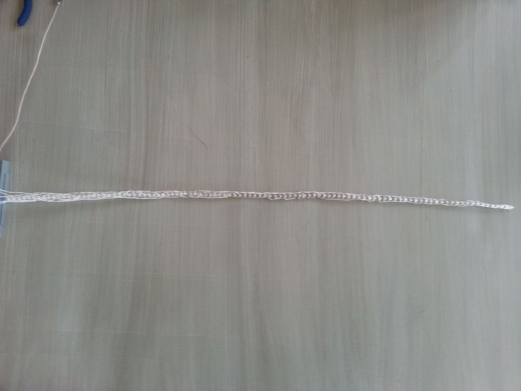

Wow, impressive brightness. I take you used green LED's (from the background color, because the string is so bright the camera shows only a glowing white). Greens are anyway the brightest of all LED colors.
How do you lock the LED segments in place? Do you use a stiffener? Or wrap them all in foil/shrink tube?
Post by: chivotenkai on Dec 04, 2015, 01:33 pm
sorry for answer late...
In the image... only the leds appear in the image.
for the creation of the string i used a similar metod of "Hampton's Hand-Crafted Lightsabers" channel.
But i change a little for make your circuit. I turn led for connect serial: if a string have 16 leds (8+8) in the middle for make the serial conection i solder de V- of the 8º Led to the V+ of the 9º Led.
Next, I Cut the V- of the 9º Led and i use that new space to solder the cable... that cable its directly going to the mosfet. Repeat the process in all strings. If you make 5 strings you have:
5 cables for V-
1 "special" for V+... I use only a cable but i cut it many times for using less space.... conecting the V+ when it have the 7.4V with the next string

Post by: Protonerd on Dec 14, 2015, 02:06 pm
integra386, good luck!
As to the 96 leds, why not, I also have integrated 6x3x5=90 in my red blade and 6x2x8=96 in my blue blade.
As to the resistors or not: for a red blade with serial II. technic (2 LEDs in series), you need the resistors, otherwise you will have a very narrow band to control your transistors -> effects will be less spectacular. Not to mention that not all small transistors can tolerate the power dissipated over them.
Better is to use a serial III. setup, then you do not need the resistors. 2.2V*3=6.6V, you only need to dissipate max. 8.2V-6.6V=1.6V over the MOSFET. If you insist on the serial II., then you need the resistors.
BTW, looking at your schematics, please do not forget the pull-down resistors from transistor gate to GND, otherwise you will have floating gate and you cannot control switch on/off (all LEDs will always be somehow in a random on state).
Post by: integra386 on Dec 14, 2015, 04:35 pm
Protonerd thanks for the reply .... then I will make from 96 to 90 LED ... 6 x ( 3 x 5 ) .
I updated again the scheme ... now should be correct .

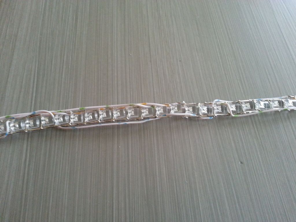

I will use the Makoto's tecnique but I will use a small jig to bend the LED's leads, created with 3D printer.

@integra386: I dig your jig, awesome, you are really in for a professional lightsaber!
I used the same arm buddies method to link the LED's, mostly using household utensils instead of a jig, see my old thread here:

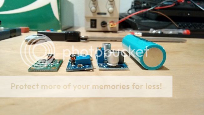

To not have as many cables inside the blade, I ordered from SMD resistors 2w (same size as 1w ... but more is better) that i'ss weld directly on the LED, so I'll keep only one positive cable.

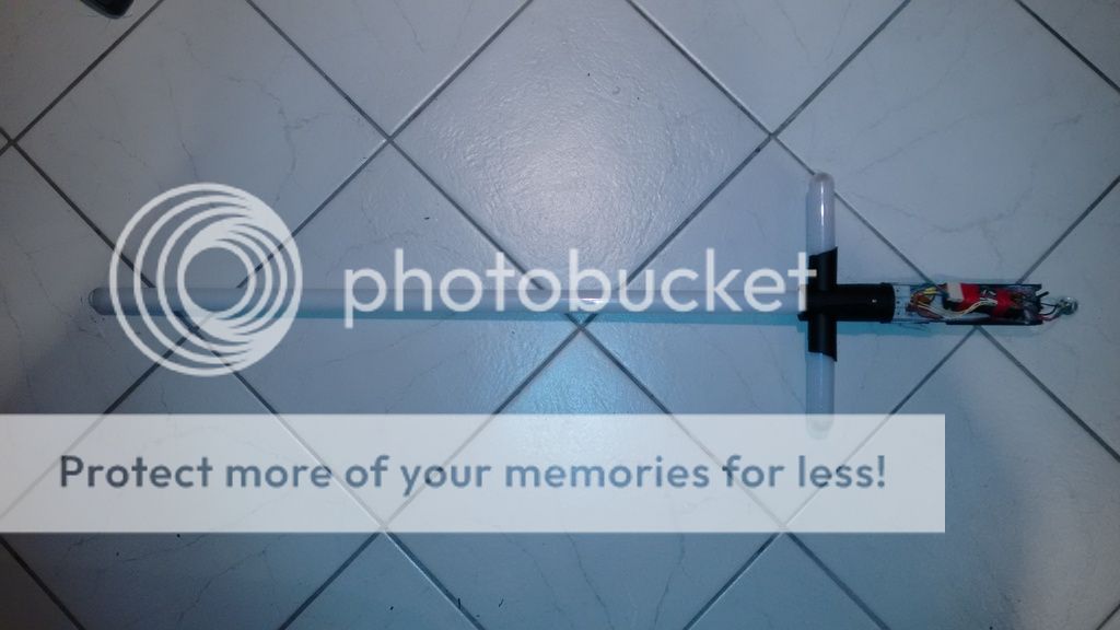

Since the 15th, I had completed electronic ... but when I was to assemble all in the grip ..
the audio module .. was broken ( i dont know the reason)
so I am waiting for me to get the new module .
However since I have almost finished hilt.

I'm personnaly in the process of assembling my green led string segments (seriallell II type) . I've done 4 segment so far (but ruined half a segment by being to hard when bending led pins :P).
I have a question regarding building the blade :
How do you fasten the segments between each other to get a quite stiff led string?
Still waiting for my arduinos components to be delivered.
Ohh and by the way : Happy new year to everyone !

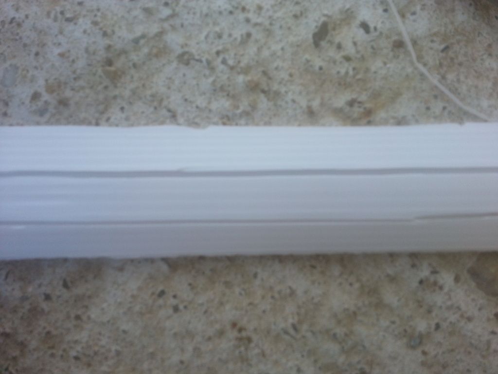

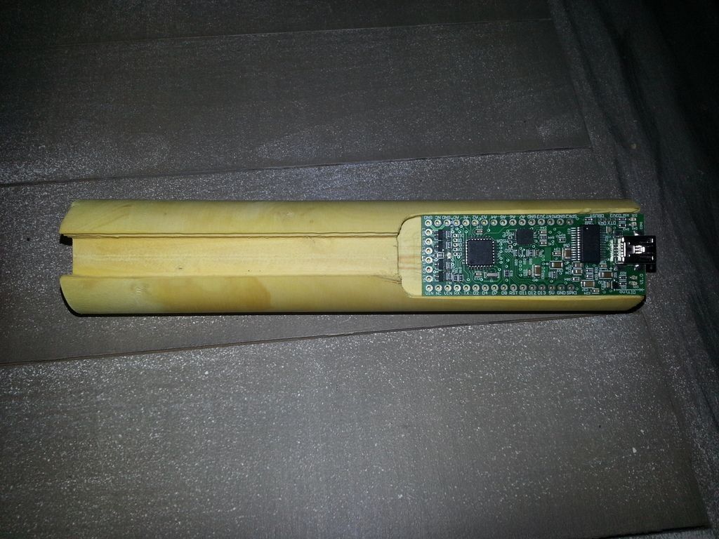

Post by: chivotenkai on Jan 03, 2016, 03:50 pm
neskweek  , my metod is similar of this video (but if you want to make the ignition effect you must make a little change)
https://www.youtube.com/watch?v=_tw0pD8LPtw

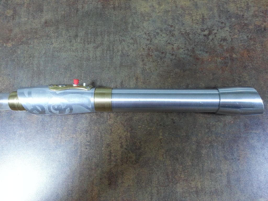

racemaniac, for the hilt i used a Pvc pipe 32 mm  and i used a tool to cut an a pipe accesory to make the rings.... when the saber is completed, i want to make a fast tutorial

You can look here for a build log of a LED string saber:
http://forums.thecustomsabershop.com/showthread.php?16889-My-first-LED-string-blade-a-progress-diary
Only thing I would change is that the shrink tube should be used only to fasten the segments at the segment boundary for an inch or so. Putting the whole blade into the shrink tube makes it impossible to maintain and that is something you have to do on a regular basis.

Thanks for the fasten tips.
I'll finally go with the method found here :
http://www.fx-sabers.com/forum/index.php?topic=40348.msg540966#msg540966
I'll then wrap the whole string with some cellophane.
I'll post a photo of the full fisrt string (the green one) when I'll complete it.

First led strip done !
OFF :
(http://s1073.photobucket.com/user/cest_bastien1/media/Lightsaber/IMG_20160116_114332_zpsomcryrjy.jpg.html)
ON:
(http://s1073.photobucket.com/user/cest_bastien1/media/Lightsaber/5c0eeea4-1b61-48fe-bb38-dc7554f5b112_zpsxywu0y8p.jpg.html)
Tested with a lux meter app on my android phone around 5400 lux, last night.
The mounting and soldering are not quite academic but that do the trick and the string is quite stiff by only enterlacing wires trought the led pins.
Next steps are :
- DIN soldering (still waiting for the connector)
- wrap it in diffusor material (polyurethane foam made for flooring isolation)
- put it in the blade and make a nice picture :)
Still waiting the Arduino Nano board to be delivered :(
Post by: Protonerd on Jan 18, 2016, 11:07 am
Looks awesome, good luck with the build! Did you put the whole string into a shrink tube, do I see it right?

Post by: neskweek on Jan 18, 2016, 04:22 pm

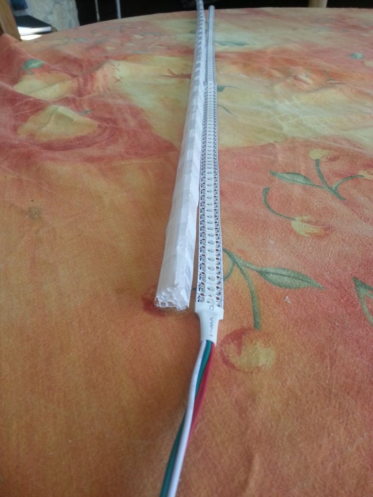

Nope, there's no shrink tube.
Only the wires holds everything in place.
Here is a close up of the upper part:
(http://s1073.photobucket.com/user/cest_bastien1/media/Lightsaber/IMG_20160118_161429_zpsnulu116b.jpg.html)

I decided it was time to move to the next level of Arduino based LED-string saber electronics, integrating everything discussed in this thread on one single PCB. I dubbed my future board:
DIYino
for 2 reasons:
- it's meant for DIY projects (obviously), but with this board my intention is to provide the possibility to build either LED-string sabers or sabers with high-power LED's. On top of that, since the board provides sound, light control (and motion detection), it can be used for a multitude of other projects as well (I plan an E11 blaster electronics as well, to stay with the SW theme).
- the Y also stays for the MP3 chipset YX5200-24SS
Here is the schematics I came up with after many weeks of research. It basically implements the same as my Arduino-based module:
- an Arduino-Nano-clone circuit
- a motion detection engine using the MPU-6050
- and the circuitry of the DFPLayer mini
- a MOSFET attached to each PWM-capable pin of the Atmega328P-AU (6pcs) to drive up to 6 strings or high-power LED's
(http://s1035.photobucket.com/user/Kunci1/media/DIYino_v1.0_LayoutSubmit_zpsdgiuq1ta.jpg.html)
I try to attach a PDF of the schematics, feedbacks and checks are warmly welcome, I'm now planning on starting the layouting and ordering the parts for the sample builds.
Target is to have a module size ~20mmx70mm, including mini-USB and SD card socket. So far the plans :)
Cheers!
Post by: CrossRoads on Jan 21, 2016, 06:20 pm
Suggestion: add more caps.
Atmega328: 0.1uf for each pin of VCC and AVCC - 3 total. I only see 1.
Ft232: Same, add more 0.1uF
UA78M05: "All characteristics are measured with a 0.33-μF capacitor across the input and a 0.1-μF capacitor across the output." I don't see any caps.
IC5: Same, add a 0.1F. will help with hum issues also.
Post by: Protonerd on Jan 22, 2016, 04:26 pm
Wow CrossRoads, actually I've been fervently hoping that you would chip in! Thanks a lot for the advice, I will make the updates.
Actually I based the Arduino part on the schematics found on the Arduino page:
https://www.arduino.cc/en/uploads/Main/ArduinoNano30Schematic.pdf
and realized just recently, that other than the link suggest this is the Nano v2.
I found an updated schematics for v3 on GitHub, and now I see that the v2 had some mistakes (actually I found one, the FTDI IC's Test pin must be connected to GND if unused, which is on the v3 schematics but not on the v2 on the Arduino site) and other external component values.
https://github.com/NashMicro/NashDuino/blob/master/Nano/ArduinoNano3_0schematic.pdf
I added suggested 100nF caps to UA78M05 and the IC5 audio amp, one on the VCC/VCCIO of the FTDI, as well as the 2 caps for LDO. As for the Atmega328 I opted to stay with the current caps, I fear that it will be the sheer number of external components that will dominate the board and dictate the size.
We discussed the topic of bootloader burning the other day. Currently I'm reluctant to plan in an ICSP header, due to limited space on the board and the fact that everyone removes them once it fulfilled its purpose. Instead I will try to use the same SPI pins from the sides, I hope it will work.
Schematics in PDF replaced.

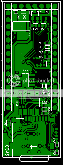

Post by: Protonerd on Jan 25, 2016, 05:24 pm
I made a sketch of how the placement on the PCB and the pin-out are going to look like. Any comments are welcome!!!
At this stage I know that the width of the PCB shall be between 20mm and 23mm (so a bit under 1"), approximately the same as the DFPlayer, which also have a standard pin header connectors (8 contact holes 0.1" apart).
The length is not fixed yet, it depends on the layout. There are 2 scenarios:
- pad/pin limited size: if the pins on the sides are too many and make the PCB much longer, then I will put only the most needed signals on the side, all the other pre-assigned signals (i.e. those which have a connection on the board, like the A4/A5 to the MPU or D8 to the YX5200-24SS) will be placed somewhere on the PCB, still accessible, but only on a need-to basis.
- if the placement/layout determines the size, I will try to put as many of the signals on the side rows as possible.
With regards to the pin assignment, I tried to follow the standard Arduino stile, with the MPU and DFPlayer related signals grouped at the bottom of the PCB.
Regarding the 2 big sockets (USB and micro-SD), the will be at the bottom of the PCB on the two sides respectively. I hope that is possible to mount that way.
(http://s1035.photobucket.com/user/Kunci1/media/DIYino_placement_v1_zpsvjuz00kw.jpg.html)
Post by: JakeSoft on Jan 25, 2016, 06:09 pm
Q1) What is your target power source? 3.7V? 6V? 7.4V?
Post by: Protonerd on Jan 26, 2016, 10:38 am
I leave it up to the user. I use them currently mainly with 7.4V (2x3.7V) setup, but a single 3.7V cell setup is also feasible, provided that the 5V is maintained, which could be done with a small boost.
I plan to play around with 3.7V supply wo/boost, but that needs a different external connection and I do not want to commit this option as of yet.

Post by: chivotenkai on Jan 30, 2016, 06:29 pm
https://www.youtube.com/watch?v=sgeXLru1uqI&feature=youtu.be (https://www.youtube.com/watch?v=sgeXLru1uqI&feature=youtu.be)
After waiting a long time, I have received audio module.
I decided not to use the accelerometer for certain reasons ....
I still have to add support for batteries (I have not received it yet), so the sword in the video is connected to a power supply
I hope you like the result
Post by: Protonerd on Jan 30, 2016, 10:52 pm
Amazing brightness, chivotenkai! And I love the ignition/retraction, feels like a real lightsaber! Keep posting your progress, it's gonna be a formidable lightsaber once finished.

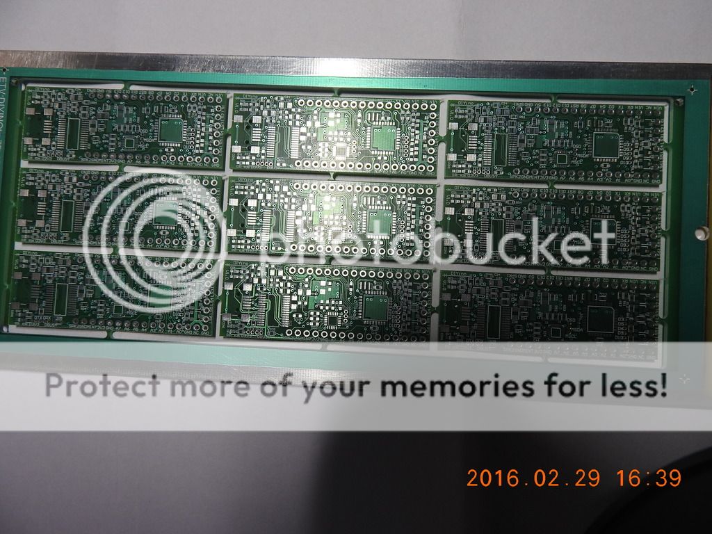

Post by: Protonerd on Feb 02, 2016, 04:32 pm

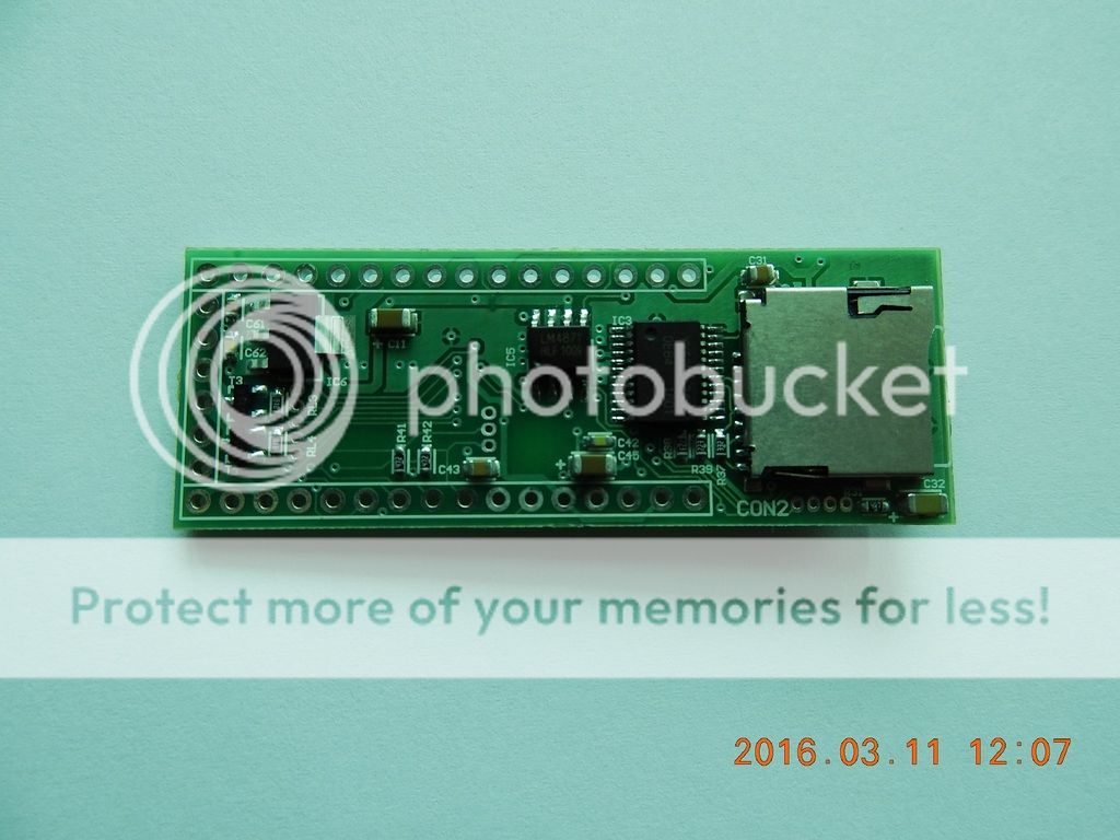

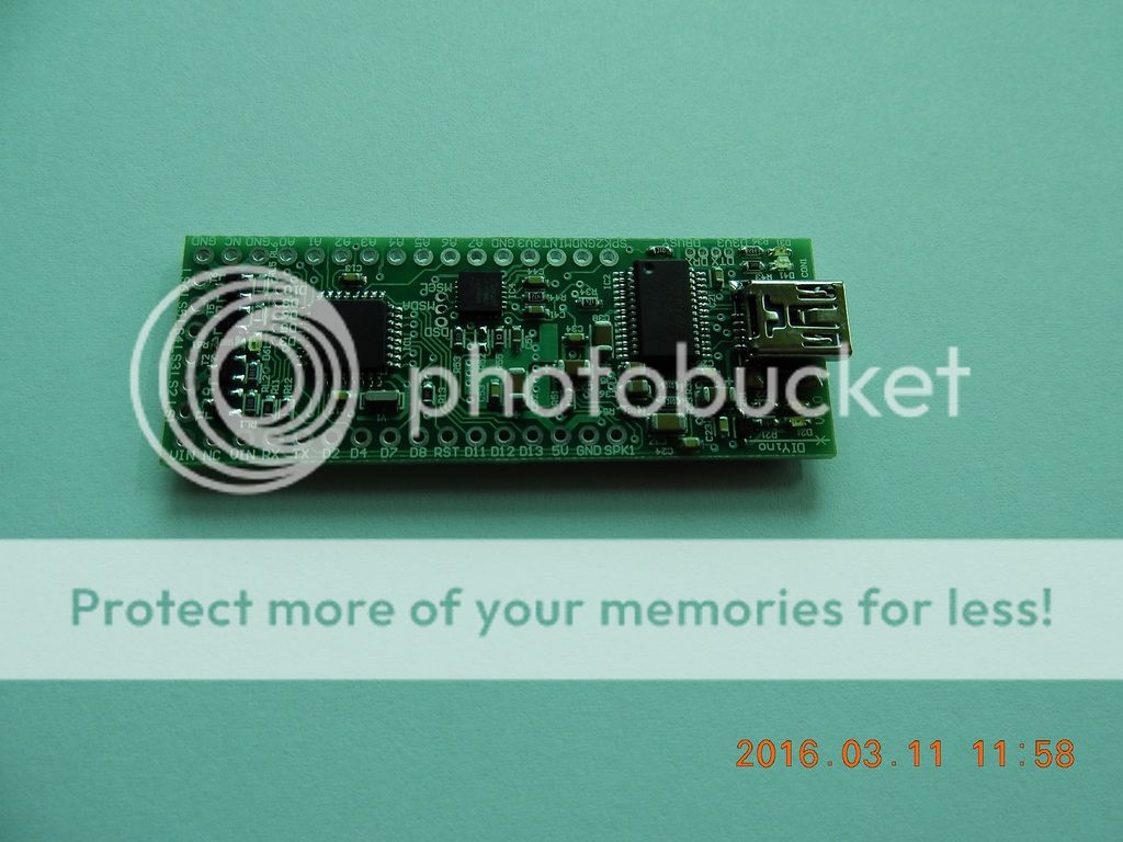

I made an update to the DIYino placement (see attachment), I reworked the pinout a bit and added an alternative placement for the SD-card holder.
The peripheral pinout signals will be compatible with the 0.1" pin connector type like other Arduino boards.
The yellow signals are secondary ones, they will get the smaller plated thru-hole and will be distributed over the layout as the layouter sees fit, not to interfere with the primary goal of smallest possible PCB size. But in case they are needed on the primary pinout, I reserved 2 signals (spare tbd) where they can be mapped to.
Tomorrow I will get a first placement from the vendor :) I will keep you updated.

My PCB development for the DIYino board enters now the final stage, layout is nearly finished, last checks are running.
To give you a feeling about the component placement and routing, here are the pics from component and back-sides:
(http://s1035.photobucket.com/user/Kunci1/media/ComponentSide_zpseqhqytmi.png.html)
(http://s1035.photobucket.com/user/Kunci1/media/BacktSide_zpskg4gm3ik.png.html)
I was quite happy to learn that it was possible to place both the USB port and the SD-card holder on the bottom part of the PCB beneath/above each other. This way both the USB and the card can be accessed in-hilt, while the drive transistors are located all on the top part for easier wiring of the LEDs.
The current size of the PCB is width 22mm x length 60mm (0.8661" x 2.3622"), same width as the DFPlayer, length is slighly shorter than a 18650 battery, this should make chassis design easier.
I'm still waiting for the FTDI chips, otherwise all components already came in.
In the first run I will have ~10 boards, round about half of them with Atmegas already having the Arduino bootloader for faster verification. I'm so excited :)
Does anyone have experience about pro's and con's of ceramic vs. elko(tantalum) caps? This is the last thing I need to feed-back to the layouter for the 1uF and 10uF caps.

Hi neskweek,
That is an impressive work you have done!!! It seems now we have our much needed software pro for this project! I'm especially grateful, because now I can focus more on the hardware implementation of my DIYino, knowing that we have for it professional code support!
BTW, can you check if there is any hard-to-fix incompatibility between your breadboard implementation and the proposed DIYino board schematics? You mentioned you've made some changes to the wiring but a quick glance will not reveal them. I would pretty much prefer a library compatible with the hardware I'm designing.
Other question: does you DFPlayer lib make use of the Tx pin of the DFPlayer? On the DIYino board currently I wire only the Rx to the Atmega, but if your lib makes extensive use of the Tx, I'm willing to cater for that (with the current schematics it's of course possible to hand wire, because Tx access is granted, but I strive to make the board as easy-to-use as possible with only a min amount of soldering necessary).
Final statement: simply GREAT! Let us know if you update the lib, then I will also run a trial. Once my hardware project is closed and boards available, I will use the extra time to see if I can propose to add any additional useful function.

First of all, what neskweek put together is EPIC!!! Although my original code for my first build has all the functions of the LSOS, your code is sooooo much more clean!!! Huge thumbs up!
Ok, so here's my concern then...does the DIYino control the amount of amperage going to the LED? or do I still need a buckpuck or resistor? if I hook up 7.4v without either and the DIYino doesn't regulate it, then poof goes the LED.
The DIYino will have a 5V LDO for the logic chips, but for driving the LED's, you still have to carefully select and adapt your voltage source to your LED forward voltage. You can use PWM control of the transistors, but with that there is a limitation how much power you can take away. The transitors are rated at 0.8W dissipation, i.e. roughly speaking at 1A current (usual for max current of for instance Cree Blue and Green HP-LEDs), you can safely burn 0.8V. Which means 7.4V-0.8V=6.4V, still way too much for single LEDs. You can of course decide to risk burning more over the transistors, but there is a common sense limit to that as well.
So to sum it up: with transistors and PWM theoretically you do not need any resistors or buckpucks, but in reality it depends. This kind of dilemma exists since the "dawn" of lightsaber prop building. Most of the useful batteries have 3.7V. Now 3.7V is perfect for the LED's (for green, white and blue you do not need any means of dissipation, for red a transistor can take care of that), BUT it might be too low for the logic and some say that the audio output will be less loud (something I cannot confirm really). So to overcome this people tend to include 2 of these batteries, which brings them up to between 7.4V-8.2V. Now yon can connect this voltage to Arduino boards or the upcoming DIYino, because they regulate the input voltage down to 5V, it will be seen still  by the LEDs. BUT it's a huge waste of already scarce power to connect single LEDs to double the Vf, because you just convert half of your power consumed to heat. Nice in certain climates to have a heated hilt, but still a waste.
Answer/Solution?
1. Well, if you are going to build a LED string blade, you can use the serial techniques to buidl up strings having a Vf close to 7.4V, so you need to burn only a small portion of the power over the transistors.
2. If you have a sinlge LED or RGB(W), I advice to use 3.7V battery and either try to run the logic from that low voltage (I still have to see if the DIYino can do that, my breadboard design have difficulties, but I was so far not able to track it down which component has the difficulty)
3. or use a DC/DC boost to supply the logic with 5V, while the LEDs still get the 3.7V, good enough for the transistors to PWM safeguard the LEDs.
4. Or if you are going for 7.4V with sub-3.7V LEDs, use resistors or a puckpuck, disadvantage is the above mentioned power loss and the aweful room it takes in the hilt.

When I look to DIYno schematics I don't see anything of that. Have you planned to plug them in?

Post by: Protonerd on Feb 18, 2016, 10:08 am
I experimented a bit with a few DC/DC converters of type boost (i.e. Vout>=Vin) to see how they perform. I wanted to see:
- if there is any which is small and can supply the Arduino board with 5V while the battery is in the range of 3-4.2V (3.7V type battery)
- if I find a DC/DC which can replace a 18650 type 3.7V battery for LED string sabers
All 3 I bought from ebay, they have the following bird's view specs:
1. Vout: 5V@0.5A
http://www.ebay.de/itm/121142828799?_trksid=p2057872.m2749.l2649&ssPageName=STRK%3AMEBIDX%3AIT
2. Vout: 5-28V@2A
http://www.ebay.de/itm/331649725186?_trksid=p2057872.m2749.l2649&ssPageName=STRK%3AMEBIDX%3AIT
3. 4Vout: 4-35V@3A
http://www.ebay.de/itm/251687632376?_trksid=p2057872.m2749.l2649&ssPageName=STRK%3AMEBIDX%3AIT
You can see the sizes of the individual DC/DC's on the next 2 pics:
(http://s1035.photobucket.com/user/Kunci1/media/IMG_20160215_192625701_zpswwhzhes4.jpg.html)
(http://s1035.photobucket.com/user/Kunci1/media/IMG_20160215_192607857_HDR_zpsan6fnhxy.jpg.html)
Nr#1 I used to supply my breadboard DIYino setup and it worked. True, I did not have the LED(string) to connect, but I'm anyway not supplying that with the DC/DC. These part have a slightly higher Vout than 5V (I tried 5 pcs, all of them had a voltage around 5.2V), but for 5V logic this is not a problem. Please note that the (+) output of the DC/DC has to be connected to the 5V of the Arduino instead of the Vin. Reason is, we want to bypass the 5V LDO of the Arduino.
Nr#2 I used with another of my sabers waiting for maintenance on my bench. It uses a commercial board, but in terms of circuitry very similar to the DIYino (i.e. it has an 5V LDO to supply the logic while the LEDs are supplied directly from the battery). Reason I wanted to have a DC/DC is fairly simple: in the hilt I had 2x3.7V batteries, with a capacity of 700mAh, which is enough for about 20 mins. My calculation was, that if I reduce the voltage to 3.7V, but get in a 18650 with 3200mAh, due to the DC/DC I loose half of the capacity, but I still end up with roughly 1500mAh (including the efficiency coefficient of the DC/DC), which is double the operating time of one charging.
You can see a brief video here:
(http://i1035.photobucket.com/albums/a432/Kunci1/VID_20160215_211658012_zpslnypjzop.mp4)
Due to the fact that the rated max current output of the Nr#2 is 2A, and the 90+ LEDs consume more than that, you can see that upon switch on the voltage will drop from 7.4V to ~6V. So with this DC/DC I have a nice, smooth operation, but all the LED's are operated at their nom voltage condition, so dramatic "power surges" with flashes of light are not possible, the power supply goes into a kind of limitation. But the concept works :)
To increase the voltage headroom, I bought the big DC/DC's rated for 3A.
Nr#3: not much to tell about these, they simply do not do what I expected. I soldered them in in place of the Nr#2 to the same circuit, but the voltage immediately collapsed to ~5V, with huge fluctuations (the LEDs kept switching on/off), and after a few secs the board reseted itself and booted again, probably due to undervoltage. I tried all 3, so it's not just an unlucky draw. So 3A module is rubbish.
Facit: the smallest Nr#1 is a good solution to supply the logic only, if you intent to use a single 3.7V battery but want 5V to properly supply your logic. Nr#2 could be used if you do not exceed 2A in your setup including all the LEDs, but need higher voltage due to LEDs in series.
On the DIYino board this feature is not in. I carefully weighted which connection should be hard-wired and which can be done by the user. Crucial connections like the Rx/TX to the MP3 chip or the SDA/SCL to the MPU6050 are wired on the board (actually in the initial design they had 0Ohm bridges, in case users would have wanted to redirect them, but I dumped that idea on 2nd though). The speaker output to analog input connection has to be wired externally, for that I included the Arduino-like pin connectors running down on both sides of the board. So a connection like proposed by neskweek is easy. I agree that this feature is a "must-have", but in terms of hardware design I rated it as a soft-"must-have". Nevertheless I happy that you like this feature, if fine-tuned it indeed gives a enhanced visual.

Post by: JakeSoft on Feb 18, 2016, 09:52 pm
Wait, you've got a prototype PCB built already?! Jeepers creepers! You're not wasting any time!
In fact today the PCBs should be out, but still unassembled. But the board I have on the video is a CF LS 6.5, this saber was heavily utilized by the kids and needed maintenance. Because I anyway had to take it apart I though I can also do some experimenting.
For the prototype I guess I still need some time, I guess I will have them physically on my bench in around 3 weeks.

   Hello there ! thanks for your comment I published schematics on github, take a look at README.md I just added the possibility to chose from a set of colors you specified (v1.0 RC6).
Thanks Sebastian,  I was thinking about the z axis and there could be a twist sound,  and bam you did it!

Post by: Protonerd on Mar 01, 2016, 10:11 pm
The DIYino board takes shape  ;D
(http://s1035.photobucket.com/user/Kunci1/media/DSCN0502_zpsgfg9yebw.jpg.html)
The first batch of PCBs are manufactured, pending component mounting.
I'm sooooooooo excited! Just wanted to share!
Oh, as a bonus track, I've inserted a basic API of the NEOPIXEL LED strings into the LSOS framework, here is the first demo with a lot of explanation, but most importantly visuals.
https://youtu.be/lyk8riXgIzM

You really shouldn't post stuff like this. It reinforces stereo types. You know, the one about the high quality of German engineering?  :)

Just a technical question: how did you assemble them in your blade :
Did you put 2 stips back to back ?
Mounted 3 strips in pyramids ?
Concerning power consumption I half joked about the possibility to use this kind of design (http://www.saberforum.com/index.php?PHPSESSID=ac2vsn1stpbmo7qlc9utmf42c1&topic=7930.msg126290#msg126290) but an Ezra kind of hilt could embark more powercells too and could support such a blade. Even a solid crossguard containing battery cell could be considered.
[EDIT]

Post by: Protonerd on Mar 13, 2016, 09:54 pm
Wow, I'm impressed by the sheer amount of activity on both lightsaber threads. Neskweek, good job, I will test the LSOS v1.0 as soon as these arrive :D
I'm already sooooo excited, they will arrive tomorrow. Front side:
(http://s1035.photobucket.com/user/Kunci1/media/DSCN0511_zpstvpl7wgr.jpg.html)
Back side:
(http://s1035.photobucket.com/user/Kunci1/media/DSCN0513_zpsl67sjnq8.jpg.html)
Keep the fingers crossed that they work first-time-right!!!
Pretty exciting indeed!

Post by: Protonerd on Mar 16, 2016, 10:30 am
Just to give you guys a heads-up:
I received yesterday my first DIYino V1 board
and
IT WORKS!!!
No grey smoke, all voltages where they are supposed to be, code can be uploaded, motion sensor and MP3 player up and working!!!
I could jump from joy! First real Milestone is achieved.
Further verification tests are on the way.
I will send some pics when I get the time and a camera with macro.

Update to DIYino progress:
Heureka! I've just burned a bootloader into my first DIYino :) wow, that was my biggest fear, that this would not work. Great thanks to Jakesoft who set me on the right track.
There were 2 tweaks:
1. The Nano needs a 10uF cap between RESET and GND. But only after the ArduinoISP is downloaded to the Nano used as the programmer.
2. There was a topic with how to reset the board to be programmed. I first tried out the suggestion from Jakesoft to wire a reset button, but he mentioned to me in a PN that he is not sure of the timing, but somehow a reset must be applied. So I looket a bit more closer at the code. It redefines the reset as
Code: [Select]
#define RESET     SS
Well, since I did not know what on Earth SS could mean, I told myself, that might be a typo? Then at the beginning of the code I spotted following comment:
Code: [Select]
// pin name:    not-mega:         mega(1280 and 2560)
// slave reset: 10:               53
Hm, that got me thinking...and acting...so if there is a slave RST, it must be different from the main reset of the programmer which is anyway neutralized by the 10uF cap...so I just redefine the RESET like this:
Code: [Select]
#define RESET     10
And then it worked! Huh, I'm very tired at this late hour, probably did not get more than 5 hours of sleep during the last few days, but Í'm really relieved.
There is also a bad news, at least for the time line. I played around with the working DIYino, dowloading the LSOS from neskweek. Other than my ol' lightsaber code - whiched worked quite well - it produced random swings. OK, I knew I had to insert the rght offsets for the MPU...I remembered neskweek told me about an MPU6050_Calibration code, I downloaded it and let it run....
....and it ran, it ran....
I cancelled it. Then I plugged in my DIYino prototype (known good module), there the code worked. I became curious and loaded again my saber code, which had among others also a rudimentary MPU calibration code. It ran, but I was not happy about what I saw. The values were insane high. My code worked because at one point in the development I decided that I use only differential accelerometer values for swing.
Anyway, I fired up he datalogging and...to my surprise...not only the values were too high, but one of the axis did not budge a bit.
OK, I do not want to bother you with this tale, those honest guys over there on eBay from whom I bought my MPU's sent me obviously either totally fake devices, or even worse, stolen some production fails from Invensense batches. S***t, but I count myself lucky that I only had 5 board assembled. Slight issue is, that those guys sold me MPUs for a price of ~3$, if I buy them from trusted sites (DigiKey, Farnell etc.) they costs a proud 7-10$!!!
Anyway, let's be happy for things which succeded and a good sleep helps see things in a different light.

Post by: Protonerd on Mar 19, 2016, 11:11 pm
I can't speak for anyone else, but I'm willing to pay an extra 5 or 10 bucks per unit to know the parts are from reputable suppliers and are good and going to last.
Your boards might not be totally useless if the accelerometer is still working on two axis. You can still detect a swing with that. If that doesn't work, you can go old school and just put some swing and clash sensors on the I/O you brought out to the edge and have the SW ignore the accelerometer. Not ideal, but then you don't have 5 boards collecting dust at least.
Good to hear that and I will also only purchase parts from reputable suppliers in the future, lecture is learnt. There are quite a number of high-end chips on the board, which are for sure expensive, but people in this hobby are known to give money for good quality and reliability.
The 5 boards will not dust, I will have the company which mounted the chips to swap the fake ones with original parts on the way. It's just a delay. Anyway, even with no MPU at all these boards are valuable, next project I will start will be an E11 Blaster, and there I need the full power of the DIYino, except the MPU :)

Post by: neskweek on Mar 21, 2016, 05:04 pm
Thank you guys
It's 144LED/m stripes
By the way if you want some of those and go for cheap ones, prepare your solder iron.
I did need to solder some misoldered ones.
And I still need to resolder the 50cm junction wich is to wide.
@Protonerd, yes I'm going to mount them on prism shaped rod
I'm preparing to go from breadboard to soldered project but this brought some questions for electronic gurus ;) :
On my breadboard I didn't put the resistors attached to the MOSFETs. :
What are they functions ? (since all seems to work without them and it kind of bothers me)
Is it possible to attach all the MOSFET to the same resistor?
Thanks again ;)

Post by: Protonerd on Mar 26, 2016, 07:15 pm
That's what I intend to do, from now until I know more about public availability of those brilliant DIYino's. That is the intent, is it not? I certainly hope so. Do you have any idea yet how much they will cost? I definitely hope I can afford to support your innovation. Depending on final cost, I could very well be interested in as many as 3 of them. One RGBW saber each for my son and I, and one on reserve for an eventual Neopixel blade.
I'm still quite engaged in verifying the DIYino as it is, so I still need to make calculations to define the pricing for the boards. But I can give you already some guides: the boards will be a bargain if compared to commercially available saber cores, with all the advantages a flexible solution offers. But they will be much more expensive compared to if you buy the major building blocks from cheap eBay sources.
Advantage is obvious: small size fitting into all saber parts, everything integrated onto one PCB, proven design and flexible programming. And the most important feature: a lot of resource available from a dedicated community, in form of code, ideas, design help, know-how etc.
I will have my first 5 boards with genuine MPU6050 parts by Tuesday, so I can test the MPU. Afterwards I can consider all major functionalities to be verified. Once that is finished I will make a run of 20 boards. If anyone is interested, drop me a PN (not binding at this stage, as price is not yet settled).

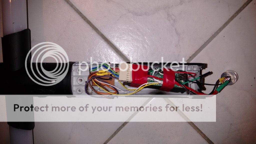

Hello I didn't take much time to answer lately.
I'm currently working on puting every part in  a chassis and things doesn't go smoothly ... I already ruin a DFPlayer mini and the second one I received is faulty out of the box (SPKs pin and GND pin  shorted). And I almost fried the MPU6050 because my cheap solder iron was flatening at the tip (some pin ports did came out. I still was able to salvage it)
I first mounted the mosfets on an alluminium disc, for heat dissipation, but the back panel is linked to the gatepin of the mosfet, so when I fired it the first time, all segment fired at once, and shut at once. So I had to remove them and paste those on new plastic discs.
I also inverted segments 6 and 2 on this build, but this can be corrected in the software. That's the problem when you assemble and disassemble those several time: you augment the mistake risks. I did marked the cables with (not so) permanent markers but the ink still did go away.
So here is the reason why so many Jedi turn to the dark side :
(http://s1073.photobucket.com/user/cest_bastien1/media/Lightsaber/IMG_20160408_125839_zpsamiambos.jpg.html) (http://s1073.photobucket.com/user/cest_bastien1/media/Lightsaber/IMG_20160408_125902_zps4onaqhms.jpg.html)
Please be indulgent, I know this is some ugly job here.This is my very first hilt assembly and I must confess that even if I put time on the design, I didn't thought of everything, so I did some ajustements on the fly resulting on this.
This is definitly a prototype :P
I made the chassis disc by lathing and milling, and made some slight adjustment with a dremel.
I still made those holes for the PCBs to tight. It's quite hard to pass cables. Next time I'll make a little more room. Believe me, PCBs won't go anyway.
The last disc is wearing a 7th mosfet because I wanted to try FoC capabilities. It works but I think I'll won't use it anyway:
Protonerd already warn me on this on several occasions, but since I'm stuborn I wanted to try out. But my FoC ledstring as several issues and I don't have the courage to work on it right now.
The channel you see on the upper part of the disc are made for battery holders. I want to be able to remove those 18650 for charging or replacement.
The pending cables are for switchs, and RGB accent LED, and there's one free (unless I use it for a vibrating motor ;) )
Lights and movements are working but I'm still waiting for a DFPlayer replacement, again...
This chassis have a 32mm diameter (33mm at the aluminium emitter disc, made on purpose)
and about 230mm long.

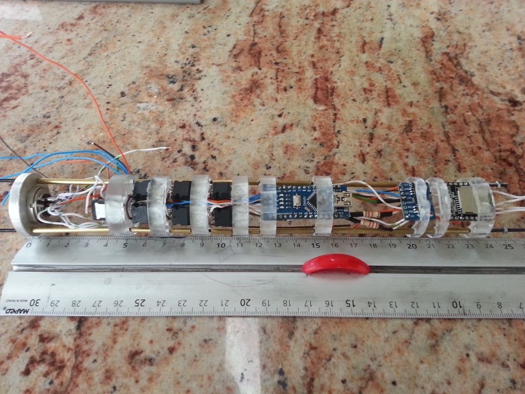

Would you care to share how exactly you make those disks? My biggest pain point is building a chassis still...
You also mentioned you plan to make a 3D chassis, will it be anytime soon? I would be grateful for someone who could make a 3D design I only had to send to a 3D print provider  ::)
I've put some  pictures on photobucket already but I'll made some more especially for the milling part, that I forgot to shoot last time.
For the 3D design, I still plan to do those, but after the one I'm making. They will be used as patrons to make the 3D design.
The tools I'm using right now (lathe and mill) are some old tools and they are really not precise, they do float a bit, and so it's quite hard to obtain something really neat.
However, that's just an aesthetic matter.

I finally managed to put together the ad for the DIYino board.
Next step is to assemble a manual and order the parts for the first run of 20-30 boards.
DIYino announcment (http://forum.arduino.cc/index.php?topic=393174.0)

Post by: neskweek on May 06, 2016, 10:08 pm
@Snyperdead Hello  and welcome.
I didn't reply lately on github because I'm quite busy with the build of my first hilt from scratch: during this time I have no test ready unit, so I can't code/debug correctly.
For the sound the way you did copy it on your card might be to blame. Sound files must be copied in the same exact order they are when you you look at the folder. If they are not it can end up with hasardous behaviour. Look at the readme to see how to do that.
@Everyone
I thought it would end yesterday: I did have all the pieces. I did finally solder the buttons after a final test, and did give the final screwdiver turn. I then remove the kill key and .... nothing :'(.
I did several tests, resolder some connections but nothing did: in the process other connections broke inside the chassis T_T.
I save you all the long process of trial and error and give you my final conclusion :
Disc chassis are CRAP ! :
- whatever the number of soldering you need to do, once the PCBs installed you can't correct/change/fix those
- It's not rigid enough.The problem is the torsion around the axe of the chassis when you try to slide it in your blade's body.
- discs are fragile. Even by taking the best care, I broke two of them. and here comes the headache : if you want to make them tough you need to reduce the PCB holes, but you will struggle to make the cables go through (breaking some connections in the process...).
