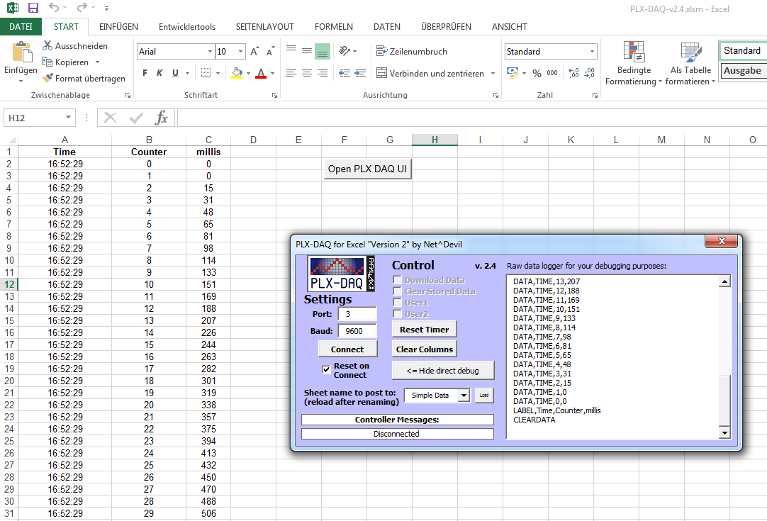

Image-Link: http://www.freebie-base.de/Pics/PLX_DAQ_v2.png (http://www.freebie-base.de/Pics/PLX_DAQ_v2.png) (hosted on my server, no traffic hijack)

Image-Link: http://www.freebie-base.de/Pics/PLX_DAQ_v2.2.png (http://www.freebie-base.de/Pics/PLX_DAQ_v2.2.png)

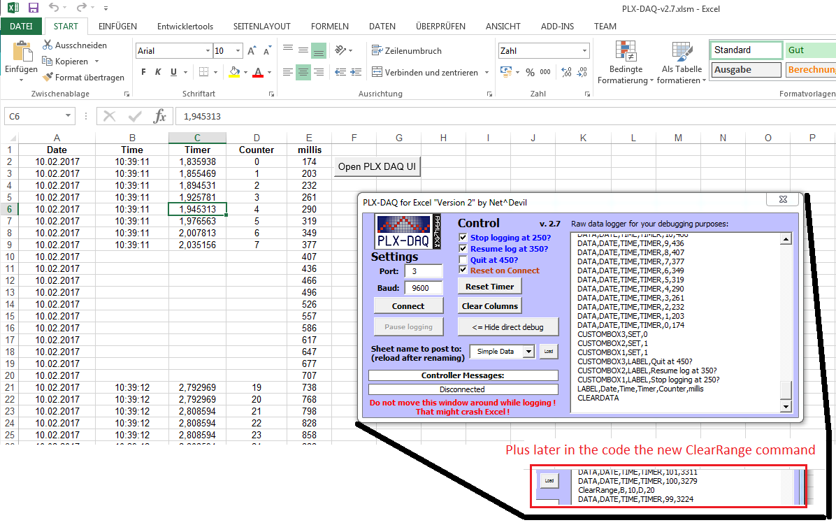

Post by: NetDevil on Dec 08, 2016, 05:11 pm
Ok i guess there is no real use behind your sketch but the image with the colourful arrows are worth it  :D  :D
Anyways, I changed the code to determine the used Office version (special treatment for Office 365) so the UI looks better now. Also a second improvement got implemented: "custom dev points" where one can post his own VBA code to perform any kind of action based on the information passed and can afterwards decide whether he wants the main code to continue or not (e.g. read every line before it gets posted to the sheet, if the line contains a value equal to 200 do not post to sheet).
This version is already outdated !! Link to always most recent version of PLX DAQ v2 here:
==> https://forum.arduino.cc/index.php?topic=437398.msg3013761#msg3013761 (https://forum.arduino.cc/index.php?topic=437398.msg3013761#msg3013761) <==
What's new in "version 2.4" aka Change log:
Image-Link: http://www.freebie-base.de/Pics/PLX_DAQ_v2.4.png (http://www.freebie-base.de/Pics/PLX_DAQ_v2.4.png)

What's new in "version 2.5" aka Change log:

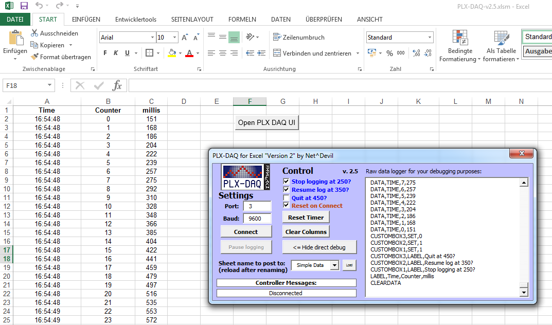

Might be I implemented even further things but I think I lost track of what I did today :D
Image-Link: http://www.freebie-base.de/Pics/PLX_DAQ_v2.5.png (http://www.freebie-base.de/Pics/PLX_DAQ_v2.5.png)

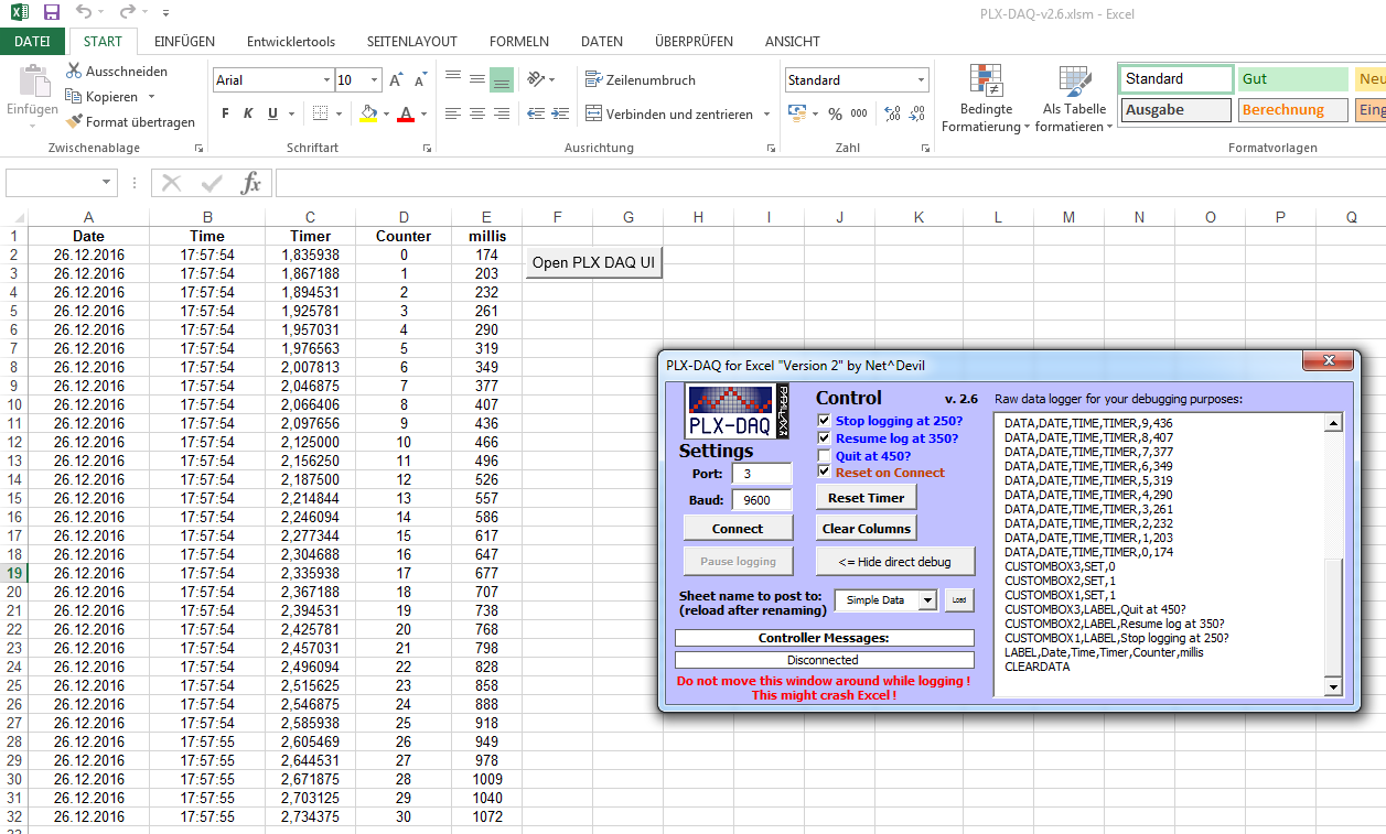

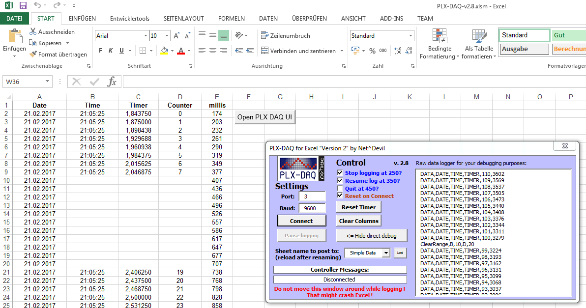

Well I wasn't able to fix the problem with the UI crashing .... It is totally arbitrary and I cannot put my finger on where and what and how crashes the form. It is both when moving the form as well when moving the whole application. Scrolling on the sheet works fine with me but as soon as you do some action that stops the macro from working for a few seconds it crashes some times after. For example when you move the window around you can see the logging to pause in the direct debug window.
So I just added a warning message on the UI :-X
Alongside some other staff:
What's new in "version 2.6" aka Change log:
I also updated the example sketch once more (included stand alone and in the zip file as well).
Image-Link: http://www.freebie-base.de/Pics/PLX_DAQ_v2.6.png (http://www.freebie-base.de/Pics/PLX_DAQ_v2.6.png)

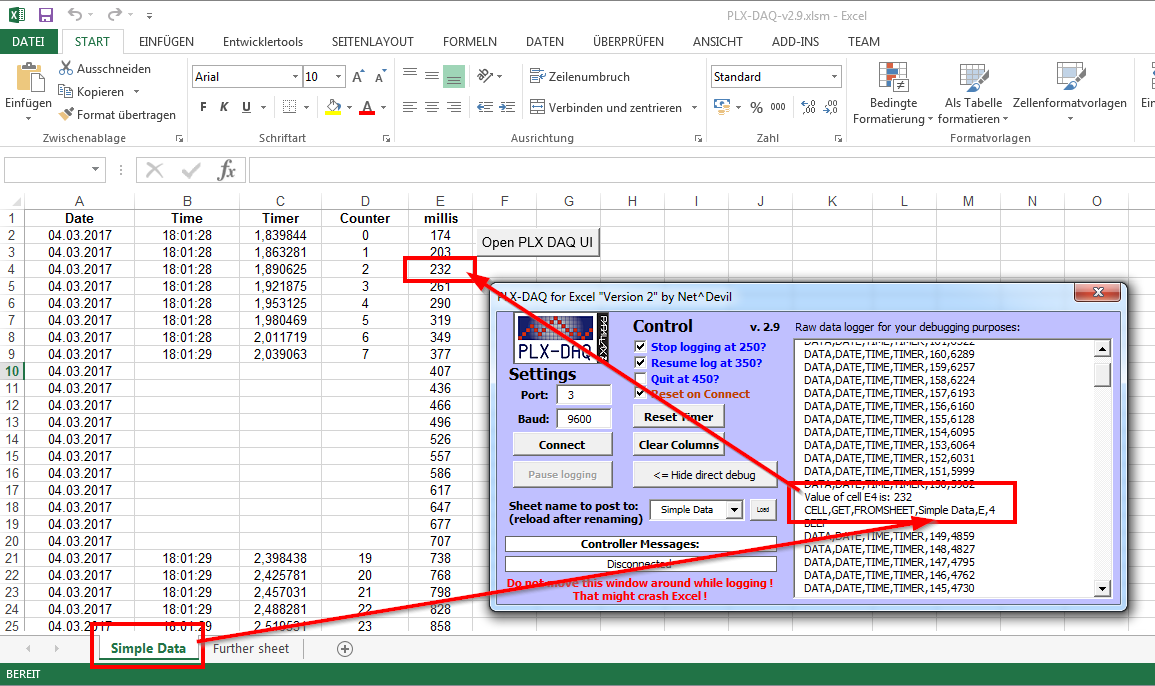

thanks a lot for your feedback :) Good news for you: the function is in fact already present in the program ;)
With the command
Code: [Select]
Serial.println("CELL,GET,D1,");
your Ardunio can ask Excel to send him the values from cell D1 (well in this case). In that cell (and further cells) you could put the variables that you use to operate the frequency range.
Otherwise you could use the custom dev-point "CustomDevPointNewData". There you could easily send your own defined commands from Arduino to Excel and programm in VBA any behaviour you want (e.g. check current time of PC and adjust frequency if time is pre 12:00 am or past 12:00 am. Data can be send to your Arduino from VBA via command
Code: [Select]
CommWrite cboPort.Text, "Any information can be send here"
In case you have any further questions please feel free to ask :-)

The command for ClearRange is already included in v2.7 which I will release in the next post (in a few minutes)
Title: Re: PLX-DAQ version 2 - now with 64 bit support! (and further new features)
Post by: NetDevil on Feb 10, 2017, 10:54 am
As announced here we are (new post for clear hyperlinking):
What's new in "version 2.7" aka Change log:
Backlog for next version(s):
I also updated the example sketch once more with the ClearRange command (included stand alone and in the zip file as well).
Image-Link: http://www.freebie-base.de/Pics/PLX_DAQ_v2.7.png (http://www.freebie-base.de/Pics/PLX_DAQ_v2.7.png)
  • Fixed the reset timer button (there was a useless message box implemented somehow)
  • Formatted the timer to always have 6 trailing digits
  • removed the old fashioned limit to 27 columns - now supports the thousands of columns that Excel supports (although it is getting pretty slow with too many columns)
  • Set the columns all to be aligned centrally on default and column captions to be written in bold by default
  • and well yeah - added the warning remark not to play around too much with the window during logging
  • Added a "Pause logging" / "Resume logging" button that can (well no surprise) stop the logging of the data without disconnecting the Arduino. The Button is enabled when connected
  • Removed the old 4 checkboxes as the functions are useless without Stamp nowadays and replaced with 3 custom checkboxes. As with old PLX DAQ v1 these checkboxes can be controlled by Arduino code: change text, check/uncheck box, read status of boxed (if checked or not). Codes changed from "DOWNLOAD" / "STORED" / "USER1" to CUSTOMBOX1 / CUSTOMBOX2 / CUSTOMBOX3. "USER2" was removed completely.
  • Moved "Reset on Connect" around a bit for better UI layout
  • Re-implemented the code for "Reset Timer" button. I don't know why I removed that anyways in version 2.1 ....
  • I added a new example sketch that demonstrates the new functions and how one can use them
  • I also rework the example codes in the custom dev points for not crashing Excel anymore - hopefully ;)

Updates Updates Updates  :D  :D
What's new in "version 2.8" aka Change log:
Image-Link: http://www.freebie-base.de/Pics/PLX_DAQ_v2.8.png (http://www.freebie-base.de/Pics/PLX_DAQ_v2.8.png)
Quote from: Older changelogs
  • Added a new command: ClearRange that allows for a range to be cleared in the sheet.
    Syntax is Serial.println("ClearRange,StartColumn,StartRow,EndColumn,EndRow"); ==> e.g., Serial.println("ClearRange,B,2,D,50");
  • fixed a bug when closing the form while still logging. The macro was not paused correctly but will do so now

Hey there, I added the command to the programm and did some more research on the issues with the window crash and cell mix up. Unfortunately there is no update on those issues yet. Still pretty mysterious ... Nevertheless I'll reduce the priority as baud rates of around 9600 seem to work without any problems.
What's new in "version 2.9" aka Change log:
Guideline to migrate from old version to new one:
Image-Link: http://www.freebie-base.de/Pics/PLX_DAQ_v2.9.png (http://www.freebie-base.de/Pics/PLX_DAQ_v2.9.png)

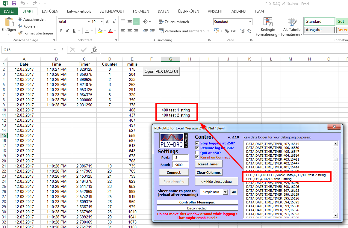

I tried to reproduce your findings but somehow I wasn't successful ... I used one and two flushs before and after each Serial.parseInt(); and also delays before and after Serial.parseInt(); But still I got mix-ups even at 30.000 baud.
Attached you can find a ZIP file which contains a sketch and an Excel sheet. In this Excel sheet there are 4 test case scenarios and the sketch will cover those scenarios. In the sketch you can set whether you want to use one or two flushs before or after Serial.parseInt(); as well as if you want to use a delay before and after Serial.parseInt(); and which amount if milliseconds it should wait.
May I ask you to try to verify your experiences with it? In the end, only 100% accuracy is acceptable. That's why I appreciate you running like 20 tries of the same text case and get 18 of 20 or so. This shows that there is no 100% accuracy yet and I have to work on improving the program.
As I am a bit short on time lately I will have to cover all the other open issues some time soon.
Greetings
  • Extended the CELL,GET command to read cells from other sheets as well.
    Syntax is Serial.println("CELL,GET,FROMSHEET,SheetName,Column,Row"); ==> e.g., Serial.println("CELL,GET,FROMSHEET,Simple Data,E,4");
  • Updated the default sketch to include the new command

Hi SASv,
thanks once more for the intensive testing you have done :) I implemented your suggestion into the cellvalue manipulator (500ms delay for every GET and SET) and it did indeed do the trick for higher baud rates (I had some successful test runs with 60.000 baud :) ).
I am still kind of clueless why it is working this way though. Having a delay before GET/SET shouldn't hamper the read later on .... I mean, why pause, then send a GET, then read directly and it is ok? I would understand if we need a delay between the GET and the read to get the buffer free. Or use a flush on Arduino side or Excel side before the read / send ... crazy ....
Its sad to see such large delays are needed since they really slow down the overall performance. However using "only" standard DATA,Value1,Value2,Value3 commands never produced any issues even at highest baud rates so far and I guess thats the most important part.
I will add a note to my Beginners Guide to be careful with CELL,GET and CELL,SET and using at least some delays prio to it (between 100 ms and 500 ms) thus everyone should at least be aware of the issue. I need to update that guide anyways to format chapter headings and include a table of contents.
That adding up of needed delays based on the number of prio GETs/SETs is crazy and confusing as well. One could write a bachelor thesis I guess in order to figure out what the exact needed value for your final GET/SET must be based on how many prior GETs/SETs were used with which delay :D
You definitely earned yourself some Karma points (at least that is all I can offer right now over the internet :) )
I might try some times querying the checkbox values to see if it is the same behavior (well I guess it will be).

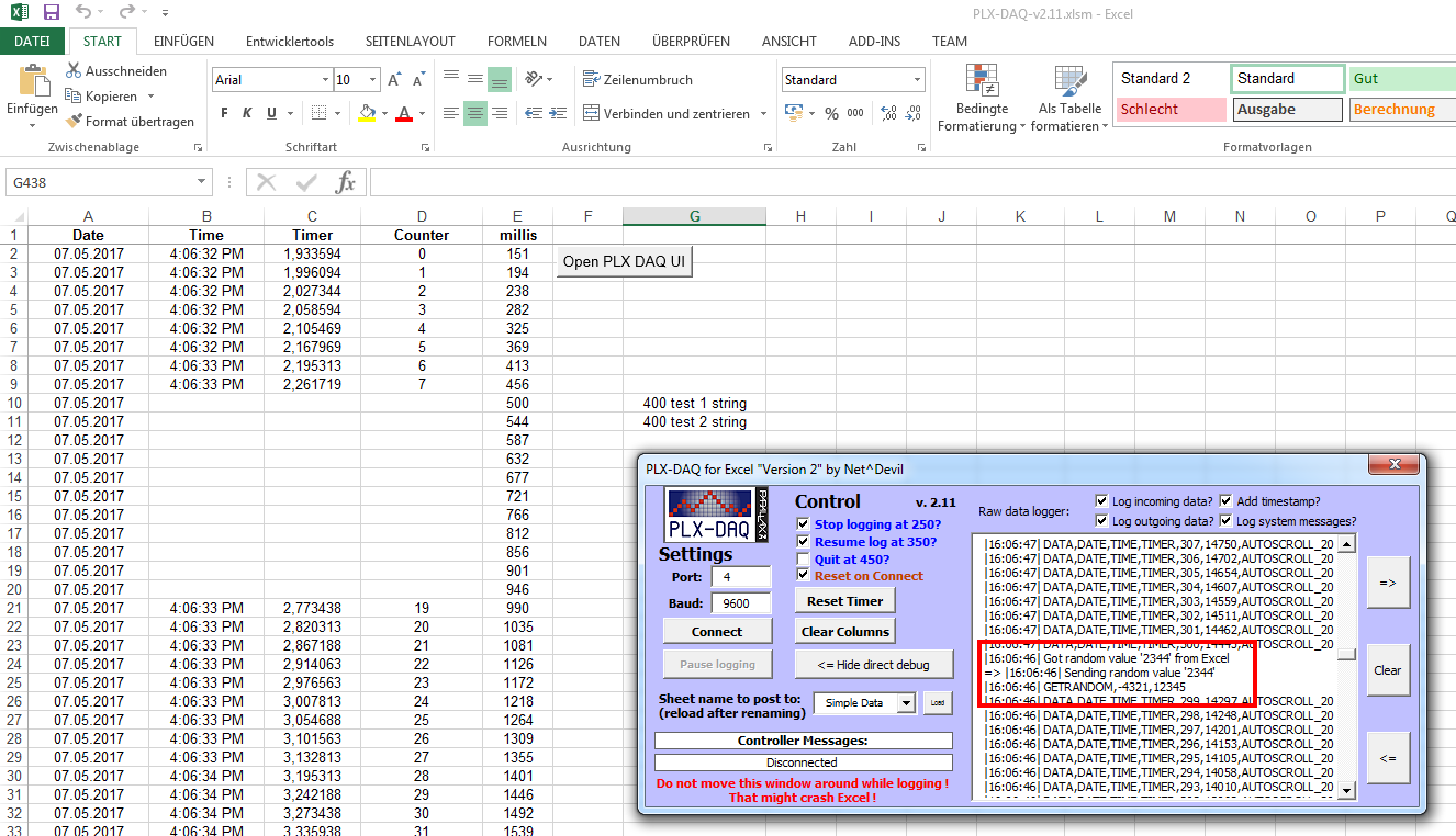

Hey guys. Well it's been a while - nearly 2 months! But there is a new version available now! I did some groundwork and tried to tidy up a lot of code but in the end I'm just half done ... that's why I thought I might release the updates I already have and keep the rest for later ;-) And well there are quite a few new features!
What's new in "Version 2.11" aka Change log:
Guideline to migrate from old version to new one ==> see Beginners Guide attached
Image-Link: http://www.freebie-base.de/Pics/PLX_DAQ_v2.11.png (http://www.freebie-base.de/Pics/PLX_DAQ_v2.11.png)
Changelogs of older versions can be found in the attached document "__Old-Versions-changelog.doc"
  • Extended DATA command by the parameter AUTOSCROLL_XY. Autoscroll will automatically scroll your Excel sheet along with each new row of data which is read and posted. XY can be replaced by any number (e.g., 20) to control how many additional lines should be shown above as well during scrolling.
  • Added a new function: GetRandom(min,max). It basically just returns a random number between min and max. Very useful if you need a random number for Arduino's randomSeed() to be initialized
  • Added several features to the direct debug window. The size can now be increased or decreased (to a certain extend), content can be cleared and you can decide what you want to log: incoming data, outgoing data, system data. Also a time stamp can be added if wanted.
  • Added a default line break after all data send to the Arduino. Thus no more delays are necessary before or after get/set calls. In order to read incoming data one should use either Serial.readStringUntil(10); or Serial.readStringUntil(10).toInt(); or Serial.readStringUntil(10).toFloat(); from now on
  • Optimized the way Excel processes multiple incoming lines of data for better performance
  • There are some new parameters which can be changed on the (hidden) settings sheet in Excel. Those "Expert Configs" should be handled with care. They are about the buffer sizes for your COM port. In case you decide to spam massive amount of data to Excel and increase the baud rate you might experience data loss. Try increasing the buffer sizes then.
  • Added a "PowerDemos" directory with some nice (at least I think so) demos. First demo is a moving self updating graph visualizing data from the Arduino.
  • Updated the Beginners Guide to reflect all new commands - and optimized the formatting as well
  • Updated the default sketch to include the new commands

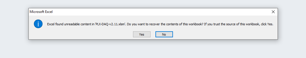

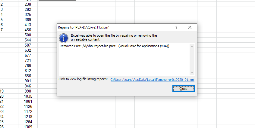

Post by: Alejandro561 on Jul 11, 2017, 08:49 pm
Hi, I have a problem with the v2.11, I have Windows 10, Excel 2016, when I clic Connect, after a while Excel stops and close.

Post by: NetDevil on Jul 12, 2017, 06:41 am
Hi Alejandro,
could you give me a bit more detail? Are you already sending data from your Arduino to PLX DAQ? Is incoming data shown in the DirectDebug window? Is data being posted to Excel sheet already? And (maybe most important) what baud rate are you using?

Serial.println((String) "CLEARRANGE,A,2,D," + yourRowCounter);In case you don't know how many rows you pasted to the sheet ... well ... just delete 100.000 - that should be enough :D
Code: [Select]
Serial.println((String) "CLEARRANGE,A,2,D,100000");
I hope this works for you !?

Post by: jarus on Apr 16, 2018, 10:40 pm
Excel seems to keep crashing on me. Is it bc of my sample rate? CPU usage goes up to 60% while the app is running but doesn't seem to be draining resources completely. It collects data for about 400 rows and then crashes. I tried baud rate 9600 and 115200. It seems to be more stable if I increase the delay to 100ms (sampling rate of 10Hz) But realistically I need to sample at least 50Hz.
I am using an Arduino Uno, ADXL335, Windows 10 (also tried on windows 7), both 64-bit, tried with Excel 2016 and 2013. Developer mode was activated and macros were allowed to run.
I've spent all day trying to get this to work and I'm starting to get frustrated and I don't know how to fix this. Any help would be much appreciated! Thanks
Post by: Schildkroete1 on Jun 04, 2018, 03:15 pm
I use it on Win 10 Pro 64 bit with office 365 (2016) and it works perfect-
Post by: NetDevil on Jun 05, 2018, 08:06 pm
Hi guys,
first of all sorry for not replying to any message so far - I didn't get a single mail notification and thought PLX DAQ is just running fine and smooth :-)
I'll recheck the thread more frequently from now on.
Hi Jarus,
sadly that is a commonly known issue I hope I'll find the time to work on any time soon. For now however the only know workaround is to try to minimize load on the communication by adding delays (~50ms) and running on low baud rates (around 9600). That way most of the tests were running stable. Not using autoscroll might help (not sure). Also don't use Excel while communication is ongoing. Like don't click into cells, don't move the Excel window around, don't move PLX DAQ window around. Doing any of that kind of "locks" Excel for the time being and can heavily mess with the input buffer and cause problems.
If you need anything more just let me know.
Greetings
Jonathan
