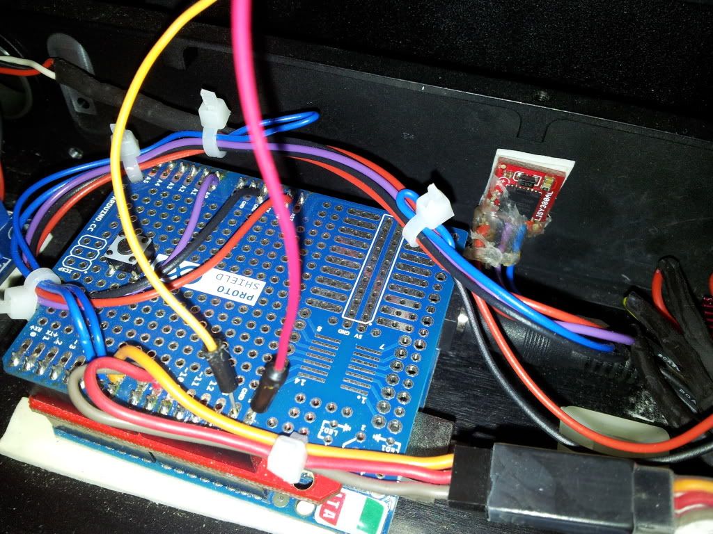

I am getting data now! I took the razor off of the proto-shield I was using and just set it up on a breadboard. Except now my graph looks very erratic. It will react to movement but it will not react as predictably as the graph appears to in the video. Any advice?

Title: Re: Guide to gyro and accelerometer with Arduino including Kalman filtering
Post by: danpe on Nov 08, 2011, 11:42 am
Hey, thanks alot for you replays i learn alot of new stuff and you are being very helpfull :)
So in my Gyro i have VCC & GND pin, i connected the VCC to the Arduino 3.3v pin and the GND to one of the GND pins on the Arduino.
And i connected the OUT pin of the gyro to the Analog0 pin on the Arduino.
I use this external Power Supply
As you can see i'm giving 12v to the Arduino, and the Fixed volts are set to 3.3v and connected stright to the AREF pin and one of the GND pins on the arduino.
Now i changed my sensitivity back to 1.023, and added
Code: [Select]
analogReference(EXTERNAL); to the
Code: [Select]
setup() in my code.
You can see the purple black and red goes to the gyro, the big connector that connected to the 7,8,9 digitals is a Servo controller, and the  2 pins from the external supply to the AREF & GND.
Here is the code, every one milliseconds i call this:
Code: [Select]
void gyroTest()
   if(gyroInit) {
     finalGyroAngle = calculateGyroAngle(0);
     Serial.println(finalGyroAngle);
Code: [Select]
float calculateGyroAngle(int pin)
   gyroAdc = calibrateGyro(0);
   if(abs(gyroAdc - gyroZero) <= Threshold)
     gyroAdc = gyroZero;
   gyroRate = (gyroAdc-gyroZero)/sensitivity;
   gyroRotation+=gyroRate*dtime/1000;
   unsigned long t = millis();
   dtime = t - stime;
   stime = t;
   return gyroRotation;
void InitGyro(int pin)
 Serial.println("Calibrating Gyro...");
 sensitivity = 1.023; //0.692454545; //0.716454545;
 gyroAdc = 0;
 gyroRate = 0;
 gyroRotation = 0;
 gyroAngle = 0;
 gyroZero = calibrateGyro(pin);
 Serial.print("Gyro Calibrated: ");
 Serial.println(gyroZero);
int calibrateGyro(int pin)
 long resultGyro = 0;
 for(int i=0;i<100;i++)
   resultGyro += analogRead(pin);
   delay(0.5);
 resultGyro = resultGyro/100;
 return resultGyro;
Am i doing everything ok ?

Post by: danpe on Nov 08, 2011, 05:22 pm
Hey, i still didn't solve it :P
I'll explain why the setup for and what is my problem.
As you see i have a WiFi shield connected, i send him commands to spin the servo that is connected to a arm that the gyro is on so the gyro spins with it.
I want to tell the servo to spin 90 degrees, and then go back to 0 degrees, and do that in a loop.
That's why i need the Gyro for, to get the degrees.
My problem is that after 2-3 time it goes to 90 then 0 the drifting goes crazy and it goes to 110 then -20...
So my problam still isn't solved.
I posted all my setup so you can see if i'm doing everything right, i hope you can help me figure it out.

Post by: Lauszus on Nov 08, 2011, 09:26 pm
Sorry, I didn't see the last line in your post :)
Hmm, it seams like you do everything correct.
But hey, why do you need a gyro to tell the degrees? You don't need that for a servo. Just send it the correct pulse, and it will go to the requested position!!
See this page for more information: http://www.arduino.cc/en/Reference/Servo

This is great!  I'm building a self-balancing robot using the Arduino Uno, the Sparkfun IMU Digital Combo Board - 6 Degrees of Freedom ITG3200/ADXL345 (http://www.sparkfun.com/products/10121 (http://www.sparkfun.com/products/10121), and the Nubotics WW-12 - WheelWatcher Optical Encoder (http://www.nubotics.com/products/ww12/index.html (http://www.nubotics.com/products/ww12/index.html)).
I've had trouble finding any code examples for the wheel encoder.
I'll let you know how it goes.

Post by: Lauszus on Apr 26, 2012, 10:16 pm
@ dhbromley
Take a look at how I implemented my encoders:
https://github.com/TKJElectronics/BalancingRobotArduino
Regards
Lauszus
