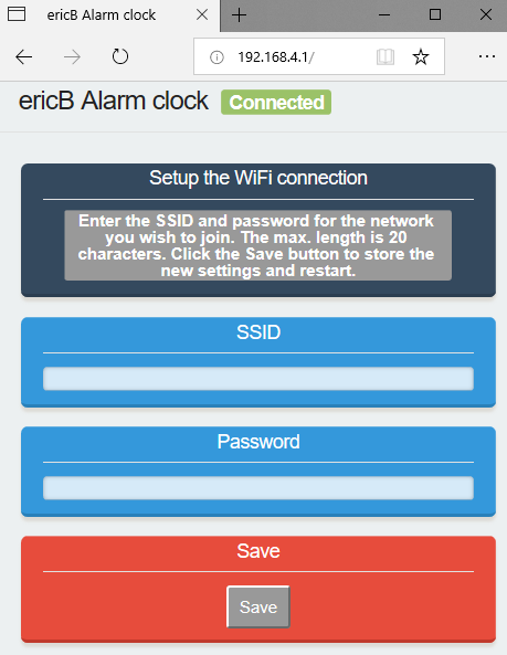

It took some time but I just finished adding a web interface for setting up the WiFi credentials (so no need for hard coding them):
It is pretty easy to add this WiFi setup to other projects as well, maybe I'll create a library for it.

Post by: zoomx on May 21, 2019, 09:58 pm
There is already a library for this: WiFiManager!
Anyway well done!
Title: Re: Wemos D1 WiFi alarm clock - work in progress
Post by: ericBcreator on May 21, 2019, 10:16 pm
Anyway well done!
Yeah, I tried it and it works fine...but not with the ESPUI library, it was either one or the other.
Now I have both :-)
